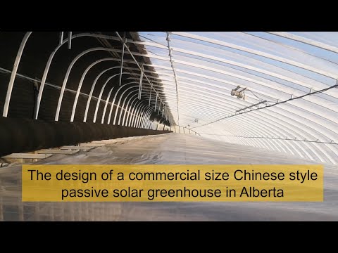

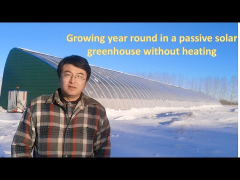

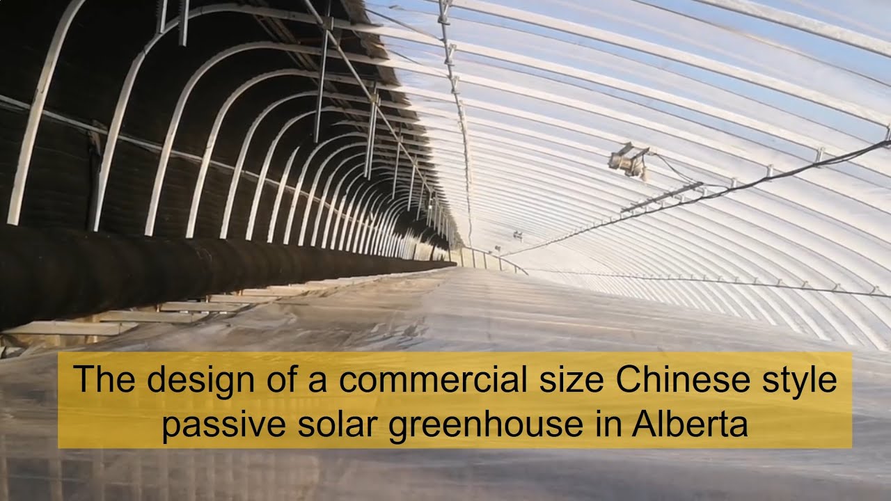

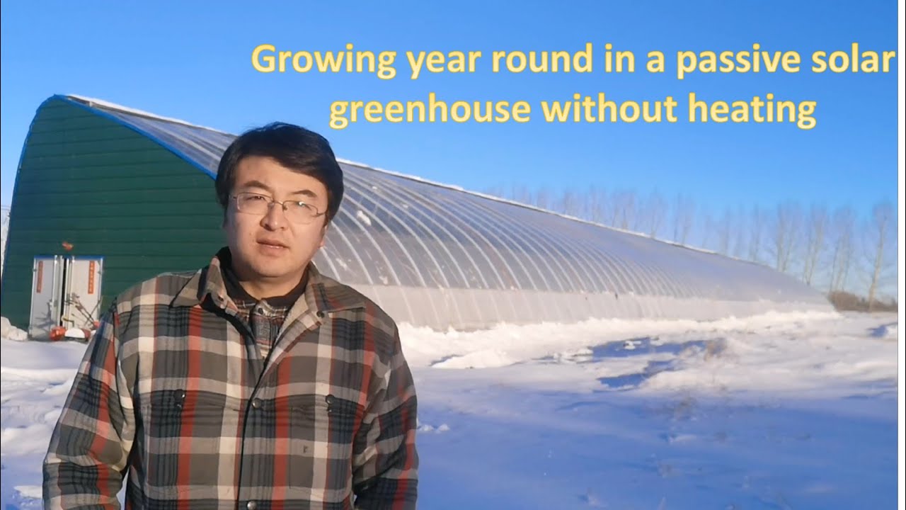

Al, check out my greenhouse topic. If you gou a south faceing slope and good ground to work with its a good design. If not, this guy has a incredible greenhouse
Follow up video show the structure thermal-dynamic design details.
Show this is all off grid. With engine generator for mechanical systems powering at 4:42
Good find KristijanL.
I like that it is all above ground grade.
Here PNW wetside it is bad-bad to go underground. Energy kill your self de-humidifing for a wet-wet 50F.
