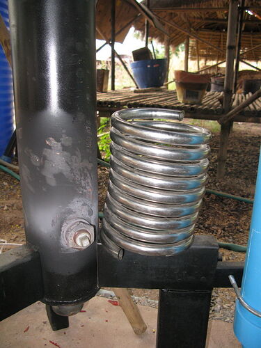

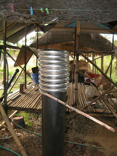

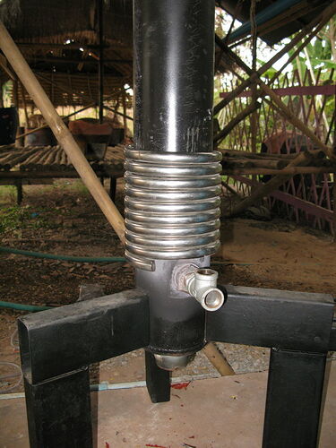

New gismo added after the test ride, a stainless coil on the outside on the reactor, to drip in water and…
should be up and running before the exhibition
Very tight fit, had to counter force it to open it width enough to fit on the outside of the reactor.
water dripping + exhaust gasses will be “super” heated before they enter the reactor.. ( i hope )
