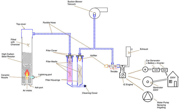

This is the sketch from the gasifier as is now, ready to be presented the 18Th

This setup was made with 5" pipe, which i had on hands. Does perform quit well i may say.
When running good, reactor temperature is about 400ºC (can see in the videos)
Top of the gasifier runs at around 40ºC
The charcoal level should be kept 25" above the hot zone to keep the temp low .
