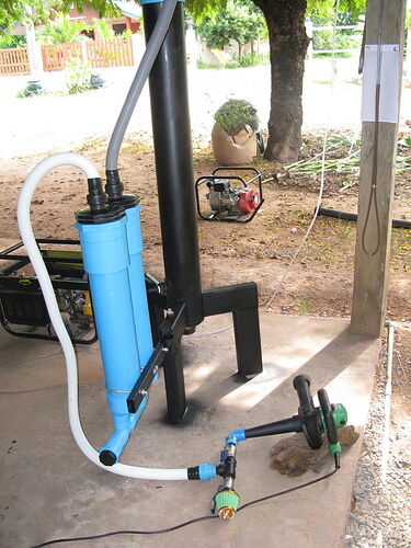

Doing calibrating the nozzle-filters-carb settings with an home made vacuum set
vacuum to adjust at the level near the nozzle, inside the reactor.
Here using the lighnting port

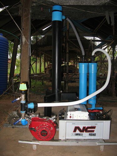

Using this home made home set…
Here is the gasifier driving a Honda GX200 with a car generator and 1Kw Continuos converter on top of an 160 Amps deep cycle battery.
Coming home at evening, start the gasifier, boil the water, charge the battery, cook your meal… take a long hot shower…
Using Green Waste Charcoal for 3 hours…
Running your fridge all day, use your lightning all day…
1 Kg charcoal produces almost 8 Kwh useable energy…
Using the exhaust gasses to obtain more energy from your charcoal.
Saving the world from the Carbon dioxide problems never was more easy…
Use it as a charger for the battery from an electric car… ? put it in the back of an electric car ?
Hybrid cars do the same don’t they ?
Steve… more idea’s please… gasifier-wood-electric cars…
KVL, I am charging my Electric car (Nissan Leaf, 24Kwh battery) with some of the power from my solar panel array, indirectly, as I have the panels tied into the power grid. Looking at my power use to charge at 4 A.M., I needed 6 Kwh to charge on Nov. 14, and 10.1 Kwh to charge on Nov. 9. It usually charges in 2 to 2 1/2 hours from a 220 volt 15 amp plug. (The car travels 5.1 miles on 1 Kwh.) Range is 73 miles at normal speeds, 90 miles at careful speeds. The deep cycle battery you have is rated at 160 AH? The car’s onboard charger checks for frequency and proper grounding. The Honda inverter type chargers require a bond between neutral and ground which is accomplished with some 100K ohm 2 watt resistors done in the power plug of the generator. The manual warns about spikes on square wave inverters that might damage the very expensive Nissan onboard charger for the Lithium Ion batteries. Solar panels are like a water leak. A little bit over a long time adds up, but only when the sun shines. Charcoal doesn’t care what time it is…
Exactly what i meant Ray, and what about the Hybrid cars ? some have an gasoline generator, just for charging the battery…
At the picture is shown a modified sine wave inverter (200$) in my home i use an true sine wave (2000$)
the inverter on the picture works very well with brushed tools and heavy equipment, gets a little noise when i am using it with induction motors.
But i gives a nice picture
Anyhow… a woodgassed electric car
no need for constant adjustments… even a micro turbine would do wonderful
What you think ? retrofitting yours with a gasifier instead of a battery ?
