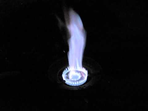

Some blue still’s…
The red shine comes every time after a throttle down and up again…
if runs on constant high flow it runs nice pale blue…

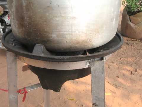

start up for the cooker

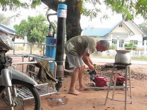

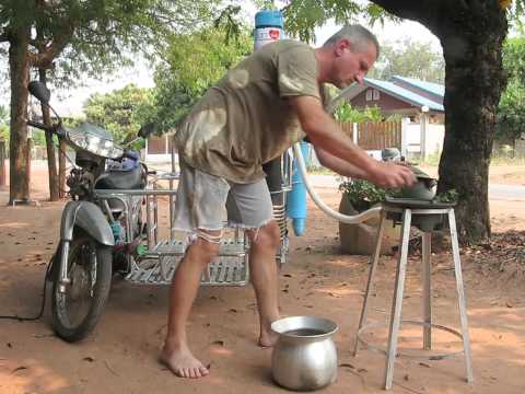

Switching between cooker and pump
Water is boiling

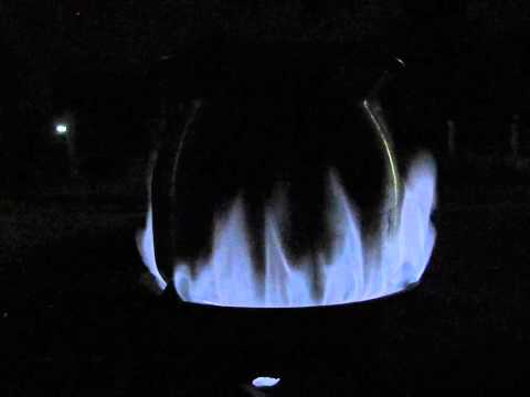

Blue flame cooking in the night
Blue flame under the cooking pot

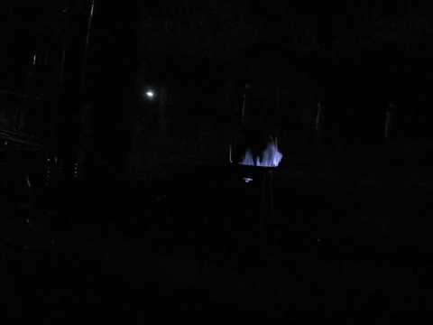

Cooking pot in the dark
