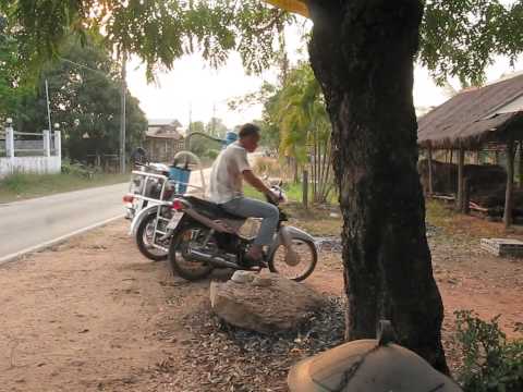

Cooking, driving the motorbike, pumping water for irrigation, charging the battery’s, generating electric power… showed by the R&D Team from Dan Si Suk…

That is perfect combination for all those road side food vendors that are all over Thailand that make such great food. Bike with a side car and a gas burner!
Thanks Patrick
Patrick,
thats a good public to target…
i will start learning how to cook and use the set as a demonstration cook mobile
