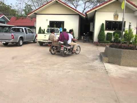

Hi Gary L,
It works…
The administration of Dan Si Suk enjoying the ride with the Green waste Charcoal driven bike…
ทดสอบขับมอเตอร์ไซค์ที่พลังงานทดแทน ณ อบต.ด่านศรีสุข อ.โพธ์ตาก จ.หนองคาย …สุดยอดดดด…

She’s an oldie… but she drives so smooth…
Today tested her without water… it runs but it misses the throttle response a lot
with sufficient water its almost not noticeable the difference between gasoline and charcoal gas…
People start asking for driving her…
