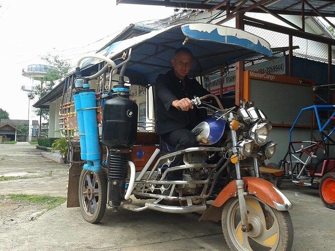

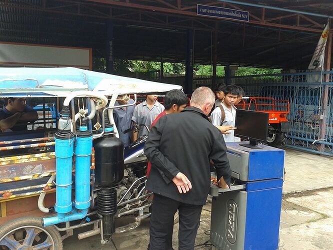

Setting up a testing program for detailed feedback to use in an automated system.

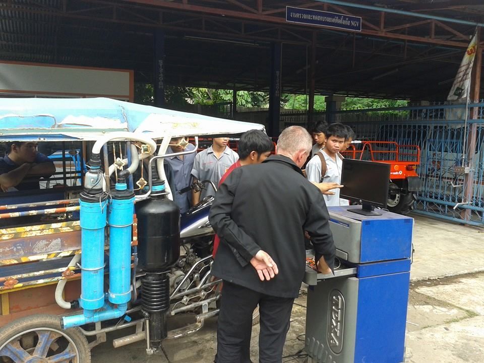

Students and teachers from the technical college, eager to get a turn to drive the trike.
Also working on an easy modification system for port-inlet, valve lifting and cam timing.
Figuring out the ignition system and possible mods…
( low rpm and high torque wanted )

Its a satisfaction to build, to make others build and to see it running…
Beside just being a show of, i want to make others see what can be done with gasification… and make them willing to build themselves
It works, its easy and it makes you smile with every mile…

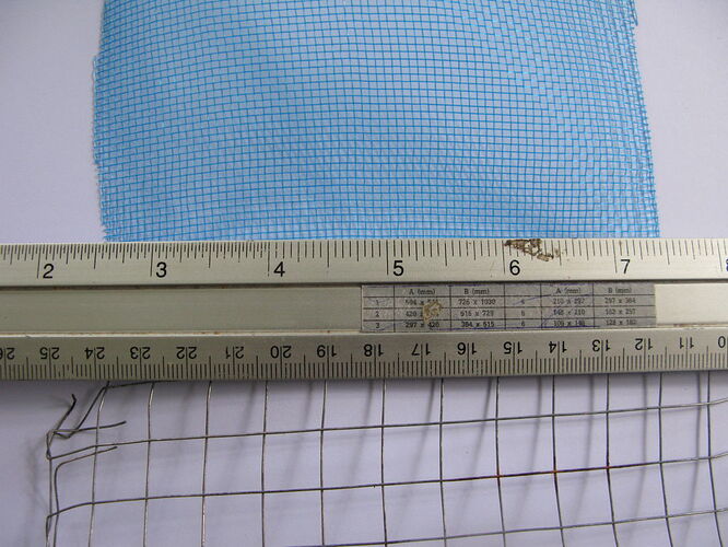

This is a picture of the 2 screen sizes i use.
Anything bigger then the 1/2" will get made smaller.
Anything smaller then the blue screen (1/16") will not be used.
It happens to work perfect in my setups, so i share with you guy’s
( i spare you details of my failures )

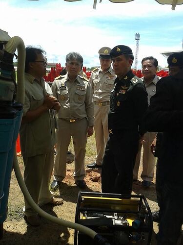

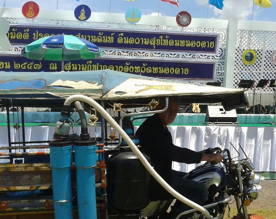

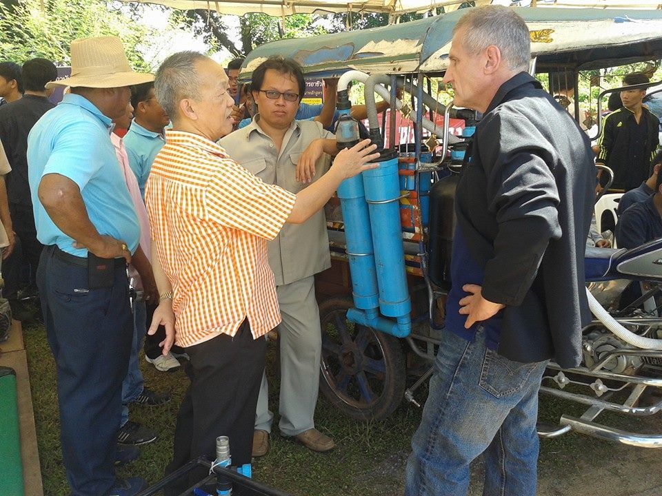

Today presented the Thai Gasifier and the Carbon Dioxide converter at the military exposition in Nong Khai Thailand.
A soccer stadion full of brass and tens of thousands people…
waiting for the Governor and the high rank brass appeared and torch the gasifier.
An invisible flame after only 10 seconds after startup, everybody had to feel the heat before believing there was fire…
slowly building a future for real green energy…

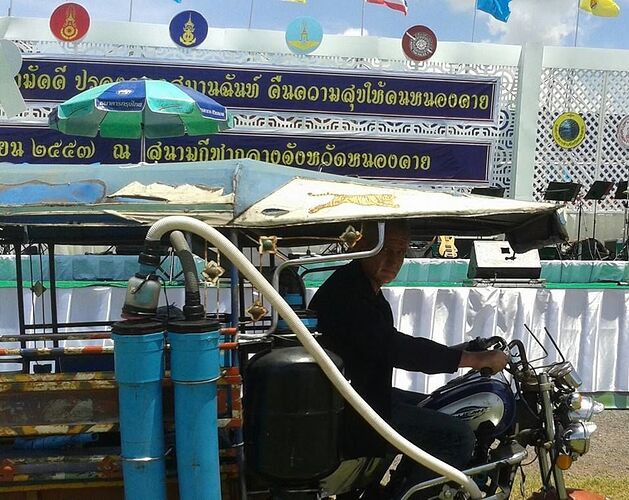

I could not resist to make a “drive by” ![]()
Looking good Koen !
Thanks for the pictures .

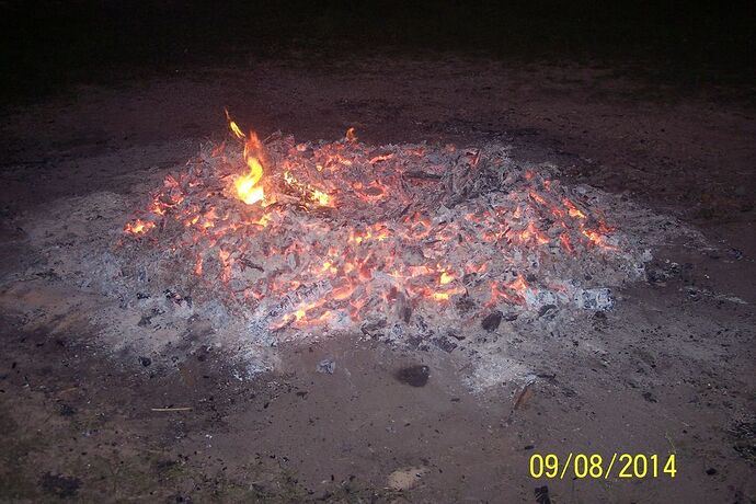

Boy does this make me feel bad. Here is a picture of the charcoal I made tonight while burning down part of my old barn. I have no use for it right now and I have 3 barrels full already I had to let this much go to ash a couple of nights ago. The only thing I can think of to do is spread the char that I have in barrels on some plastic or something on my quonset floor to free up the barrels for a refill. Will the char absorb moisture or will it keep?TomC
No need to burn the charcoal, trow it on a pile in your garden anywhere, its a great detox.
after the raining saison you can sun dry them and use them as normal.

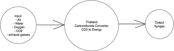

We proudly announce the existence of an Carbon Dioxide to renewable energy converter…
https://drive.google.com/file/d/0B4CL3bqit0osZVM1QVpCYUF6dEE/edit?usp=sharing
Also… the announcement of granting the rights of the invention for North and South America towards Troy Martz.
Special thanks to those who did teach us not to give up and to the supporters on DOW, with the special mentioning of Gary Gilmore and Wayne Keith.
The full disclosure of details will be simultaneous with the publication from the patent ( now pending).
Never give up, never stop learning…
take the correct amount C + the correct amount O2 + the correct amount Co2 and get 2 Co
keyword = balancing
