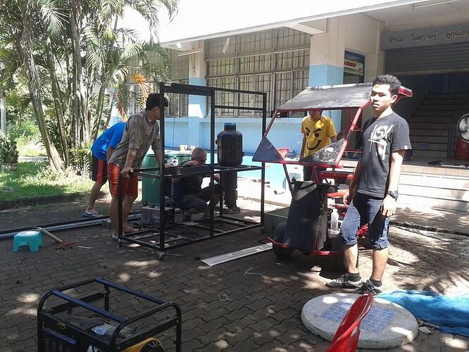

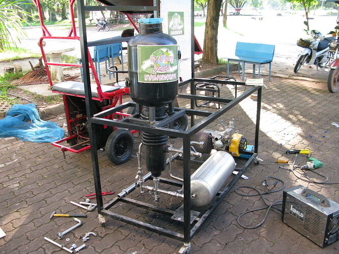

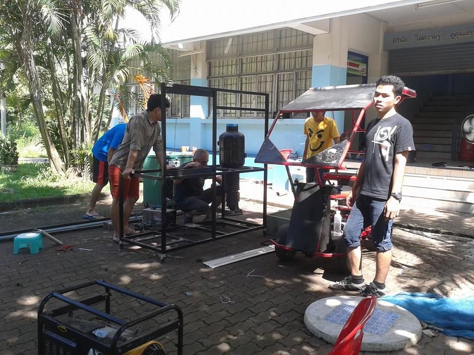

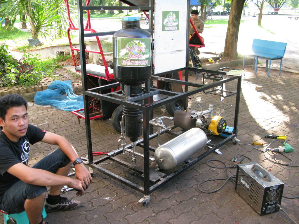

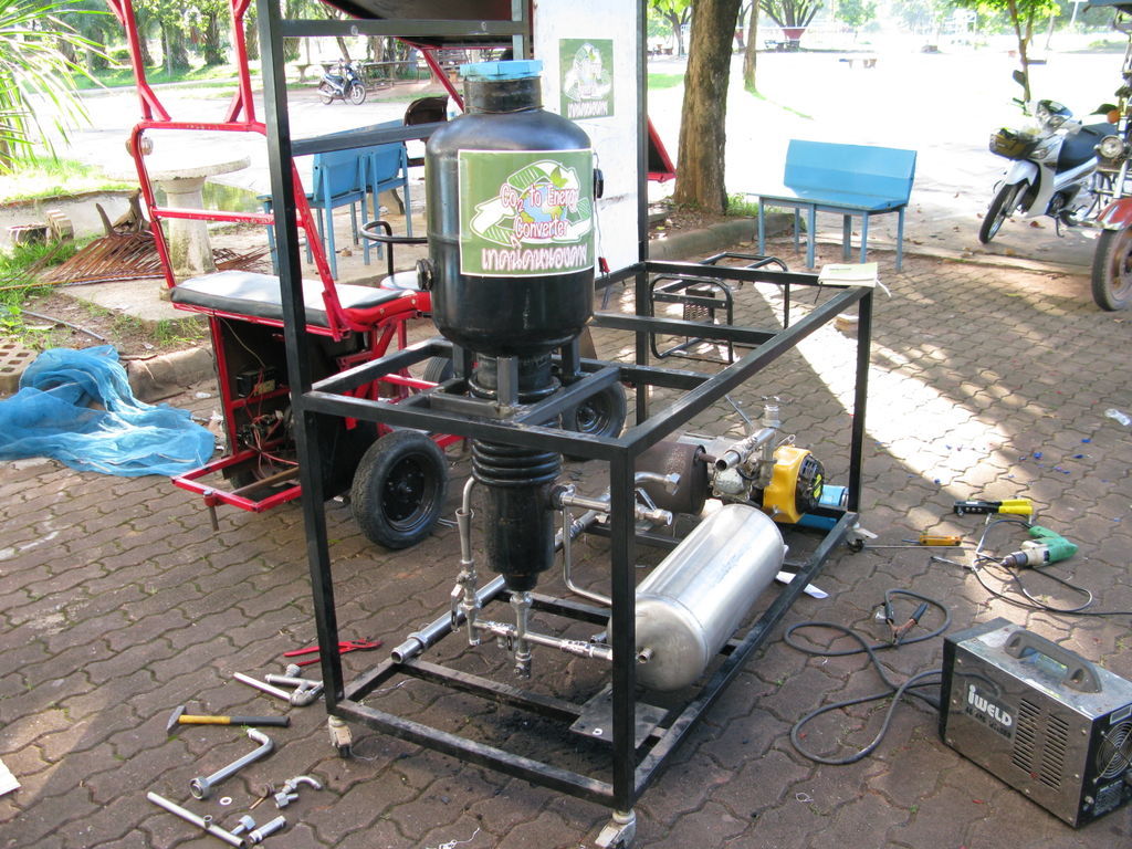

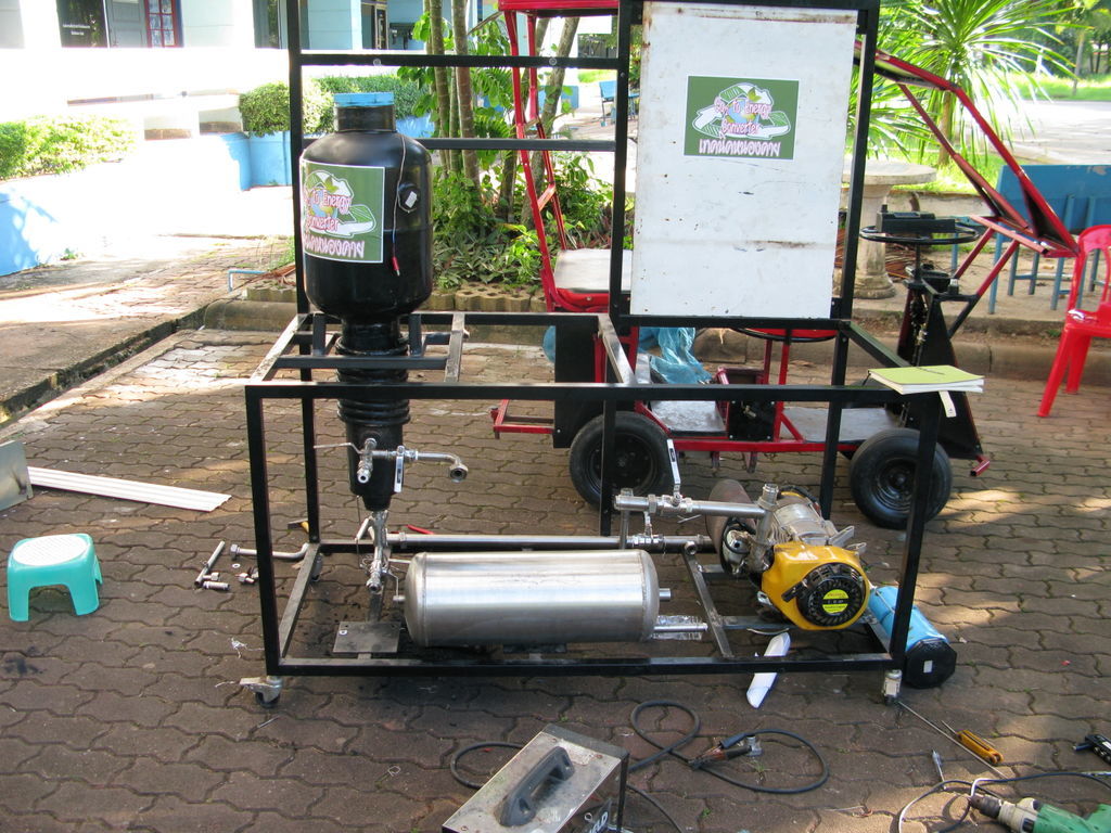

The Co2 Converter build is getting shape
Installing 2 Kw gen set and a lot of tubing…

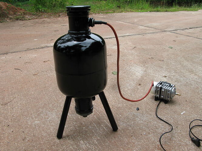

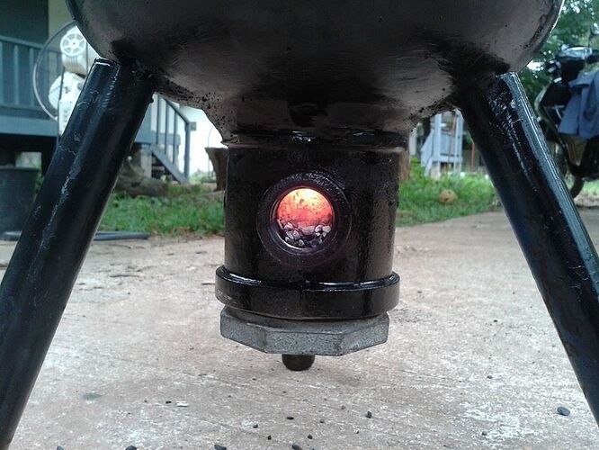

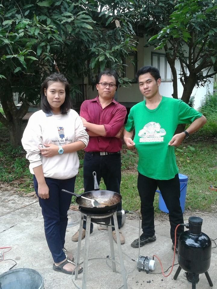

Today in color, ready for its first burn in…
The “baby” green waste charcoal gasifier.
For very small engines and for cooking.
approx 50 liter gas per minute…

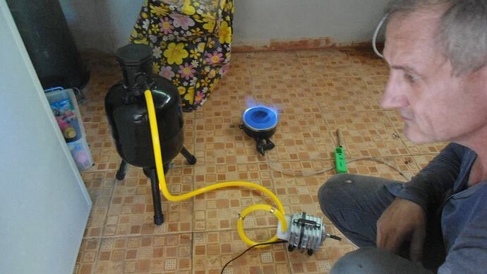

what kind of fan and burner do you use for cooking?
The airpump is shown on the picture = an pump for aquarium, tuned a bit.
second picture is a charcoal shaker on solar power , a student build it.
me looking sweaty and charcoaled…
student with his “Co2 to energy converter” T-shirt

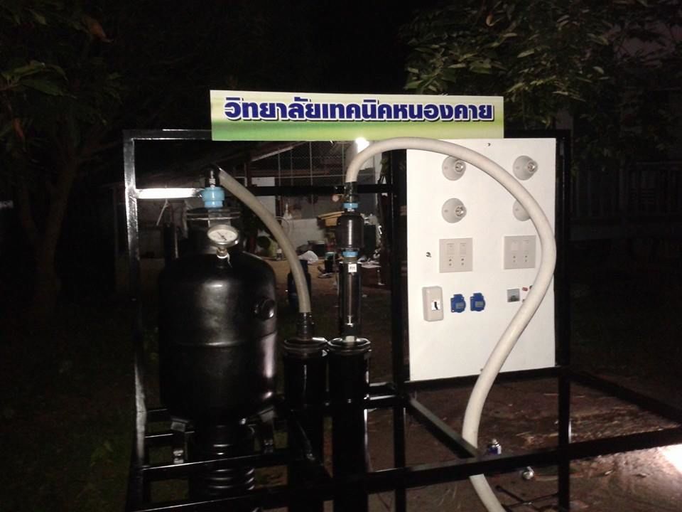

Tomorrow the director of the energy department is comming to pick up his Gismo to show it in Bangkok.
Same time he already foreseen a budget to make a large build, 250 Kwh charcoal to electric plant…

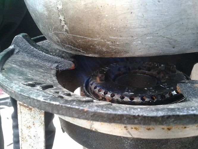

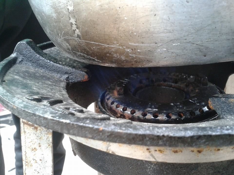

the little one barking out its flames

The air-pump is “China quality” and needs improvement or replacement.
The little one is build on request, a bit smaller then i would like it to have build, but it became nice.
Crazy enough it run’s and “bark out” its flames…
