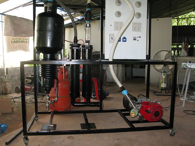

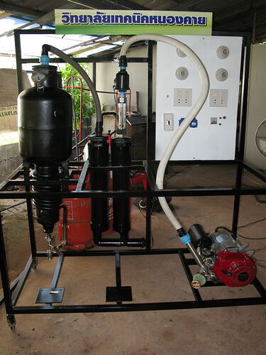

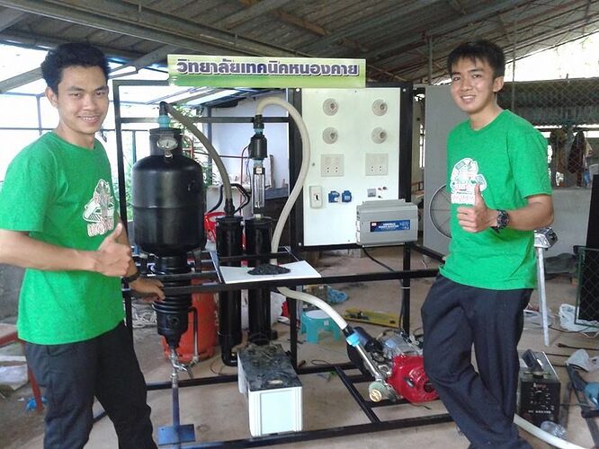

At the foreground a sneak pre-view of the teaching module…
this one shows a bit more ( nice ) of the testing-learning-exhibition unit
all manual actuated valves and indicators
(most people are still “analog” perceiving)

What size engine is that, and what kind of run time will you get.
Engine is Honda GX200 (200 cc)
generator rated at 2,5 kwh
runtime about 5 hours
this set is meant for teaching and demonstrations

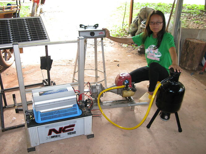

The “little boy” in a small “home set”

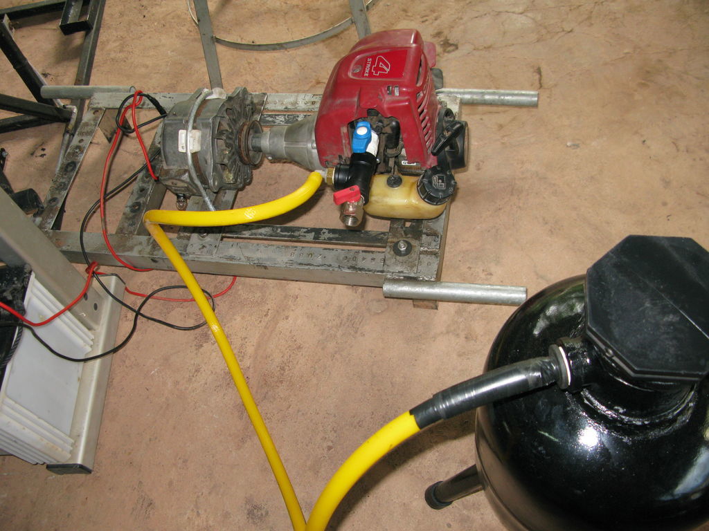

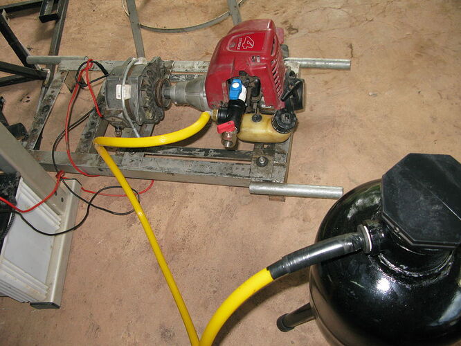

The Green waste Thai Gasifier feeds either the cooking unit or charges the 12V battery-inverter set, the small solar panel, keeps the battery alive when no electricity is needed.

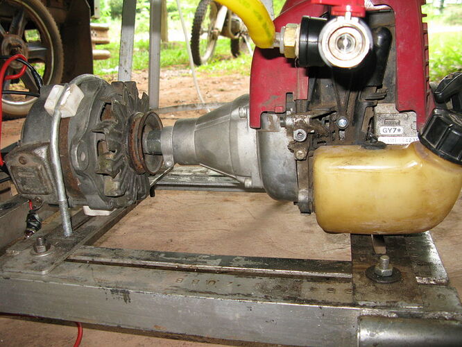

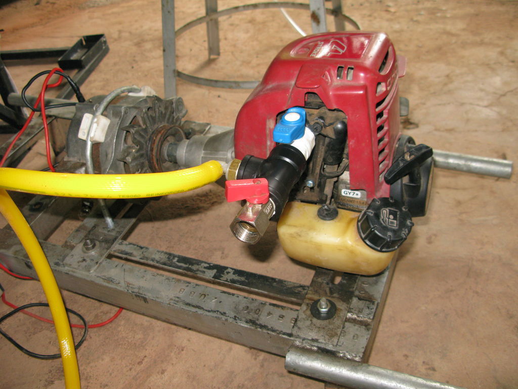

The Engine, Honda GX37, from a weed-wacker drives a car generator with an output of 30 Amps
A perfect solution for small house needs.

Same comments and kudos as those already posted. Additionally I would like to know exactly what you are using as a “transmission” between motor and generator. I see the final drive is a hexagonal socket that fits onto the generator pulley bolt, I assume.
Thanks, Pepe
You’r correct, Its an hexagonal “pipe wrench” , slipping over the pulley bolt , with in the axial length , central in the pipe wrench, the connection rod into the honda fly-wheel clutch, keeping both parts as original as possible.
I use the gas -tank from the engine as Cussion, ( suspended in rubber ) and bolted that to the bottom frame…
