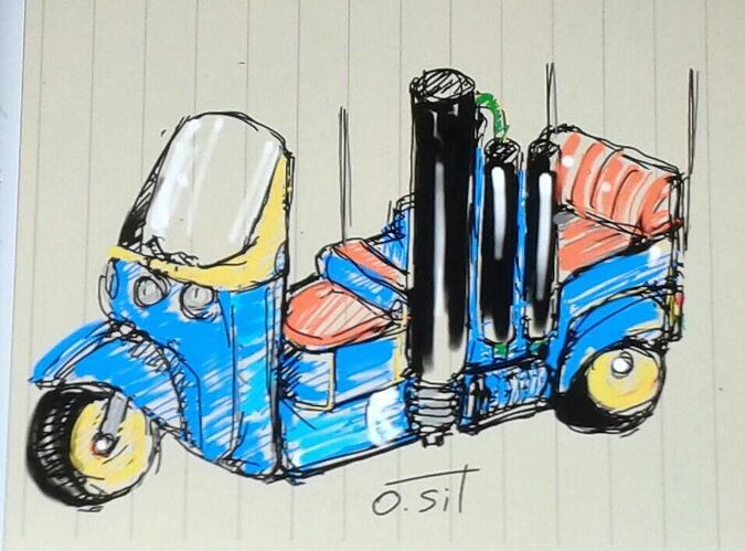

What size engine does that thing have? I would think it takes a fair amount of power to move a tank of water that large.
not sure yet, between 1000 and 1400 cc
looks like a 2 cylinder watercooled, has gearbox and cardan to the rear axle…
its a Tri-cycle
called Tuktuk in Thailand
the other one, they call it a Skylab

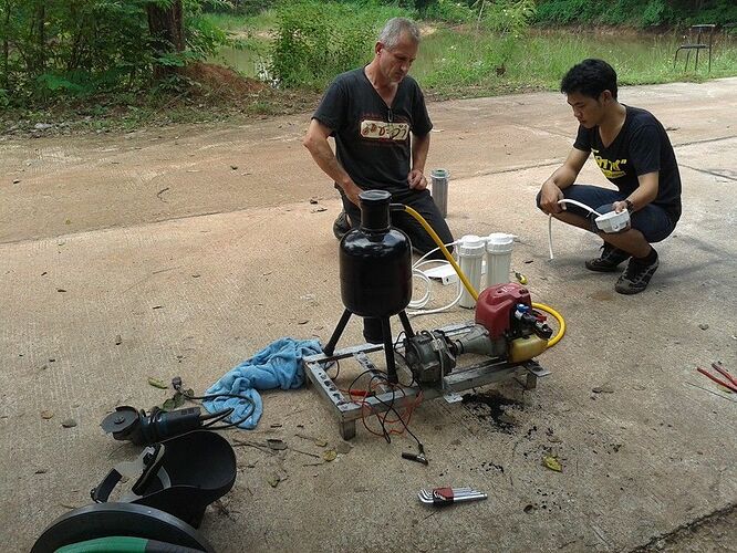

the others try to build it…

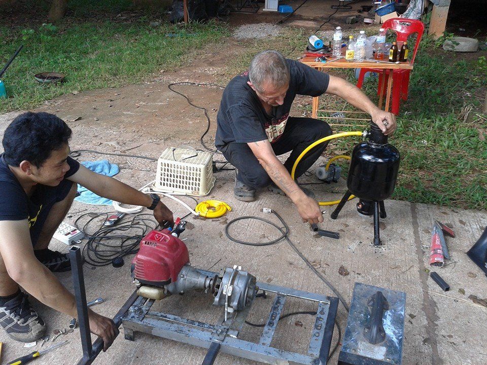

opted to change the size from the “little one” for the Honda. i keep writing and reading GX37, but it is an GX35, need glasses i guess…
Video starting the GX35 with the little one

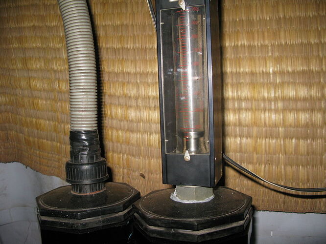

I installed this gas flow meter to give me an exact read out of the gas flow i am pulling ot the gasifier.
Works great and gives me a good insight

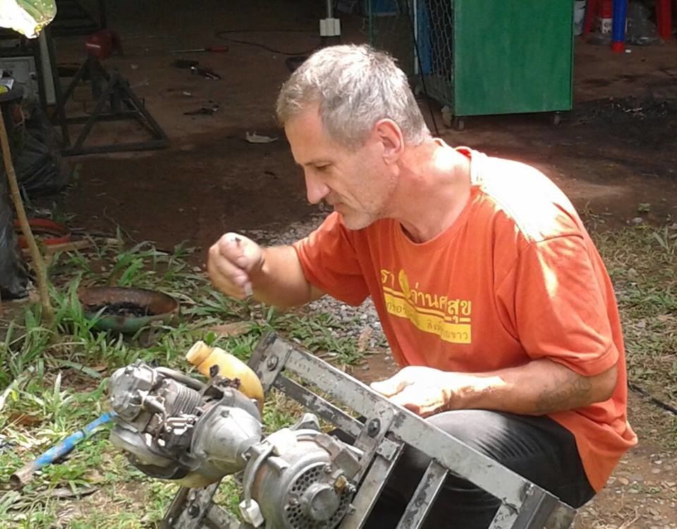

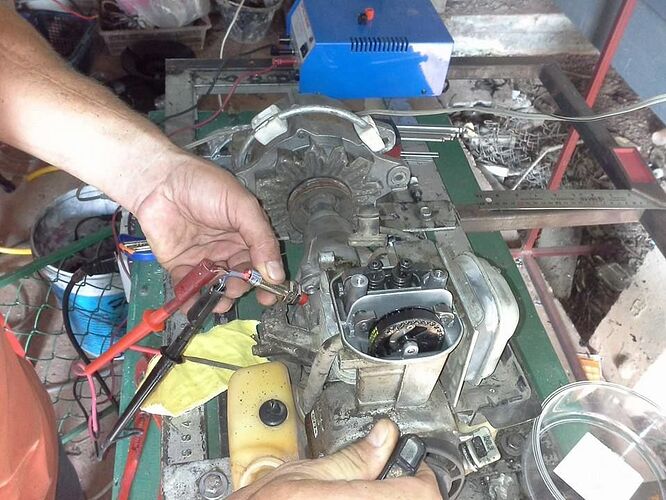

Working on cam shaft timing and valve lift improvement. ( adding 2mm valve lift, 9 ° advanced )
Ported the intake from 9 mm to 13 mm
Fitting 1/2" ball valves
Making a pick up sensor for Rpm and digital ignition home made CDI unit

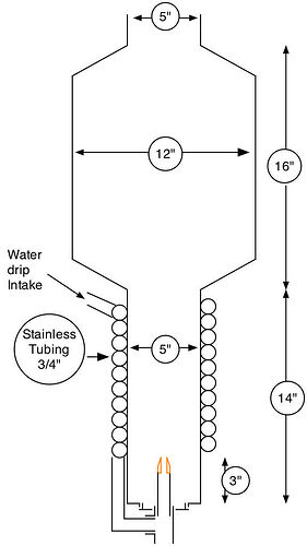

Hereby a drawing with the main dimensions from the RET Gasifier.
For those who want to start building one…
That looks very doable. Is the cross section area of the nozzle a critical factor to hp. I plan on using the 8hp 5kw gen set I currently have.

Yes, the size of the nozzle is a critical factor.
If you can give me some detail about your engine displacement and RPM, i can give you a pre- calculated size for starters.
Are you running it with standard carb or something modified ?
There are a few possibility’s:
-Running already on the “rich side” and at a “choked” level from carburator restriction
( once my gas was so rich it needed the gas tube disconnected to give it more air )
-Your air intake valve might be on the small size, so not enough air to increase the RPM
- The engine was already running at high rpm ?
- The temperature in the reactor was to low to convert it into H2 ?
