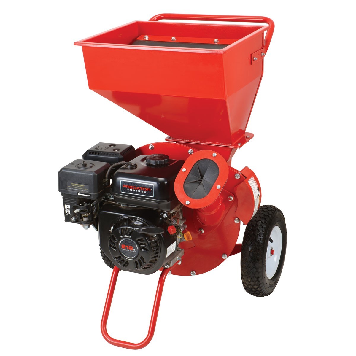

I’m excited to see a picture and know what model of chipper you have. Maybe also a picture of the fuel it makes in your hand?
I think he has this one:
http://www.harborfreight.com/65-hp-212cc-chipper-shredder-62323.html
Quickly reduce piles of leaves and small branches to useful mulch with this powerful 6.5 HP gas powered chipper shredder.
  • Chips limbs up to 3 in. diameter
  • Heavy duty steel leaf hopper
  • 20:1 waste reduction ratio
  • Includes garden waste bag
  • Shredding plate with four chipper blades
  • Smooth-rolling 12 in. wheels
  • Low oil shutdown
  • An additional lift-gate charge may apply.

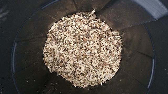

Chip sizes vary a bit, I was getting small 1/4" size on up to 1" size chips. I think once I learn to feed it more consistently I can get it to make good large size chips. We have typically ran Cedar chips that we bought and this has been from the very beginning. Size of these chips range from 1 x 1 x 1/4" thick. Now the fuel this chipper is making is a bit smaller; however, I think the density of the chips is comparable to the cedar and because this fuel is slightly smaller physically; density pr hopper load is more than the cedar.
What I was hoping for with this chipper is that it made a thick chip and that it didn’t make mulch. It does just that, even though the length and height is not very big, the thickness is there. I couldn’t find one video or one picture or any info the chips this produced. I went off one video I saw that showed the chips bounce of the ground. I knew form watching that video those chips had to have some density for them to do that. So that is why I gave it a try.

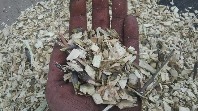

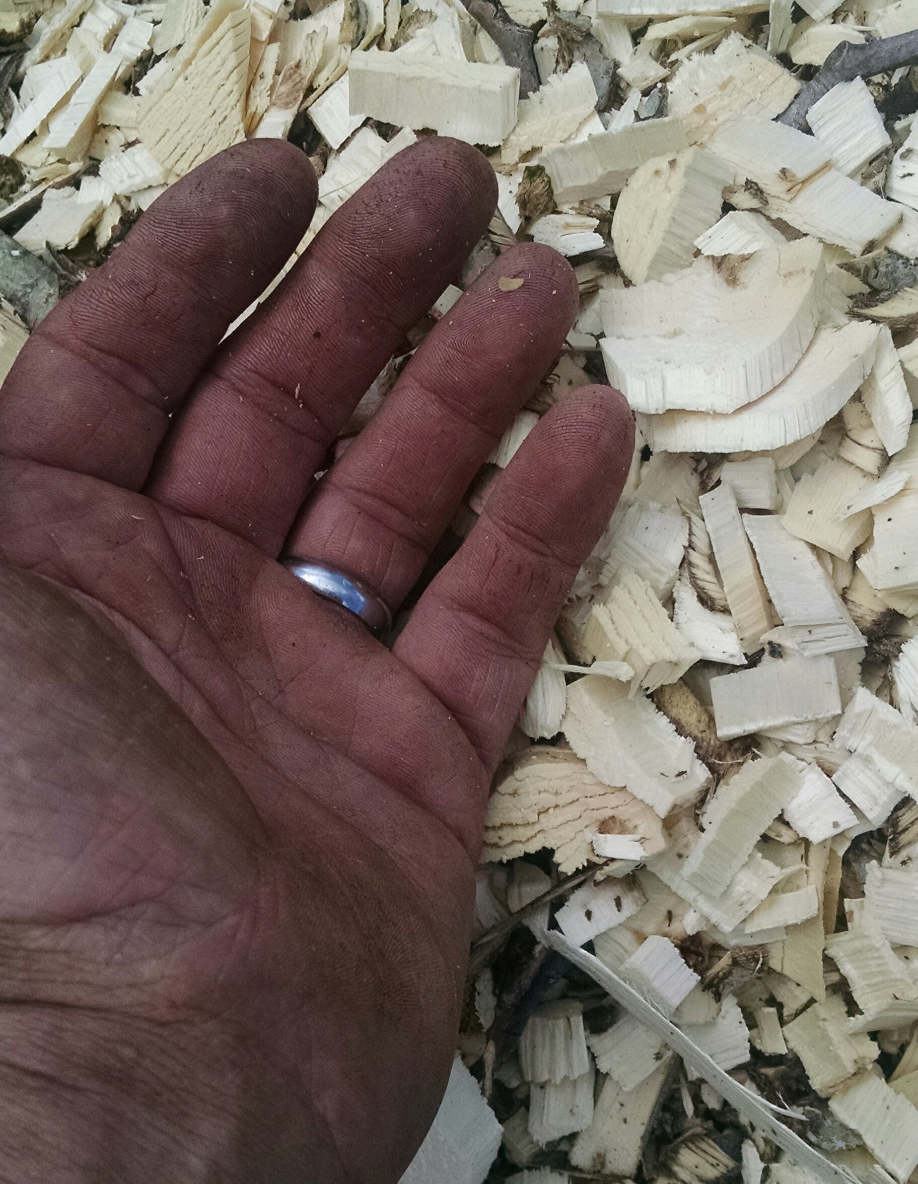

I’m interested here because I have a decent chipper. It gobbles up 3" branches with ease and I want to be able to gasify them.
This is the size chips I’m getting which seems adequate for a smaller gasifier. It worked in my first unit.
In my best ā€˜Donald voice’, ā€œMy hands are huuugeā€. Sorry, I had to. :slight_smile:
Those are comparable to the HF machine. Yeah those are what we are looking for!!
I could run those all day long in my systems… 6 inch hearth

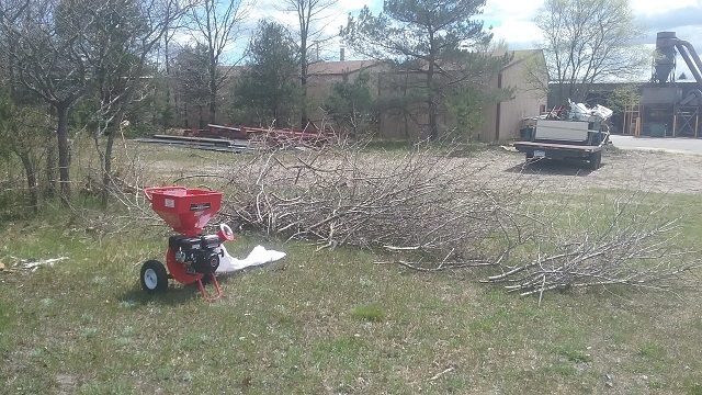

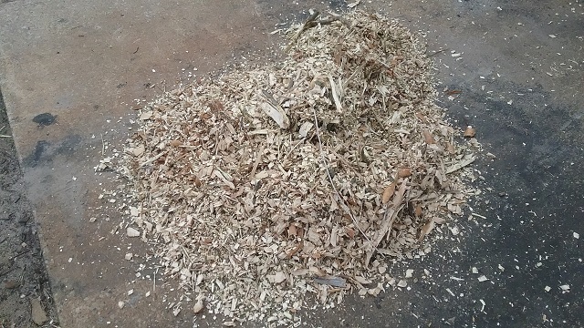

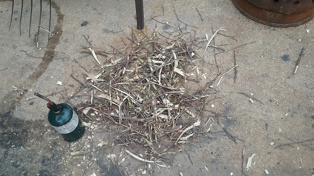

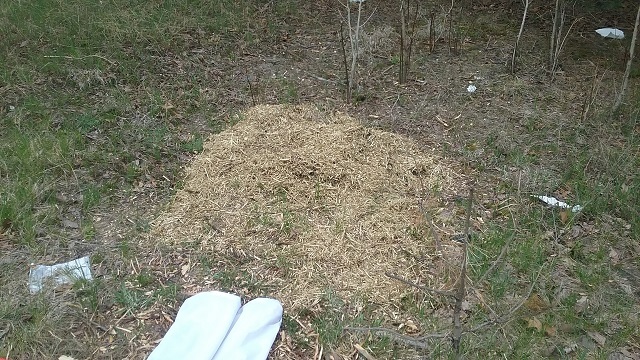

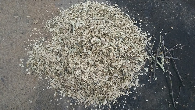

Yesterday, I went out and played around with the chipper. I tried a lot different methods chipping and shredding with it. You can see in the photos the branches Im working with have a lot of small branches. If you leave them, you have to screen these out later. as the machine will not fully process them. You will get all these long twigs mixed in with the fuel. I ran a batch with them left on and after that I pruned them all off. I think its better to just prune first its less work later and you get better chips with less dust in the product. So you got to de-limb your limbs!!! I then process those left overs in the chipper side of the machine and then rerun them in the mulcher feature and get a nice mulch from them. My chips vary a lot in size’ however, the branches I ran also varied a lot; smaller branches make small chips vise versa with larger branches. The larger 2- 3" branches do make a pretty heavy chip. This is why I want to get the splitter I want to try and split wood small enough to fit and then we should get a nice consistent large chip from this machine with no screening required. So Ive already started a compost pile, does anyone know if there is a thread here on composting. If so point me in the right direction, or maybe I will start one and hopefully Troy Martz will chime in on that one :slight_smile:
So another portion of this is going to be drying the fuel. I ran another batch in the gasifier and this time it didn’t go so well. I don’t believe sizing is the issue, the fuel is green and I think once its dried it will work fine. Not interested in extensive screening processes, The fuel that was pre pruned I would not even bother to screen in a gravity feed hopper. Our auger system on the other hand will need at least one screening to prevent any larger jamming pieces from getting in there. The first run I did was in blower mode and it also had a pre existing char bed from other fuels. Yesterday when I ran I tried running in engine mode and the char bed was well converted. The combustion zone kept voiding out and I made me some tars haha. So Im going to build some sort of dryer, Im thinking of building some sort of rocket stove or a barrel stove for the heating part and then a tumbler barrel in the exhaust stream.
