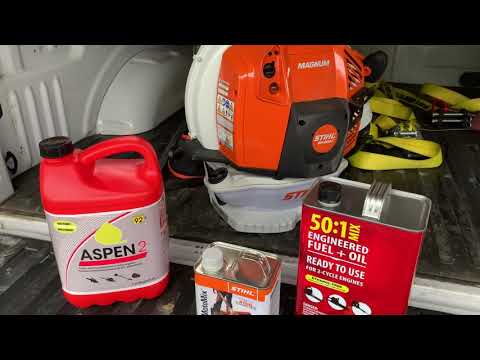

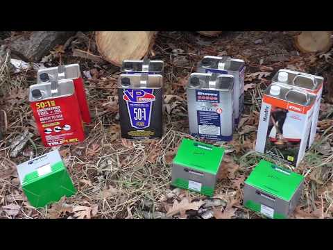

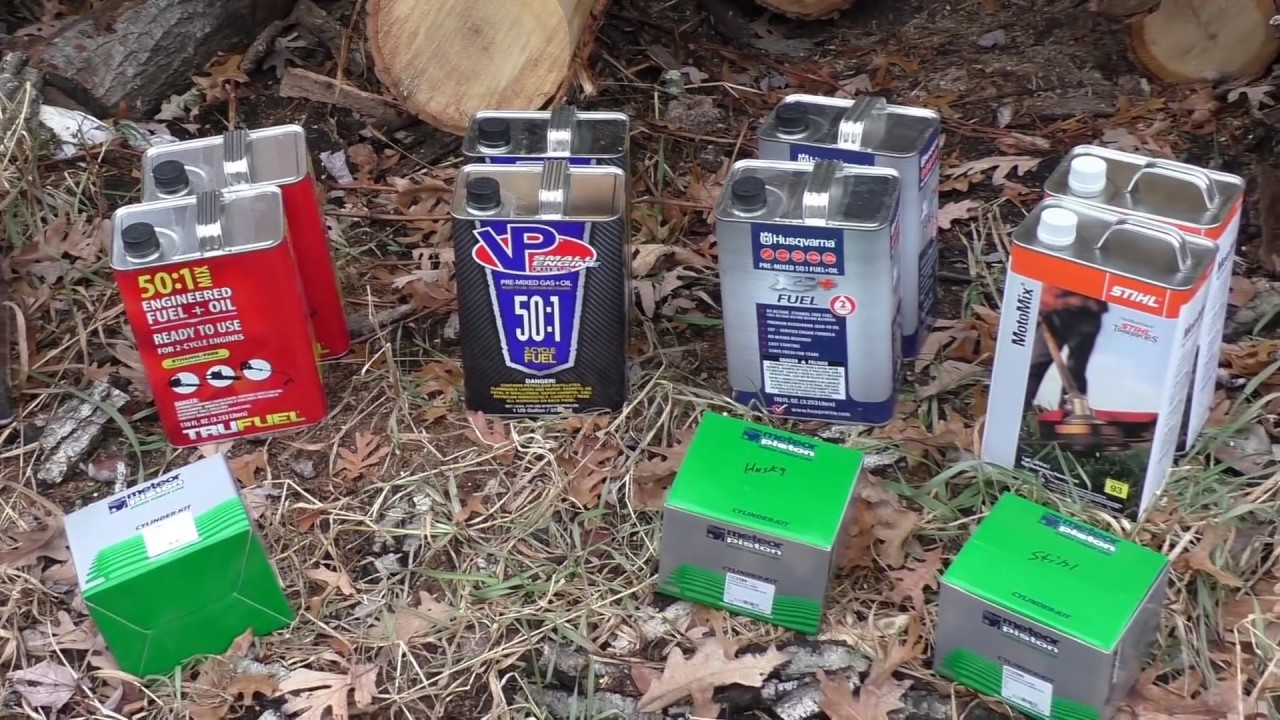

I finally found a realistic testing of four of the newly available 2-stroke canned fuels. Kind’ long. Watching his early actual release world woodcutting you will see one of the reasons why he is using such a big saw in his Stihl MS661. He is full 32" bar blocks cutting using a 404 ripper chain. Needs the raw power for that.
Then the fact of just how easy it is to accesss on-off the cylinder jugs on the MS 440’s, MS460’s and MS661 saws. The MS 661 the only one still held over in current production to where he could get the extra new cylinder jugs and pistons. Richard Flagg was open internet asking for anyone with spare jugs and piston for his MS460’s he trade near anything for.
Thier after work-run testing commentary beginning at 16:35 has lots of good information and thier experienced opinions in it.
My opinion is I have zero interest in any of the canned fuels due to costs. And I do not want to feed the ECO-beasts I war now with here especially.
But . . . if, when; I find some, some day for free I’lll know OK to at least use these four brands.

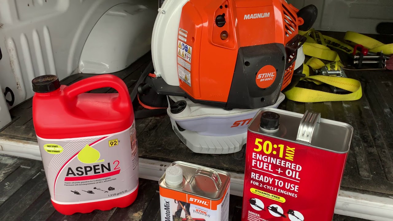

Hi SteveU, im with you on the canned fuel, it’s only cost effective in some cases:
A company that works with lawn care and like, where the workers may miss iq/interest in blending a sufficient fuel mix by themselves.
A homeowner that uses his string trimmer/chainsaw only 1-2 hour a year.
A idiot that owns way to much chainsaws to be able to run them periodically.
Season equipment thats stored away half the year really benefits from running on this fuel, just through the system, before storage.
When put in to work, just fill up with usual mix and run.
This will work if the canned fuel is a true alcylate mix.

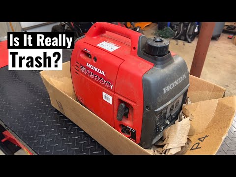

ALL: watch this one:
I did not know so many were virtually all the same working guts. This is good. Very good.
I am now not so sure Yamaha’s 2000 are thier own engine and designs. ???
Honda’s 2000’s are for sure thier own design. Using a larger engine at lower top end speed. My measured 4400RPM maximum versa the under 80cc types at 4800-4900 maximum RPM. To out-rate; and out-produce the competition, I see now why Honda went an even larger engine to make up their new 2200.

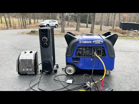

A new now bright sunny almost Spring day and new results.
The Echo Red Armor oil mixed at ~45:1 will be fine for me. So now I have my three known-good’s. It actually has the least smell. And that smell, not at all unpleasant. No wife complaints.
In the background running; loaded down to ~700 watts.
In the foreground is why I will not be buying another 240 VAC capable unit now
This Sears Craftsman unit was family ran up to me as the now third owner since it was new. Gets passed around as it is VERY LOUD.
I was told, “it’s a 3600 watt unit”. I expected an old flat head engined, exhaust stinking loud can’-hardly 3600 watts unit.
This thing is a 2006 unit with a modern OHV, cast iron bore 202cc engine. Has a big oversized dual output split phase generator head. That heavy spinning mass wound coils armature is what gives it the nearly 2X surge capability. It easily starts up; and pumps up to 150 PSI my oil-less air compressor. Inverter units with stationary windings have actually poor surge capability.
This unit is actually very fuel use thrifty for a 3600rpm synchronous.
I got in trouble with the wife hours 3+ hours running out one gallon of gasoline to be able to do a clean drain out oil change. She hate generators noise.
How loud? Can you listen to all 6:13 to this video??

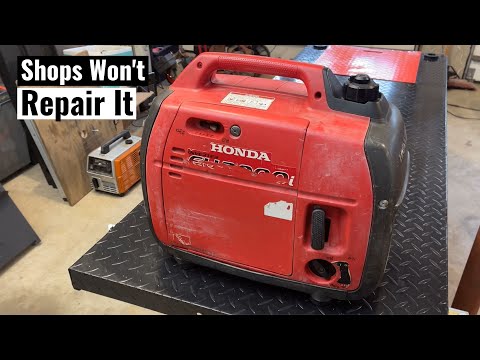

Here watch this completion repair video and see.
Pay attention to his words as he explained things he has learned the hard way doing generators repairs now.
Vapor lock!
