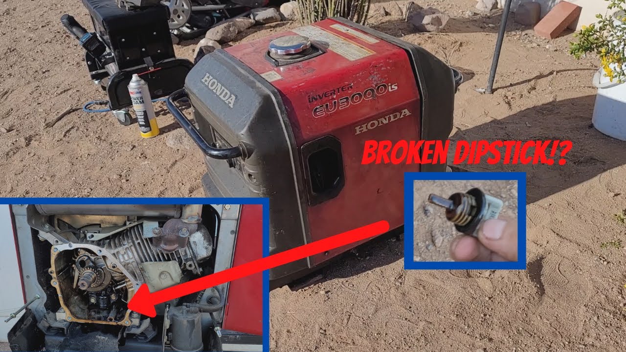

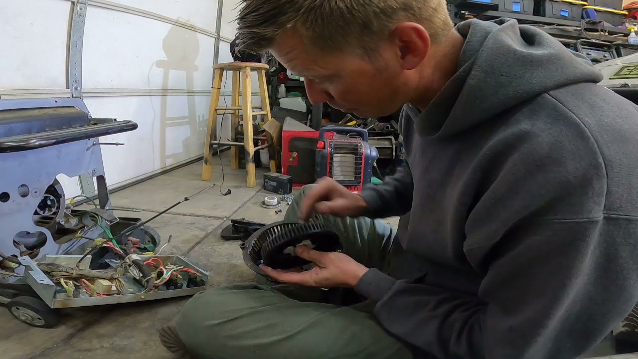

Not always do internally broken off parts settle down, and stay safe. This unit ate the broken off end of the plastic dipstick. Save some of your life-time and skip ahead to 10:21 to see this
At least he was able to clean out the ground up plastics and get the unit back up and running.

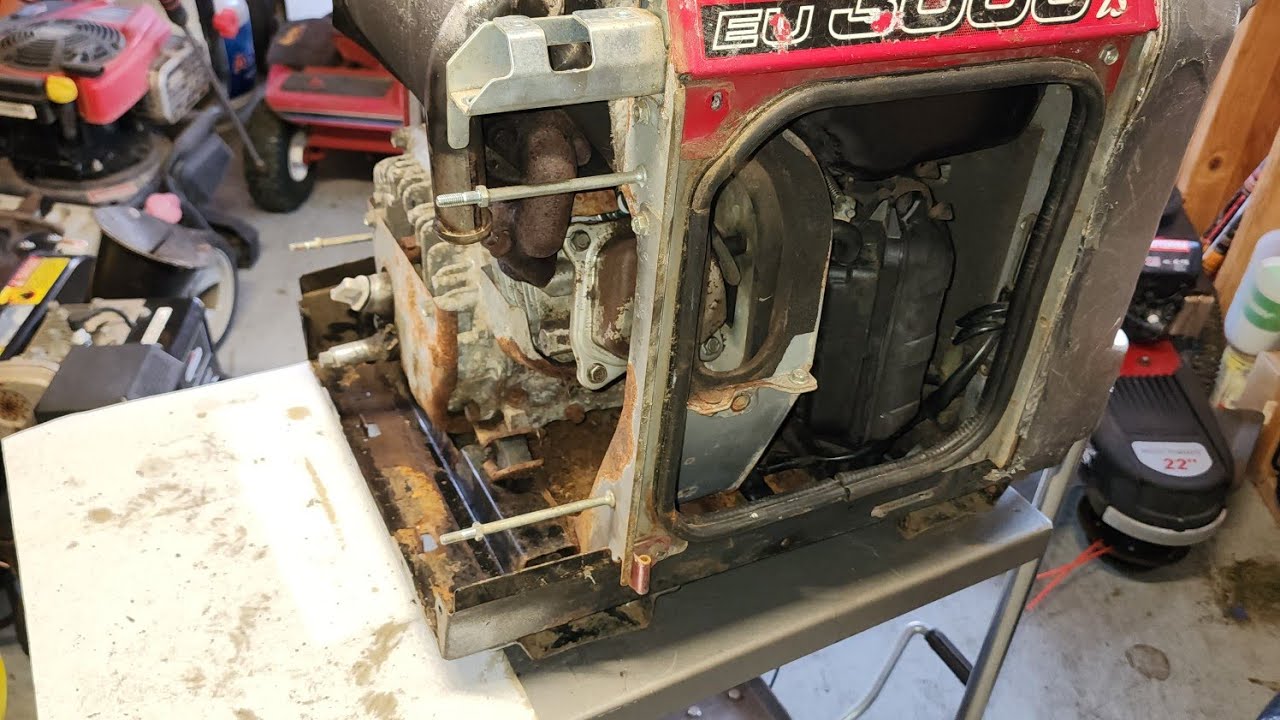

Now since he shows in detail one end of a Honda EU3000 . . . here look in detail at the other end of this expensive Honda-quality unit
No fun replacing a worn bad pull cord on one of these.

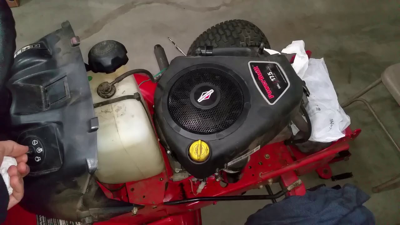

Another rider mower with the 17.5 vertical shaft B&S engine not anymore able to crank over to start.
He’s watched many YouTube video and come accross one with a guy evolved a three step set-process to get his to crank over to start.
Removing the spark plug. Hand rotating the engine over to Compression TDC. Then rotating just past. Spark plug back in. The three shots of starting ether. Full choke. Starting on the first two revolutions. This did not work for him. Too cool-cold.
Then he’s found another video of a fellow promoting an air cleaner filter off. Then flap blocking air flow to not get then air to build compression; then get able to crank over to starting.
That did not work for him either. Too cool-cold I expect? Old gasoline I expect? Pres.Biden special last winters E-15 less volatile gasoline? Carb with a years sitting open now, stuck open needle valve?
Ha! I got there and pulled the spark plug. Gasoline gushed out of the cylinder and a totally fuel drowned spark plug.
He had the top plastic cover off removed. And that allowed the plastic fill/dipstick tube to be pulled off removed.
Then I fished down with a telescopic magnet and fished out broken up compression release mechanism parts.

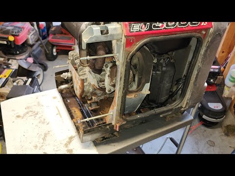

Here a new found video on a Honda Handi EU3000i (their other; smaller, lighter, less expensive unit) having a new pull rope installed.
Honda enclosed inverted-gnerator units are excellent quality and capabilities.
But no-fun at all to work on when comes the need.
And the needs will come.
Watch through to the end where he does start and run this inverter-gnerator a to verify no other engine-generator problem had caused the broken pull rope.
