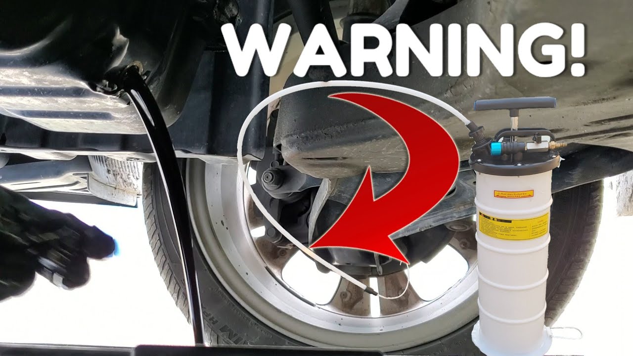

Here is what I have used for small engine gasoline removals:
Listen and not recommended for gasoline.
I do enough heavy gear oils so a gallon or so of gasoline out of a small engine tank will not harm it.
Does somewhat cross contaminate with whatever you last sucked out however. No biggy as far as I’m concerned taking out old gasoline anyhow.

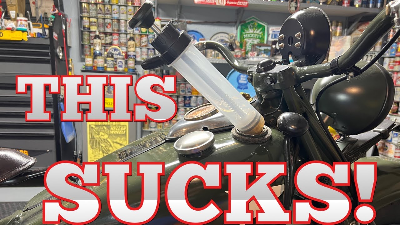

Better is a simple one stroke suction sucker/filler
These last two just the ticket for AWD, PTU’s gearbox units and such. Work sideways and upside down.
For gasoline do oil wet the o-rings before and after.

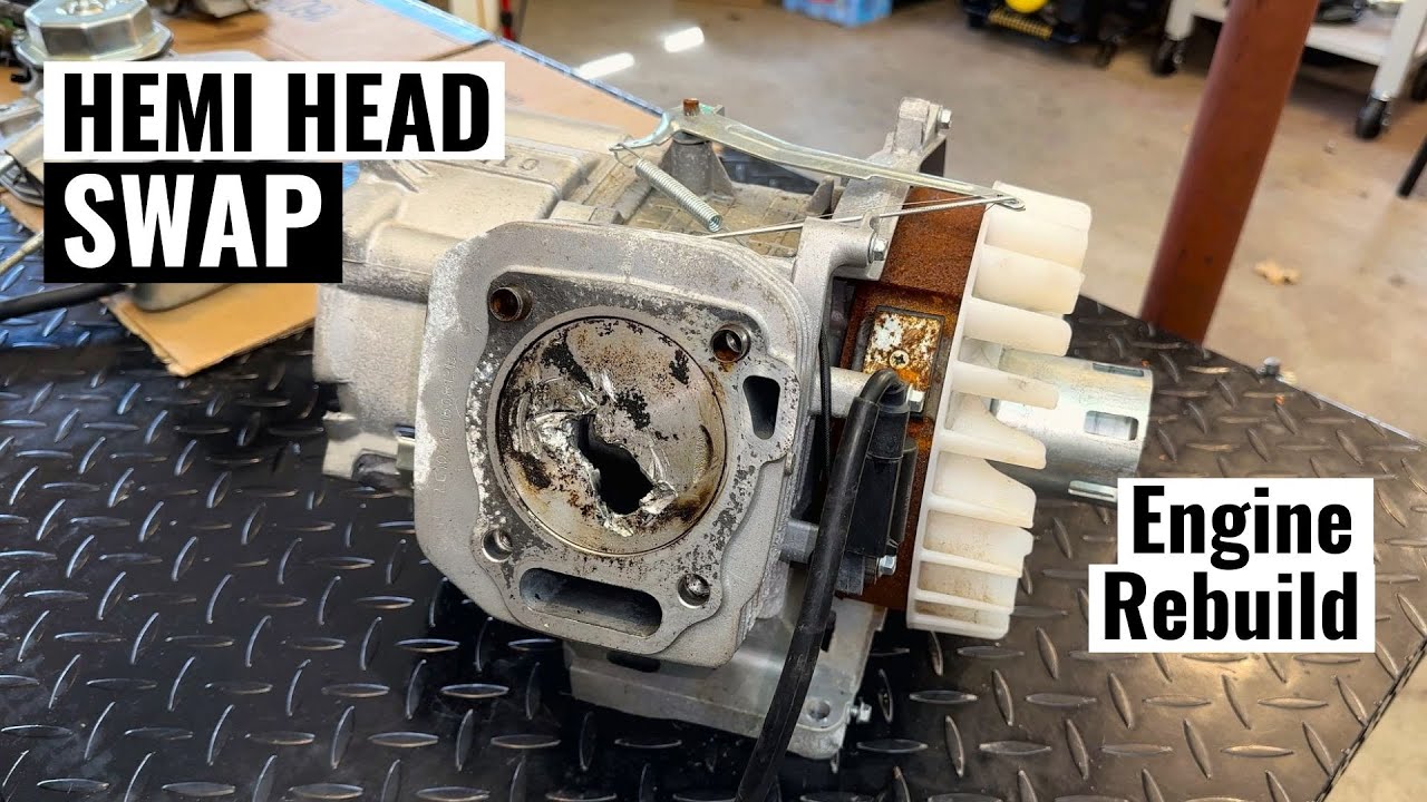

Hi All,
Here is a new video out showing just how much cheap fun is now possible with small engines again.
He is try-it; swapping engine parts from different OEM configurations. Memeber @Wallace here on the DOW has talked a lot about these now clone engine possibilities:
Pay particular attention to this guys detailed fussing at ~1:14 an on, with setting up the engines speed governor to the adapted over used carburetor. He does not want an RPM runaway occurrence to happen damaging his work.
After that when he sets up his camera stand gravity bottle gasoline gravity feed for engine starting and testing do see he is in a warming long sleeved sweat shirt.
Mean his shop is kept cold.
Cool-cold keeps wicked gasoline still somewhat safe.
Gasoline at above ~60-70F/16-22C becomes more and more flash-point self vaporizing evil always trying to burn you. Burn up your equipments. Burn down your shops.
Treat is as actively mean, and evil; always out to harm you with the least bit of loss of attention. All snakes can and will bite. All dogs can and will bite. All guns can and will Unintentionally Discharge.
Never forget this warning about gasoline.

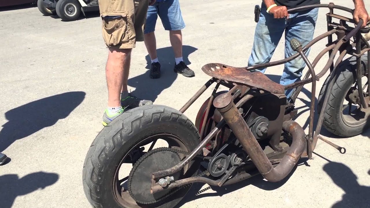

Hey Stuie,
If you like that kind of thing you ought to have a look at John Stouts Woodgas Rat Rod Build.
One of my goals is to make something for fairs and parades.
The ColoRODans host little events up in Longmont. I always want to go with a woodgas vehicle.

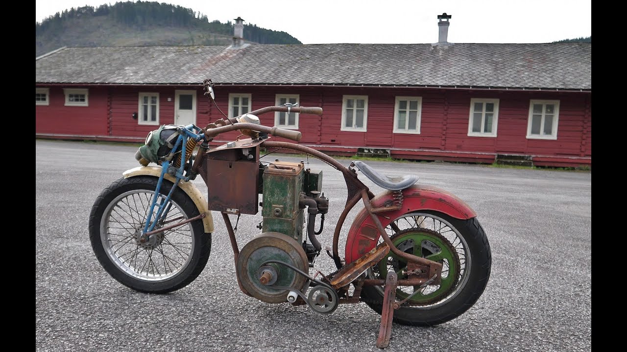

Fun with small IC engines can be making new, old-basic solutions:

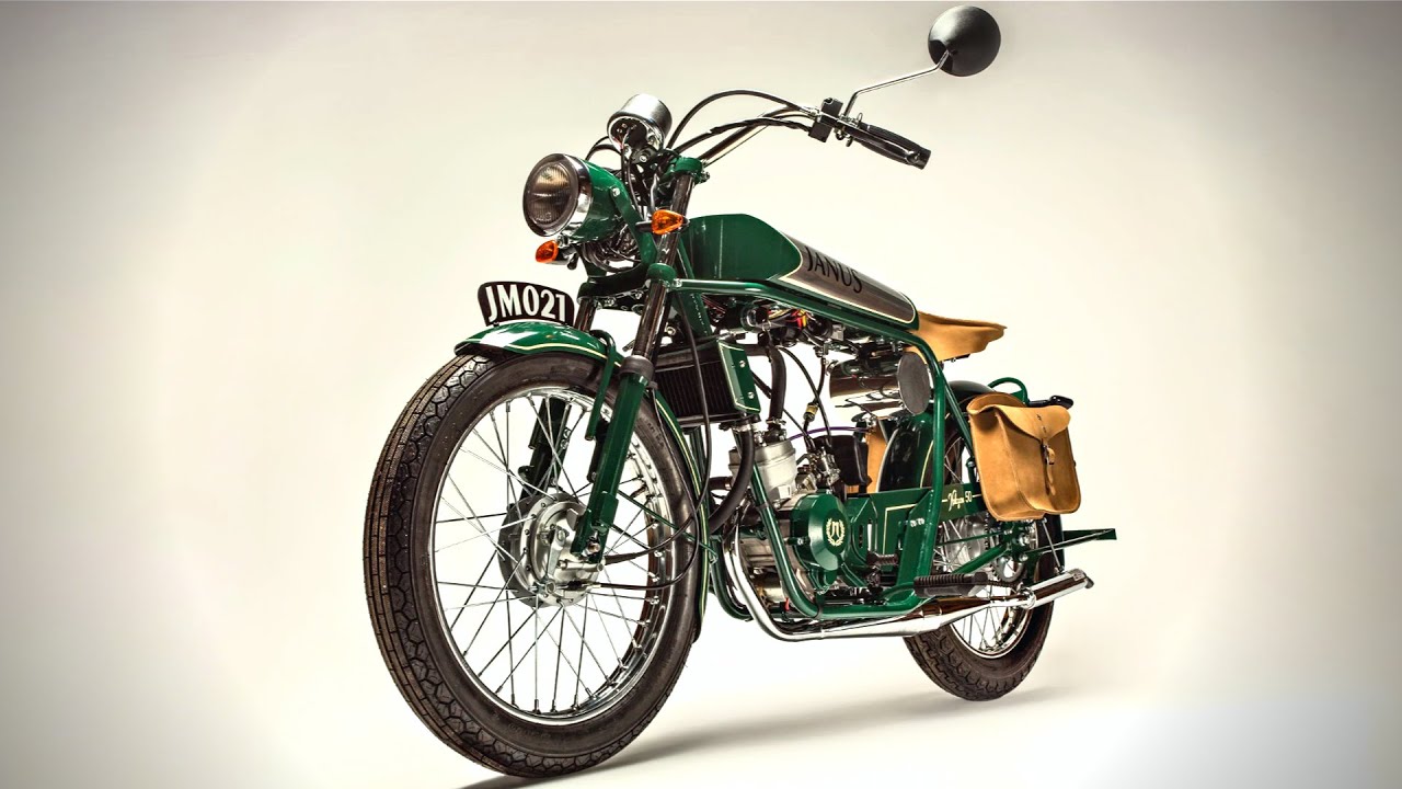

I liked that Janus video. If I had a lot of money I might show up at their sales counter, with my chargas generator in the back of my truck, and ask whether they would consider building me a chargas bike. Just wonder what kind of reaction I’d get.
I am a bit over two hours away from the Janus factory in Goshen, IN. I am ashamed to admit I never heard of them until today. Time to get a tour! Good Grief!

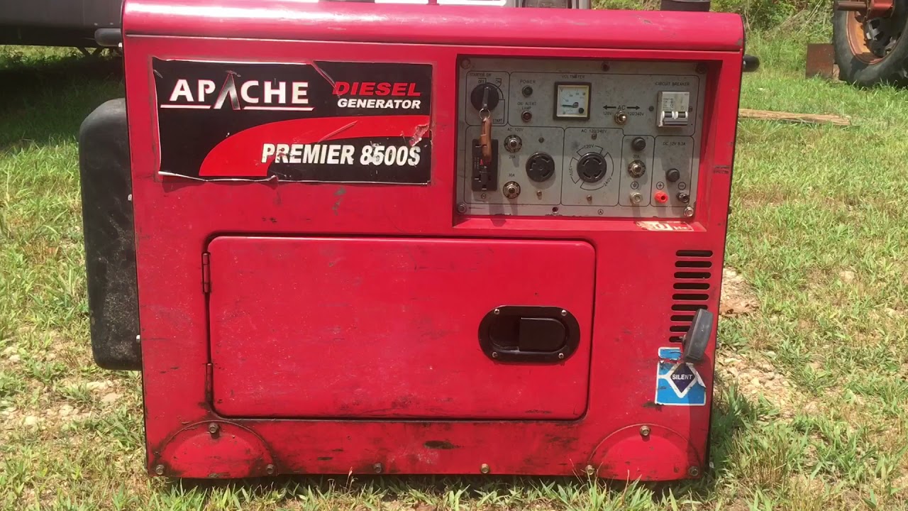

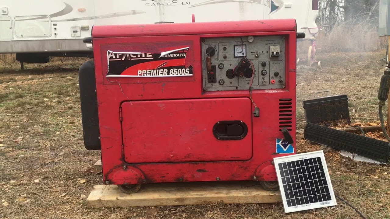

Here is a couple of videos for you “Diesel” Dave
As you’ll see this fellow had a hateful of problems hard mechanical to electro-mechanical he had to work through.
A few fellows I’ve talked to in cold-cold winter say just skip the cold diesel problems. Cold-cold: use gasoline. Just cold: use propane. Set back the diesel use for warm times.
You are more moderate climate even if windy stormy, wet.
