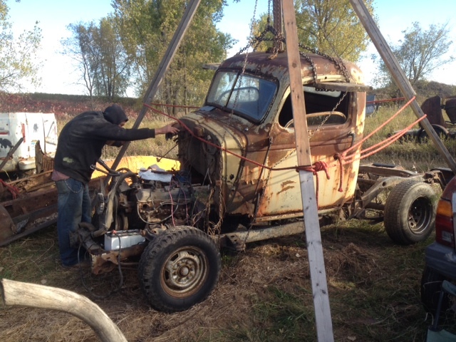

So I got to work and found a little, old, rusty '46 Chevy truck. I thought I would put the cab on my Dakota, but that wasn’t going to happen. So I took the cab and box off the old Mitsubishi, and mounted a 350 Chevy carbed engine in there. Then bolted the rusty Chevy cab on there and took it for a spin on petrol. Now, there was a little truck with a big engine! Just right for woodgas.

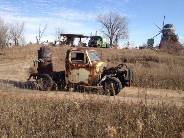

Is this too big?

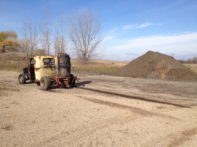

Test drive last fall on petrol. Engine donor in background.

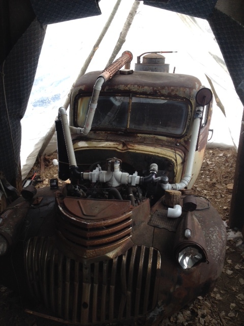

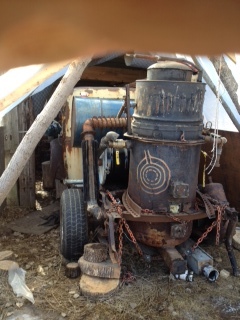

This is sort of how things look today. Still waiting for snow to melt to fasten everything in place.

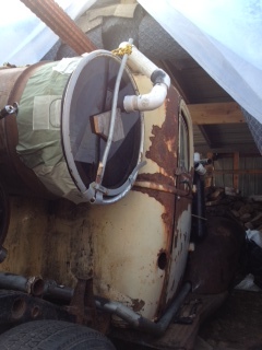

I don’t dare weld in the wood shed! You can see the gas mixer and the fancy copper cooler. Both are untested. One thing you can’t see is the gasbag…

Jim I believe I got that old Chevy somewhere not far from Sandstone Minnesota. Underneath the cream colored paint it’s olive drab paint. It was still running in 1972.

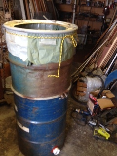

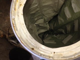

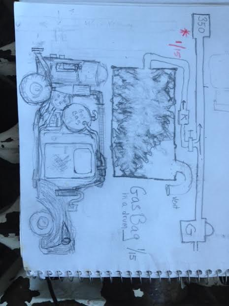

I wanna here more about that gas bag John.
O.K. Jim, here’s the schematic. In the main line running from the Gasifier to the 350 there is a T. At the T there is a Kirby. ( I suppose a bilge pump would work). The Kirby sucks some woodgas from the main line, sucking time depending on either the valve or a dimmer on the Kirby. The Kirby sends the woodgas into the gasbag which is inside a big tank- one and two thirds 55gal. drum. The gasgag is able to inflate because there is a vent in the drum (not in the gasbag). When bag is full, valve is shut and Kirby swithed off.
When screaming away from the hypothetical starting line, the valve is opened to allow the engine to suck the stored woodgas into the stream of woodgas coming from the gasifier, hopefully providing about a two second long kick in the ass, enough to get moving.
Hey that’s cool John. What is the bag made from?
