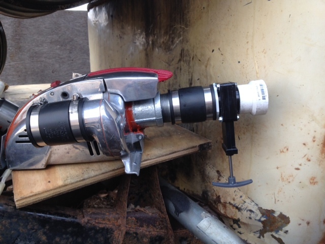

Hi John, that“s realy cool. I have a question: what tipe of valve did you use? Is it a check valve? Can you give details of the valve and where did you located it? THANKS
Hi, Abner.

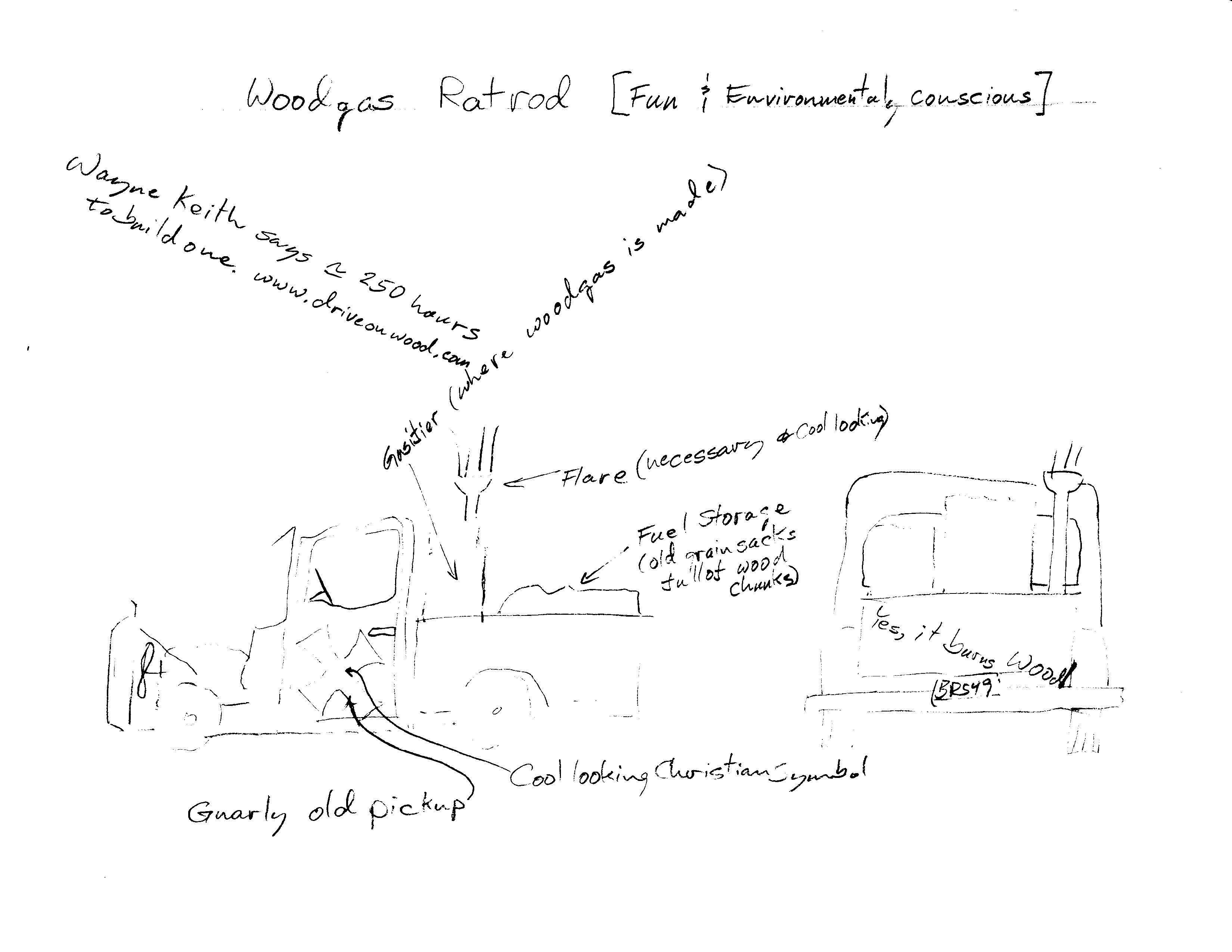

The valve is not a check valve. As you can see in the schematic drawing, there is a āthingā on top of the cab. That thing is a Kirby vacuum sweeper motor+vacuum pump, labeled āKā. In this photo you can see the actual kirby with the valve attached. The valve is a āblade valveā often used in swimming pool plumbing. The valve handle will pass through the cab roof into the cockpit. Abner, this is a build project, and I am stepping into places new for me. However, I am hoping to know within a month of good weather how this gasbag works. Stay tuned.
Are you running a woodgas vehicle? Or planning?
Ahh! A good old Kirby. Love them. I was afraid of the plastic in the valve you used so I spent a lot of time lapping in a slide valve. I see now I wasted a lot of time Youes works better. What are you going to use for electricity for the Kirby. I have a 25 ft elect cord real for when I am at home. I have a HF 800 generator when Iām away. I think in retrospect an inverter would have been better, but it takes a lot of cranking to get the engine running on wood. TomC
Hey, Tom. I have a Kirby under the hood, well I guess thereās no hood on the hotrod. I have a Kirby that I use for starting and Iāve been using The same one on all my previous builds. And yes I do use an inverter. I find it works very well and it is very reliable. I generally run two batteries which seems to provide plenty of stamina for getting the fire going. Also I have been able to run the engine on gasoline to power up the inverter while idling in the morning.
This woodrat Rod build will not have a gasoline tank. Same as my first build in the Mitsubishi pick up, I took the gasoline tank out of that one too. I love Kirbys! Of course, in this application I will only be running one Kirby at a time. As I mentioned I put a dimmer switch on the Kirby so when the inverter starts to whistle I can turn down the amps. The Kirby keeps running at a little slower speed and it works fine.
I have carried a small generator along for security in the past, but two batteries with the inverter is more elegant.
Hopefully, if my untested cooling system works, the valve will hold up. I have used other plastic valves very successfuly in the past. I belive Mike LaRosa uses these blade valves as well.

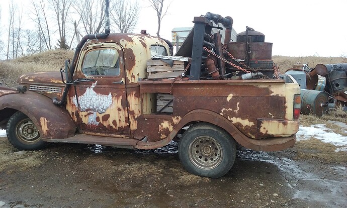

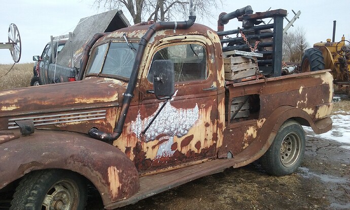

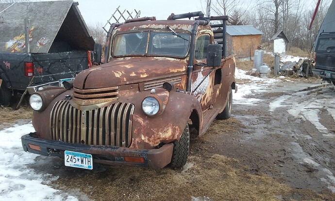

hey, thanks for the holler! although it doesnāt seem like it I am still a wood gasser! And Iāve got my 46 Chevy wood rat licensed and insured and ready for spring. I will post a new pick if I can figure out howā¦

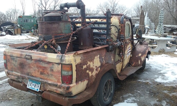

Fancy tail lights for a '46 Chev.

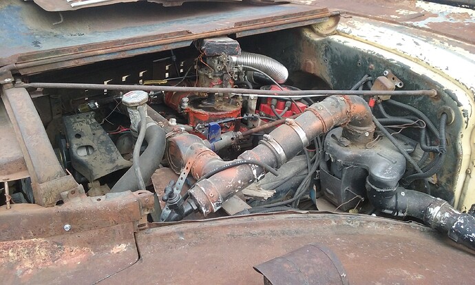

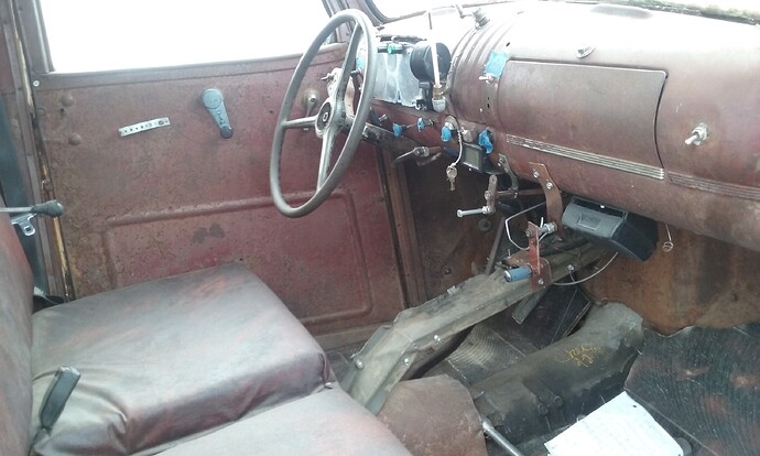

I canāt determine from the pics what engine and tranny is in there. I donāt see a shifter anywhere in the cab - on the floor or 3 on a tree.
Looks like a fun ride!
Right, Don. Itās sitting on a Mitsubishi frame and when I realized I had to get a license plate I got the brilliant idea to put the Mitsubishi tailgate on the frame and stick the license plate on that. Seems perfectly legal to me. The engine 350 Chevy has an automatic transmission. Shifters on the floor all the way forward in park.
Lookin pretty snazy there John. I want to see you take a knee in front of that fine machine. Pompadour, Brillo ⦠the whole bit. Your soooooo cool man.
Well⦠Yer a bad lookin dude there Mike. You want the job?
Designing the Rat Rod? Sure!
Armed Guard? No, Thanks for your confidence!
Glad to see youāre still with us John!
That truck shows you are an innovator and an artist.
I love the truck.
A thing (truck) of beauty, is a joy forever! Love it!
