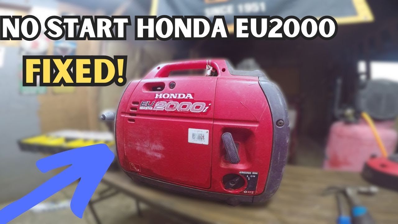

Hey Steve , thanks for finding those video’s it looks almost the same apart from a few items like does not have a pull starter and also are only 240Volt , apart from that they look identical , still not sure of the KW output ,i would have had to guess its higher than the one in the video due to the extreme weight of the thing , today i borrowed a crane truck to pick up the 2nd unit and took it to my friends shed as its too big to maneuver around my place , i shall keep it handy for spares but what a bargain 100 bucks for 2 that’s around $70 US i think .
