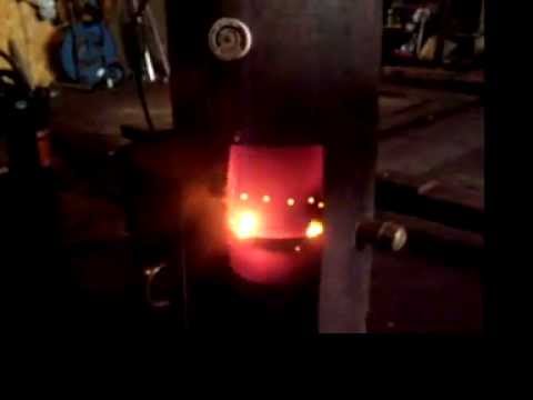

its been a cold winter finely getting some heat .watched a bunch of videos on waste oil heaters and decided to build one i had most of the parts from the truck build.

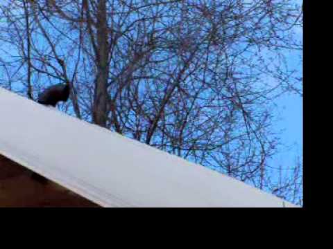

two quick videos in the shop and a look outside.
I built a burner about like that,only problem i was haveing,is the oil was too dirty
and keep pluging my petcock shut off, is there any certain kind of restricktor that works good, mine looks like the one on bottom of old raidiators,for the drain.
kevin I put an old shirt over the bucket I used for the oil tank just a cheep filter so far this has kept the valve clean time will tell.
