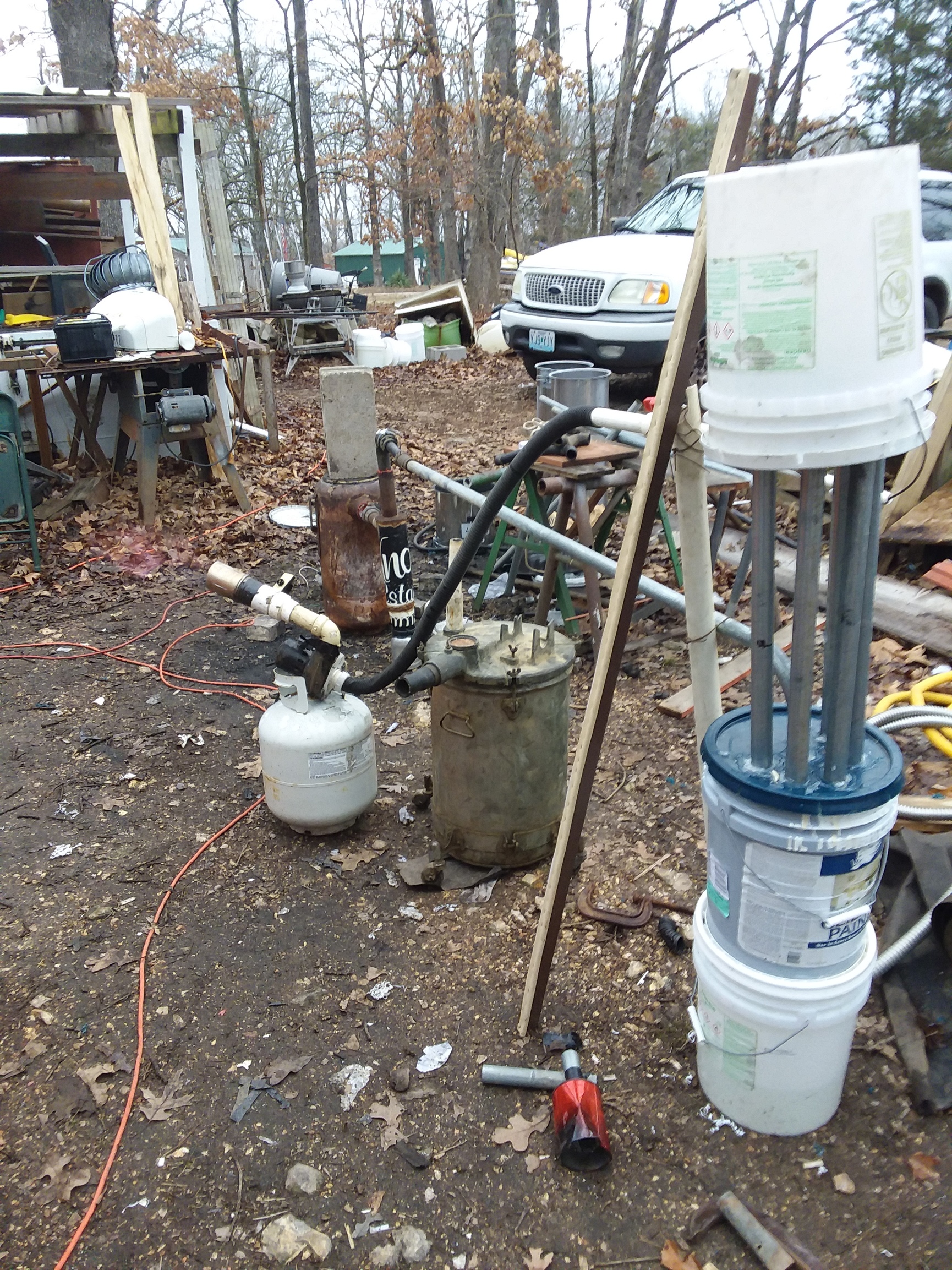

Hi TomC. I want to run it all brother. I just thought it was a good general discussion item. I really don’t have any specific questions. I’ve watched a ton of videos and pulled the trigger on charcoal for ease of build and I was already making charcoal for my forge. I’ll upload a few pics once this cools down a bit because I’m sure the guts of this thing are more interesting than a propane bottle, a real estate sign, a
nd a coupe plastic buckets with dog kennel pipes between them.
I’m always interested in the different ways obtainium is used. Bring out a lot of never thought of using it for that.
Helpful hint. Be careful posting pictures there are people here that will go over all the back ground items then ask questions like what is that clamped lid vessel by the propane tank? Are those tops of stainless steel pots in the background? :grinning:

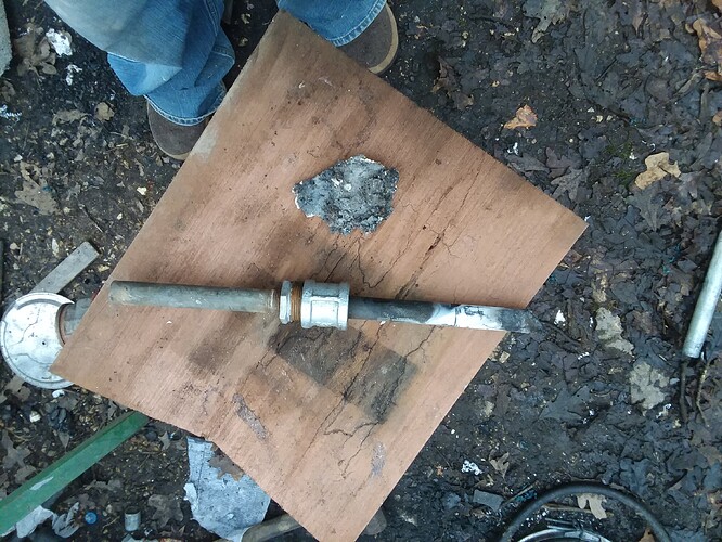

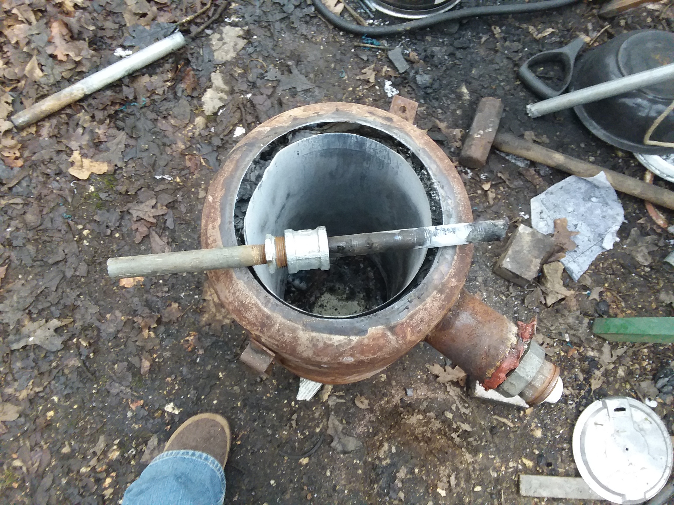

Ok folks. I got some pics this morning. Lessons learned from this clean out for the new guy.:
Red rtv ain’t tough enough for a hearth sealant. It’s just gone
Plaster/silica sand held up mostly for my hearth. Probably not the best solution but maybe.
I was able to remove my 1/2 black nozzle shrouded by a 1" pipe externally but it did melt some and I believe slag buildup would make it impossible after a couple burns. Stainless would help with the melting but probably not with buildup.
The stainless liner and insulation seemed to work out pretty well.

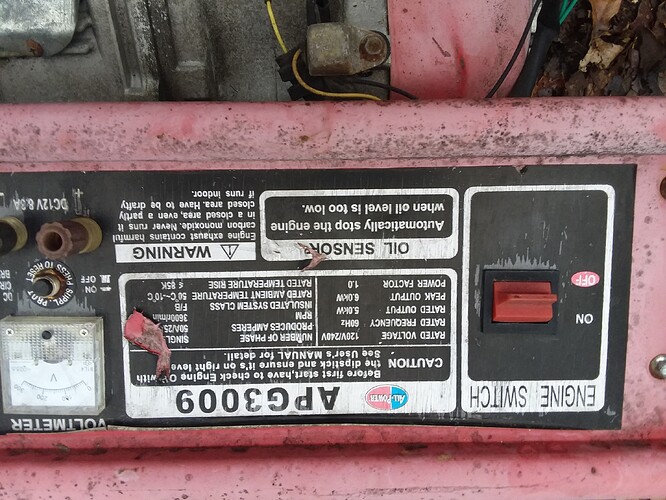

This generator was given to me. 13 hp. Rats have eaten chunks from the wiring. The pull rope assembly is gone. But it ain’t locked up so I’m going to mess with it and see what I can make happen.
Ok JP ( is that what we should call you?) Now that is a good introduction. We know more about where you are at in gasifying and where you want to go. You are already ahead of what many people know or have done when they come to this sight. The generator sounds like a good starting project, and your gasifier is a good start. (I said we know where you are with gasifying but where in the world are you) TomC

I’ve not been into the charcoal side of gasification myself but I used stainless in the hot parts of my wood gasifiers.
Actually stainless has a slightly lower melting point than mildsteel. Also its conductivity is not as good. The advantage is it doesn’t scale from heat like mildsteel does.
Maybe you’re already aware of Kristijan’s nozzle. He used very sturdy mildsteel and it seems it did its job to carry enough heat away to make it survive. Other people here have copied his idea with good results.
