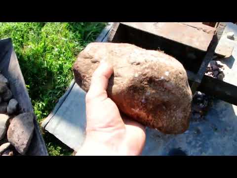

did some granite crushing yesterday and took a little video.
may be will find it useful or interesting ))

Greetings Andris, you have designed a very useful device, now I have competition in stone crushing at DOW… ![]()
Yes, beware Tone.
How are the rebars holding up? The are mild steel, 4,8?
thank you Tone for kind words, crusher indeed is very useful, unfortunately i have not much stuff to crush beside granite, not sure how long this contraption will last ))
Joep, i am not sure about rebars, most likely mild steel.
they are about 50% worn at the spot where most of the action is going on.
some of the stones are especially hard on rebars - usually dark grey stones with fine structure - they do not crack, but grind and grind between the jaws.
Great job Andris, it is indeed interesting.
It looks like some thick plates you made the outside from, about 20-25mm perhaps and the jaws even thicker. I would have imagined that it would have needed a really big flywheel but yours seem to handle it just fine ![]()
I definately see the value and use for one here too.

Johan, it is all 20mm plates, jaws reinforced with ribs for rigidity.
the things i make are always defined by materials i have at hand ))
stock metal is expensive nowadays.
you are right about the flywheel - i did intend to put another flywheel on the other end of the shaft,
but the piece of round metal bar i had was too short.
i could make the crusher narrower, but then bricks would not fit in it length wise.
