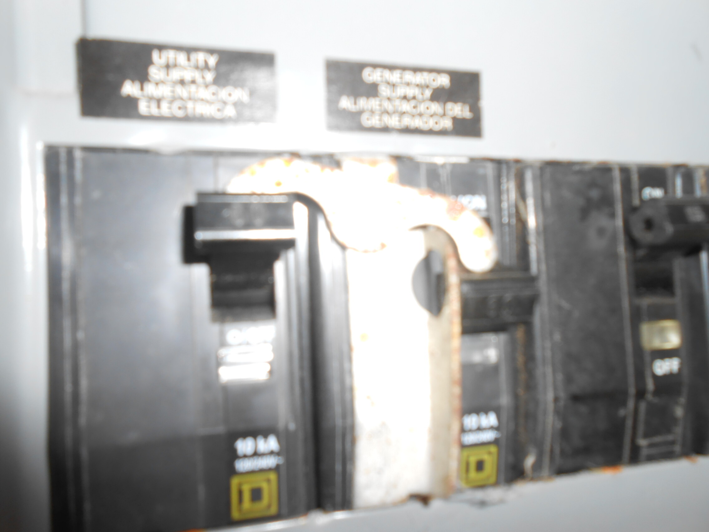

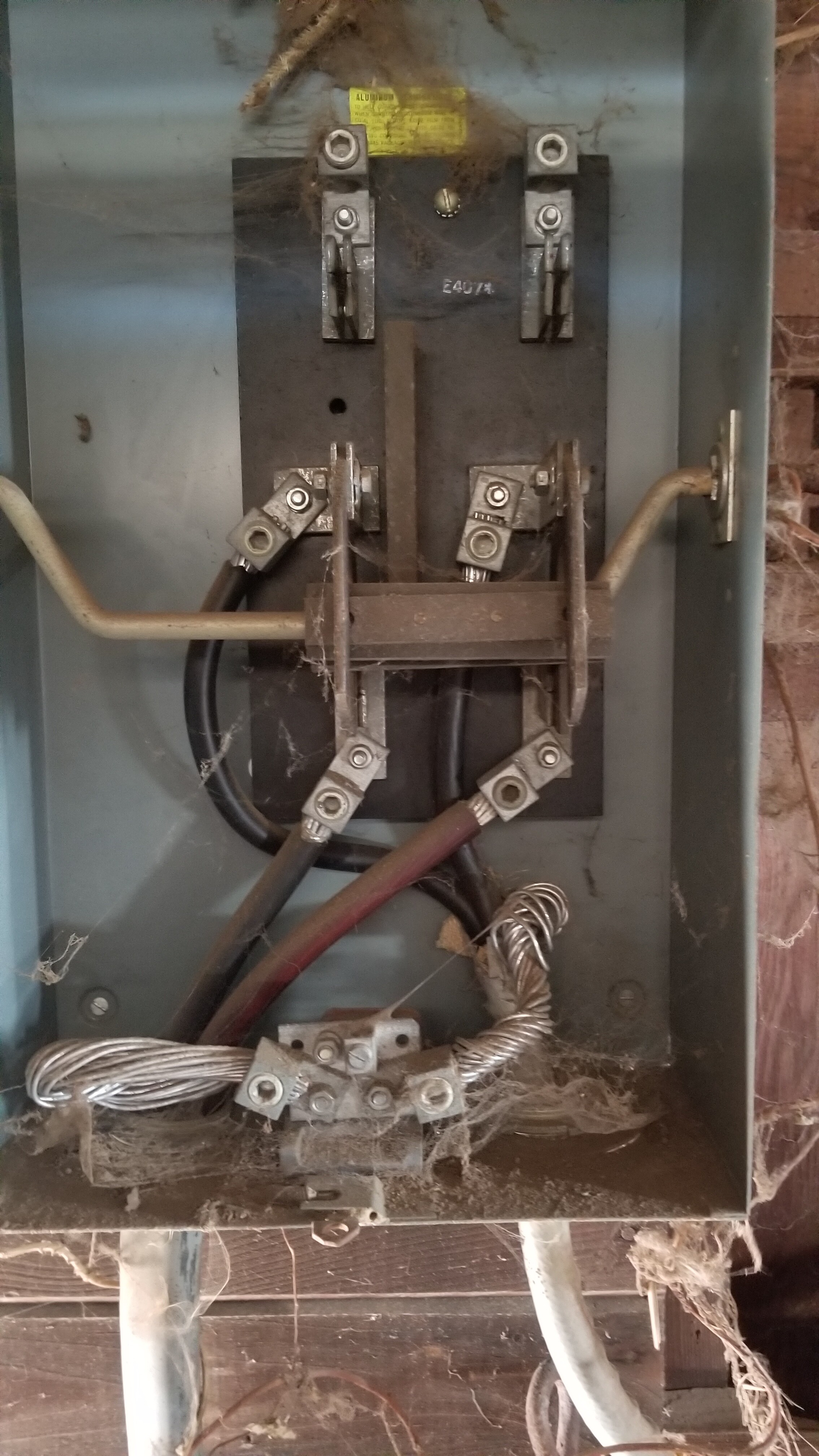

As to hooking up the generator to the power panel you have two choices old school A B switch.
You wire the grid to A the generator to B and the panel to the center. This makes it impossible to back feed the grid.
