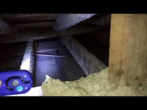

So, here’s a bit of the attic and that load bearing wall I want to open up. It’s a sort of cantilever design, the rafters go past the wall by about 3 feet or so, meet the joists which overhang the (old) exterior wall. Kind of hard to describe, just watch the video.
That’s some building / carpentry concept they did there. Sadly why we have building permits and inspectors, common sense isn’t very common.
Apparently it has worked as a roof system for decades, but from what you show, the roof structure is very poorly attached to and haphazardly supported by the wall structure. I would be concerned about total failure in a strong enough wind, or perhaps a heavy snow load, though that probably isn’t so risky in your location.
So this journeyman carpenter says that is all kinds of strange!
That mid length support for the rafters looks like it was supposed to be a pony wall of some sort or it could have been hammered in later because of roof sagging. Mid summer it does nothing but put a ft of wet snow on it… I’d love to see it rebuilt to disribute load. Should be no big deal opening it up anf sizing a beam based on a single story span table but the trick will be figuring out bearing downwards. What is that wall resting on? Is it possible to figure out what the point loads you will create go down to? Big difference between a long wall and two 4x4 posts 10ft apart… Are you thinking beam below the roof joist or cut in flush? Below… easy cut in flush… not easy. Finally please in the name of all that is holy purchase a hepa rated respirator(purple); that cellulose is a breading ground for 10 kinds of nasty plus will have who knows what mixed in to it.
Cheers. David
I am with David I think someone probably added those braces later to tie the roof into the wall because it was sagging. Not sure why they wouldn’t be over the door. But it looks like an afterthought to me.
I would also agree a under the wall beam with posts the easy way to handle that is posts all the way to the foundation. I have done this in old homes where the structure was sagging. It is amazing to me how some old houses where built especially if you find one built during WWII when all resources including wood was hard to come by because of the war.
at a guess they are not over the door because when they put one there there was no decent header over the door and it compressed down binding the door… Ahh old houses.:rofl:
