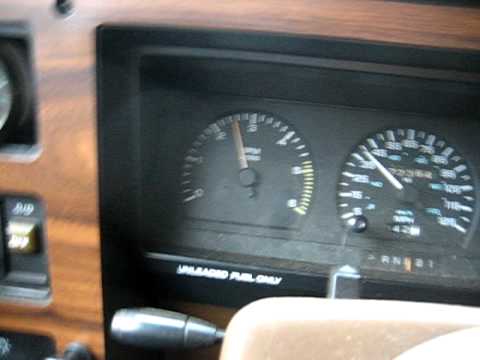

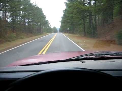

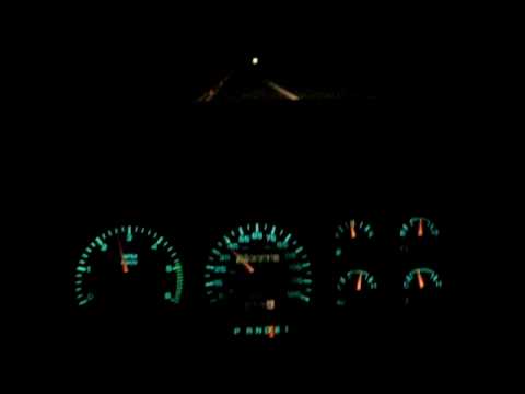

Below are some test of four different trucks. I let them all idle a short time before stating the test as to imitate a stop sign or red light.
The road has about 4-6 feet down grade at the end of apx ¼ mile.
The times are an estimation from viewing the video, also the weights are estimated .
#1 V-10 dodge ram 4WD apx 8000 lb 26 sec 86 hp
#2 V-10 Dodge Ram 4WD apx 13000 lb 40 sec 78 hp
#3 V-8 93 dakota apx 4800 lb 30 sec 42 hp
#4 V-8 93 dakota apx 4800 lb ( different truck from above ) 26 sec 51 hp
#5 V-8 92 dakota apx 4200 lb short cab 22 sec 56 hp
#6 is the above truck before gasification and on gasoline 3800 lb 10 sec 144 hp
I think the best power test will be 40 mph to around 70 mph to give the gasifier the benefit to make a little gas.

I retimed a few of those, you were a tad optimistic, particularly on #3. I count from the time the foot goes down and revs begin rise to the time 60 shows on the speedo or is called out. Looks like 40-50 HP on the dakotas and 70 HP on the Ram. Later gasifiers have steadily improved in HP.

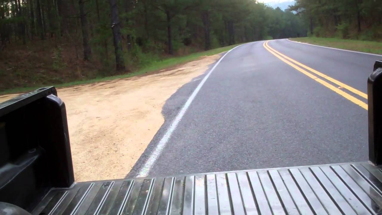

This morning I gave the 92 dakota another try at the 0-60 test.
I found a lose connection on the gas delivery piping that had been pulling in a little air and tighten it but I think it had little effect on the acceleration.
Looking at the video it appears that 0-60 is going to be between 20-22 sec.
For what it is worth my GPS reads 60 mph when the speedometer is reading 59 but I forgot to hook it up this morning and was reading the speedometer.
Sorry about all the MMMMMMMMMM before I said mark.
The gasifier was at operating temperatures and I didn’t let it set before acceleration.
An acceleration test from a dead start is not a good power test for a gasifier but it will give us some figures to cerate a base line.
] http://youtu.be/8Tbt3YHiqPk
