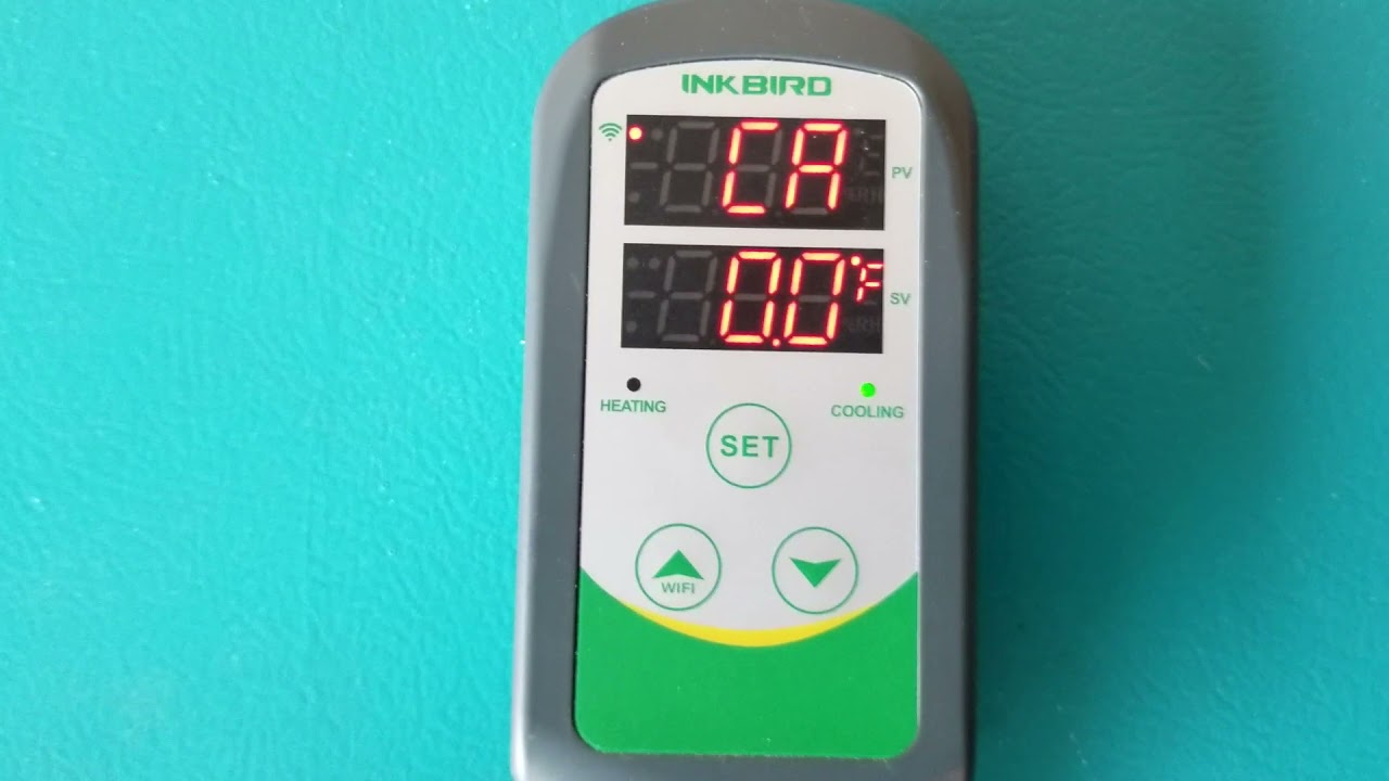

I’ve played around with the Inkbird 308, finally found it to remember the brand. It will overshoot the desired temperature and idle off until it reaches a few degrees past the set temp, it starts it back up as soon as it’s one degree off but it always takes time to bring it back. You can change the differential so if you’re comfortable with a wider temperature band you can program it for that.
