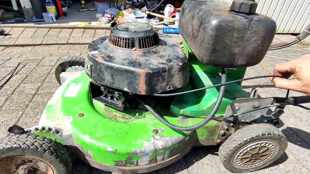

The float wasn’t adjustable. It’s old and brittle plastic. Holds the pin in from the sides, and the bottom. The float itself is attached to the carb, with a hinge-pin. The hinge-pin goes trough cast metal. There is no adjustment possible. However… Was able to push the top part, where the fuel-cut-off-pin should rest against, in further. Now the bowl really fills up.
The throttle plate pilot hole seems to be large enough. And I had this surging issue, with full throttle/no choke. So for MY situation, this throttle plate pilot hole shouldn’t matter at all.
Again, my governor spring was total junk. In the previous vid, I used a rope to keep full throttle. Not using any springs. And I don’t want a governor on this engine, so I wouldn’t even bother trying to find a replacement spring.
Yes, I did read the entire thread you’ve send me, right after I saw your comment.
From what I’ve found in an online manual, it is indeed an F-series engine.
Didn’t take the muffler off yet. Had cleaned the carb already with brake cleaner. It had very limited varnish, although at least one hole was plugged.
The governor spring was junk, so it was broken. I don’t intend to use this as a mower, and I need manual throttle control. So I modified it.
I think I’ve got exactly the same engine currently for my project. And I wanted an upgrade ready, due to the limited revs these engines seem to have. (need to get close to 5500 rpm)
Update video on how this lawnmower currently runs. I call this “fixed”. It for sure needs some more carb adjustments, and a better throttle control. But I’ll be doing that if and when I’ll use this engine for my surfboard project.

I’ve mentioned in the previous vid, that I know that brake cleaner is horrible for engines, especially 2-stroke engines. But it’s what I had to clean the carb, or start the engine.
I don’t know how many RPM’s I currently got from this engine. And I’m kinda sure I can’t get 5500 rpm from it. After all, it’s a lawnmower. But I do think it will rev up higher (safely) then a 4-stroke lawnmower engine. (and it got recommended to me by someone in this thread)
