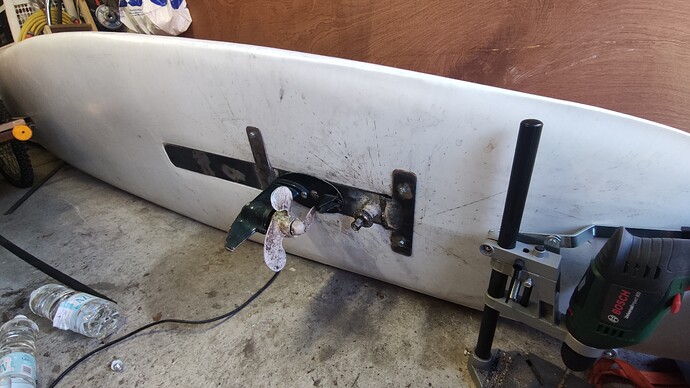

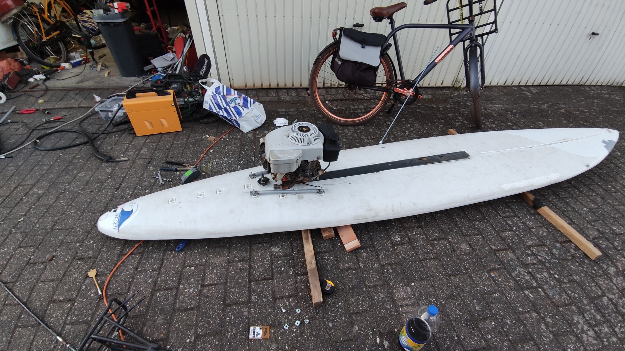

2 random pics of the project so far. They are slightly recent.

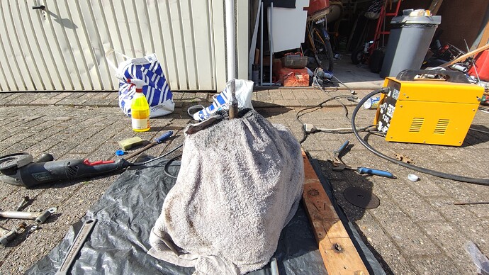

Had the engine covered in non-stop wet towels, while welding. To prevent any kind of damage to the crankshaft bearings and it’s seals.

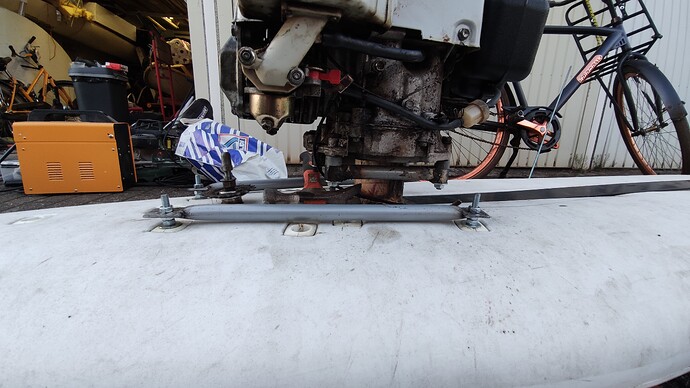

I’m kinda using a stand-off, to raise the engine block from the surfboard. This does increase the “top heavy” effect, but it should reduce the negative effects of a random small wave.

Closer up of the “spacer”, which should create a seal between the engine block, crackshaft bearing/seal and the driveshaft/lower unit. (should also increase the volume of the board, and thus have a bit more buoyancy)
