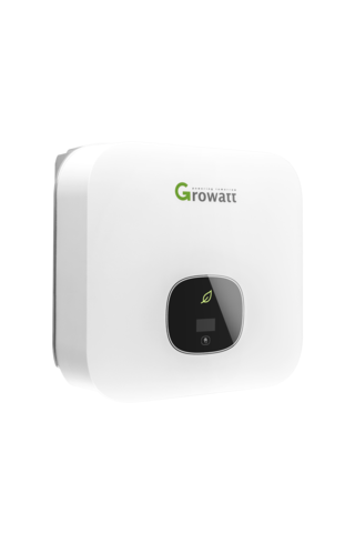

We cleaned the shop and found five more panels​:grinning_face:. Bought a new inverter for €300. Fixed some stands for mounting in front of the rainpipe. On the roof is room for three more and then it is all full.

New inverter for €300? They are here for at least 5-10 time more. For example this one is hybrid with decent power GoodWe ES 3648 | Solar-Eshop
Hybrid is more expensive. Got a Growatt 2000 W for these. €304 ex shipping. Goodwe is a little cheaper.
Ok, such a baby would go for €550 e.g. here GoodWe NS - 2 kW | Solar-Eshop. Stil almost twice your price.
Sorry. Goodwe is more expensive. I thought the other way around. A newcomer with higher prices. I will stick to Growatt, i have more inverters. The same system is better for monitoring.
No connections with this club, just needed an inverter fast.
One mppt tracker in it. No need for two, better save some bucks.
