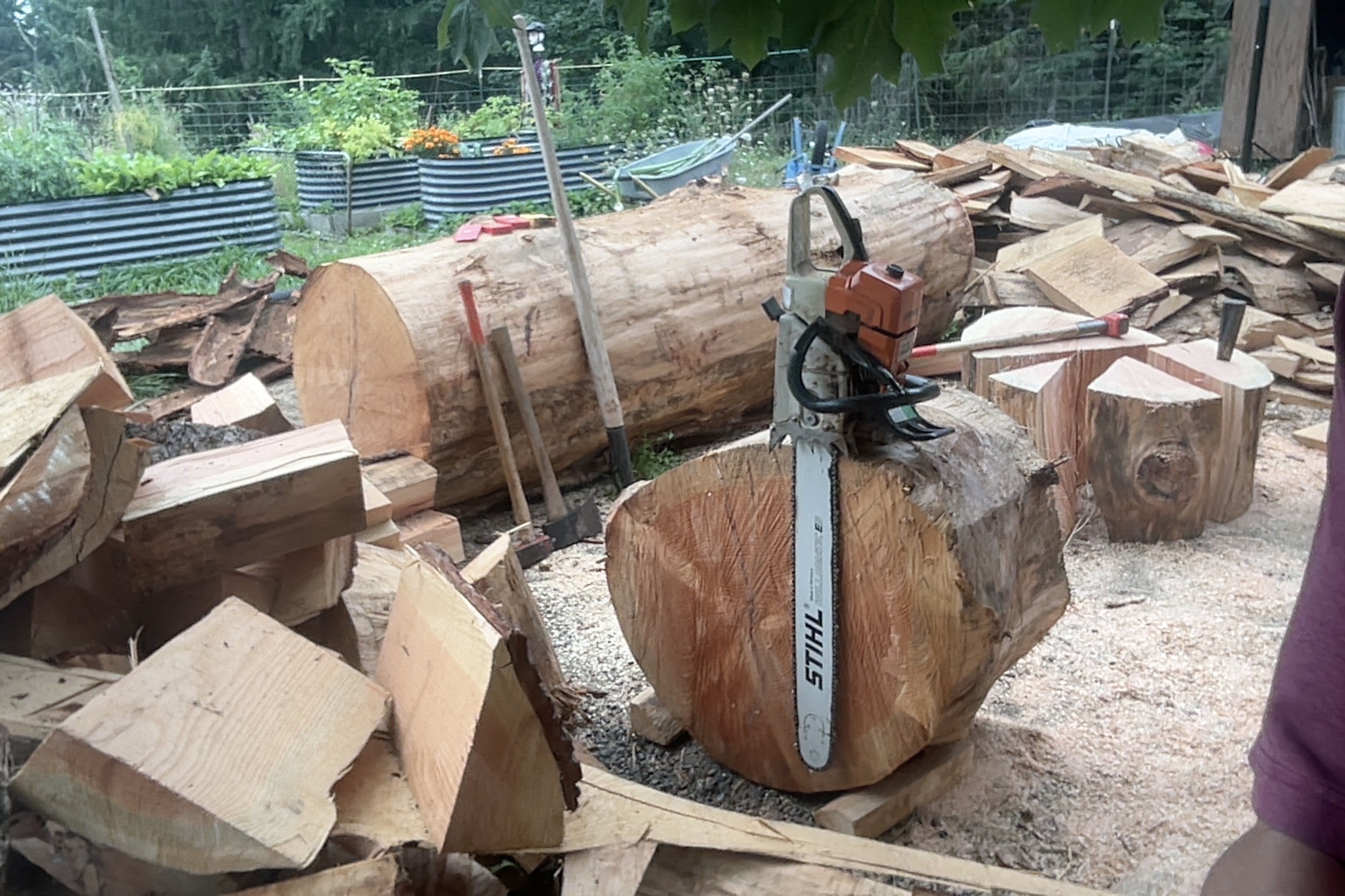

In any way you will have accumulated visible stacks of acquired woods. Even electrical saws make noise, and dusts. Even very narrow kerf band, or reciprocating saws will make accumulated piles of fine sawdusts. The gasifier operating engine and gasifier itself will make new many hours duration noises. Have sometimes some visible emissions. Will have accumulated liquids, residue ash: and from the assemble packing crates accumulated fastener metals. Neighbors will complain with their fears . . . and their jealousies. And these happen even within families. My wife is much concerned with me now at 73 year out operating gasoline chainsaws. Engine driven wood splitters. Sweat breaking down logs with steel wedges and hitting mauls. (Keeps me young)
