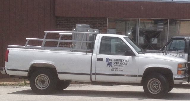

My first ride in a woodgas truck was a chevy . Now owned by Chris Sanez. Other Chevy owners that come to mind if I recall correctly so don’t flame me to much if I’m wrong. Andrew Heath,Paul Halverson, Henry Austin, Tom Collins, the late Mike Larosa.

Was referring to build info on the Chevy vortec. It was quite a project and not kidding about routing gas to the engine being an issue. Also we were fortunate to have a quite young fellow that knew how to get into the vehicle computer and change things around. That is why have a hard time remembering if the MAS was ultimately used or bypassed. It was done both ways for testing. Not sure how it was set up when it actually left the shop.
