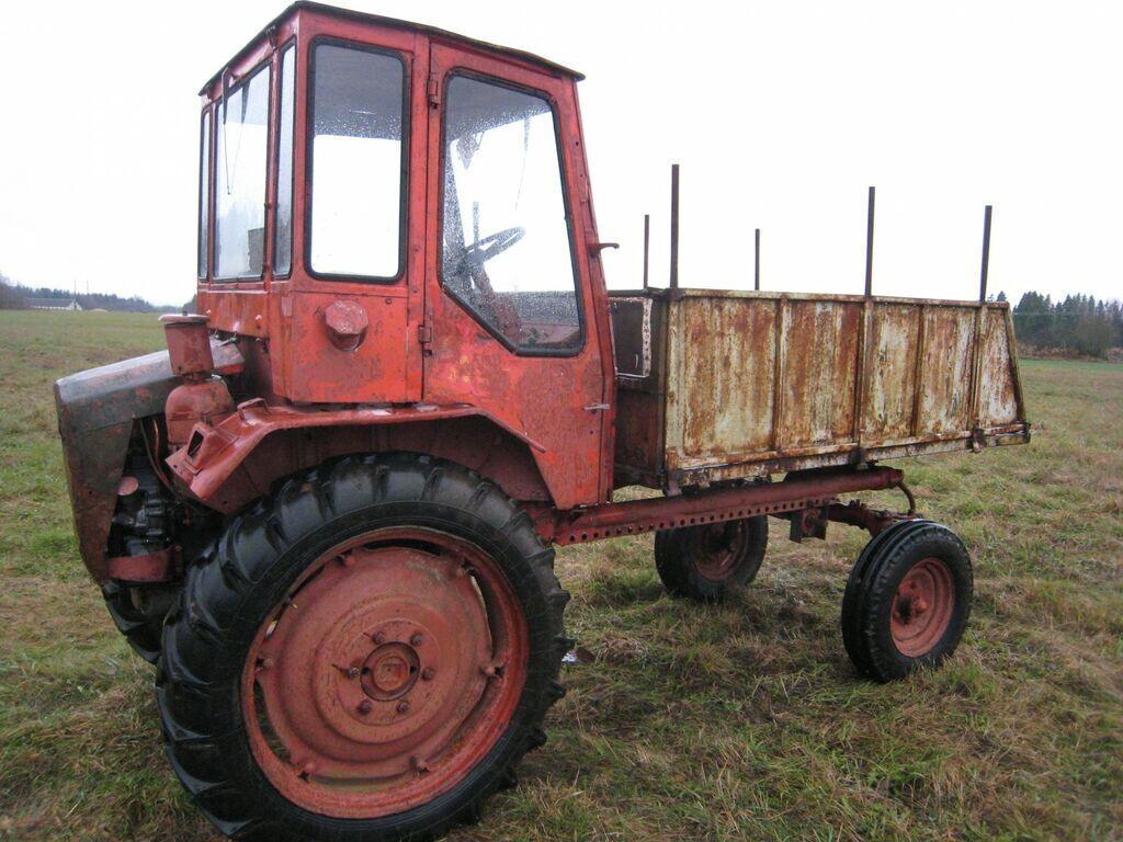

I like build a tracktor , drive on charcoal.
but need first make a good proces formake charcoal.
This can be a good tarcktor too start.

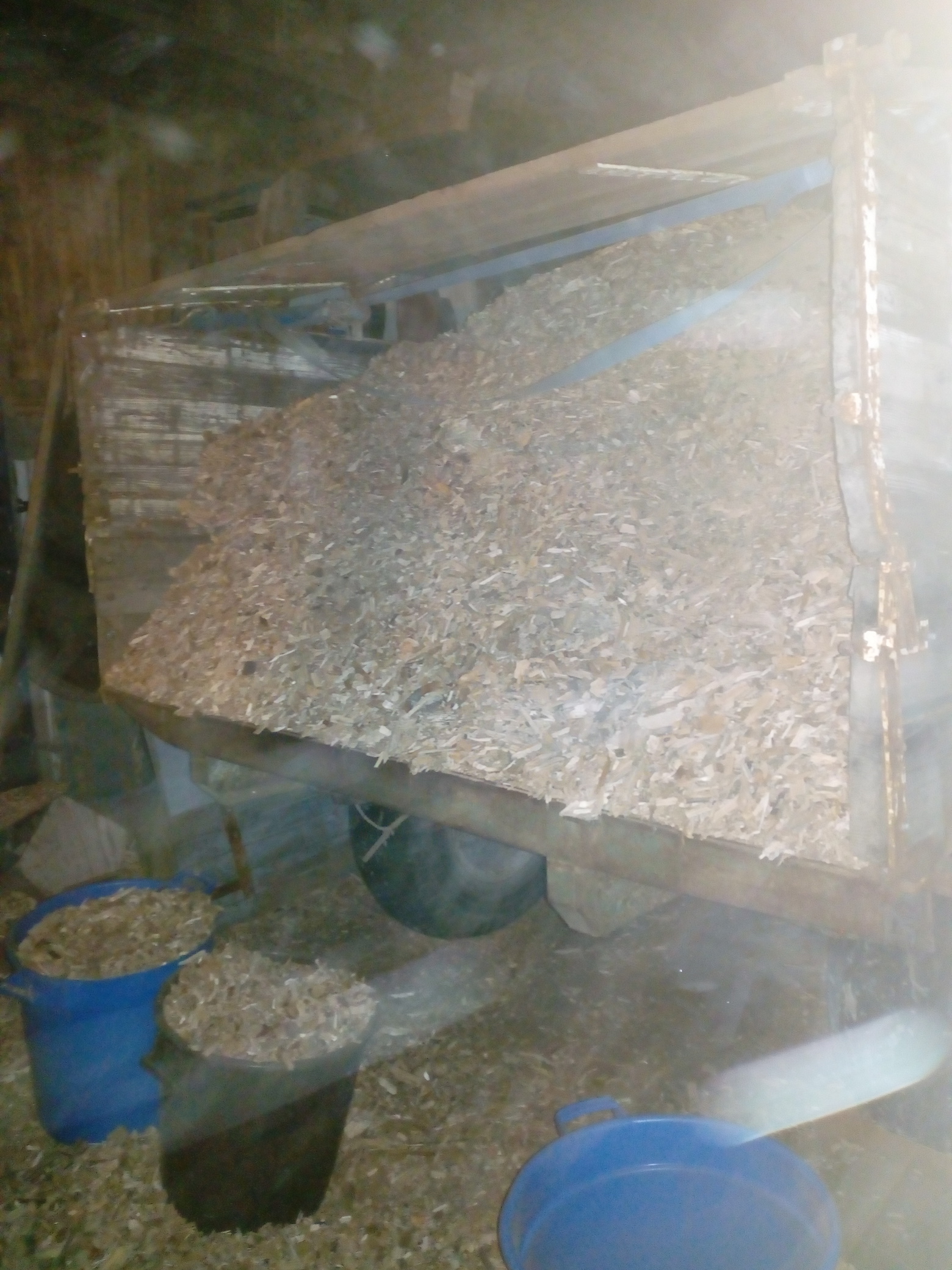

sorry about the wood, i live i me forrest, but neighbour make the woodchips.
you can also use Fuel wood pellets.
i warm me house for long time , using wood-chips

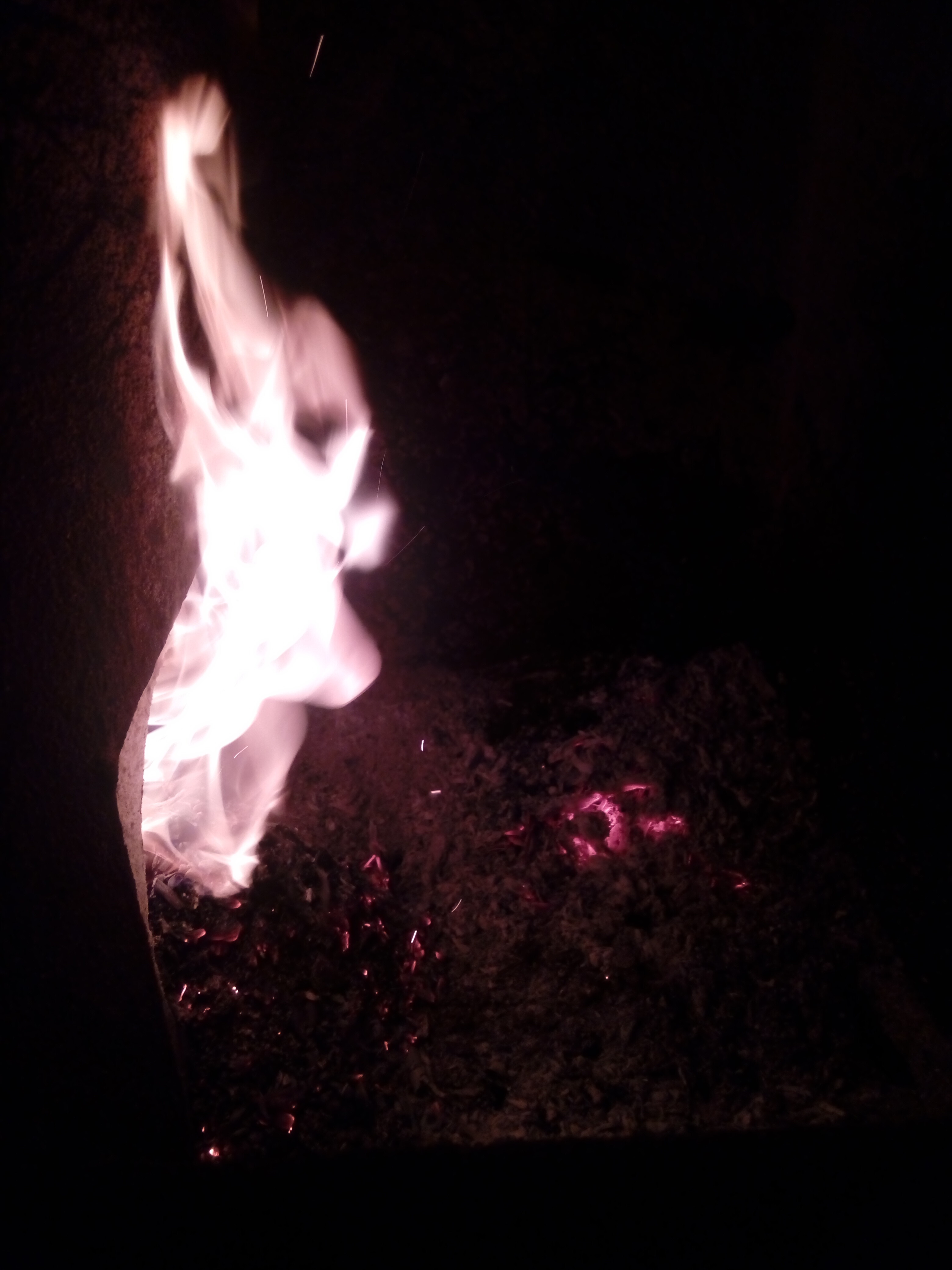

and observing the process , burning flame …

Haapio, nice chips you are getting. No leaf. No needles. Bark content consistant with limb and twig chipping.

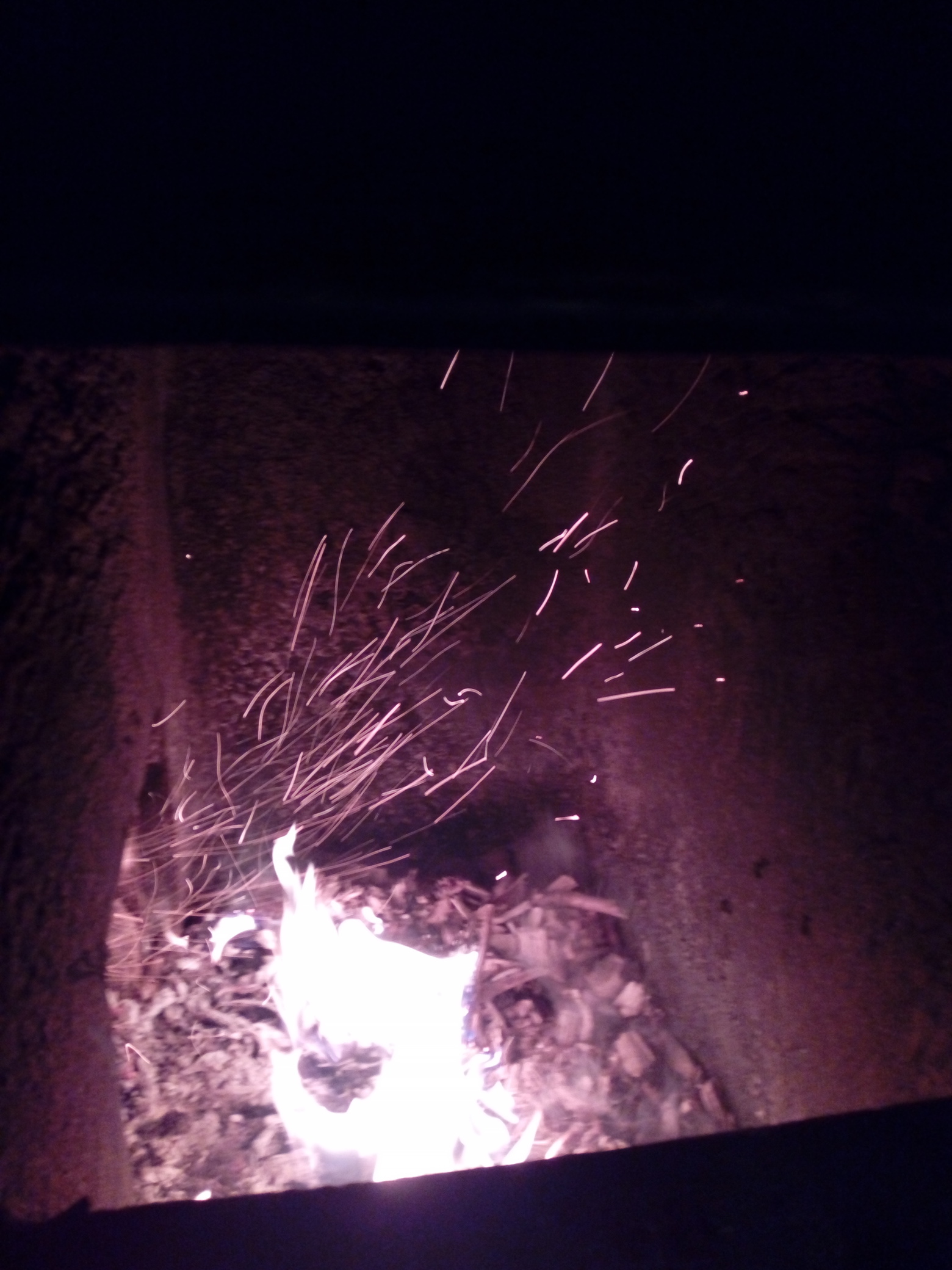

You show a burning picture below.
IF this is in an airtight closeable fire box here is a technique.

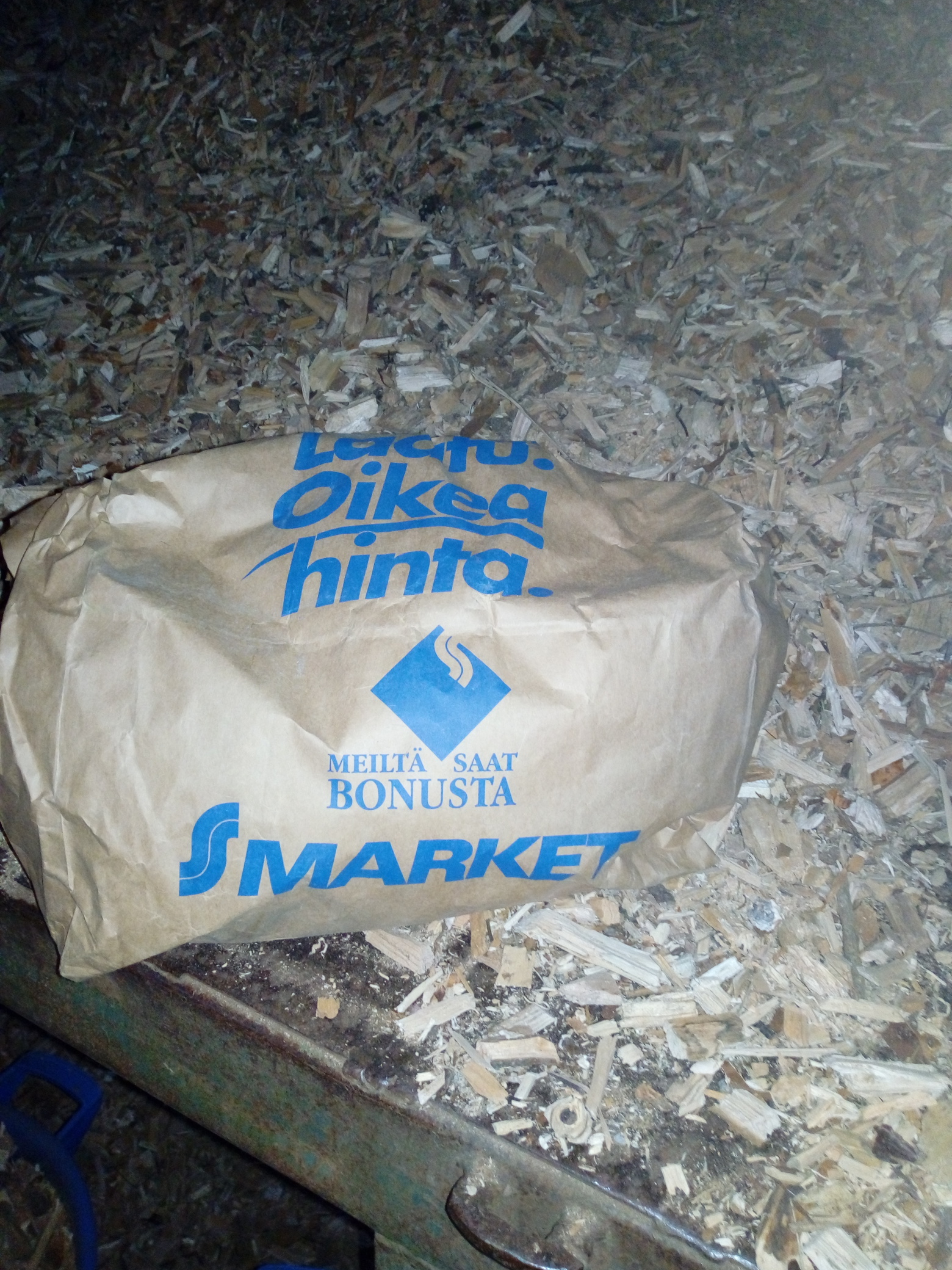

Put 2 kg into brown paper sacks rolled up tightly.
Place these one at a time onto an existing hot bed of wood charcoal. The paper sack will keep your fuel-lump intact until a blackened outer crust is formed. Then the heat will outgas your fuel wads pyrolosis oils and gases out through this outer burning hot crust. Do not poke or disturb this slow release process or you will break your char skin getting smoking. without the reduction complete combustion.
Close couple woodgasification and full no-smoke combustion of fine wood chips and sawdust.
Done right in a large enough scale you can use up to 40% moisture wood chips/sawdust.
