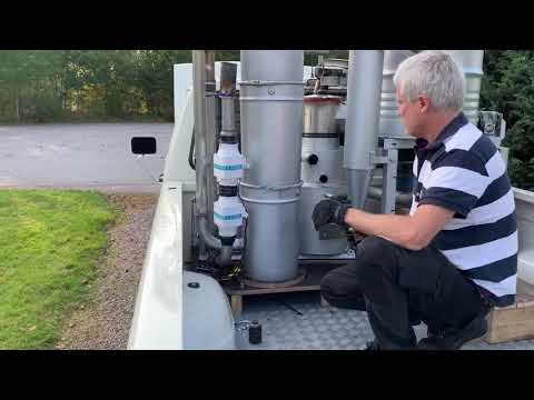

It’s got a V8 6.4l 392 but they say it can run it based on the v10 5.2l gasifier. I think I’m capable of building it I have 3 boiler tanks and 1 large propane tank and a smaller tank plus a lot of other metal. I’ve been reading all sorts of threads on here for at least a year or more, Ive watched almost every video on YouTube about gasifiers even in other languages. I wanted to make sure I knew how they worked and if it seemed worth the start up time and going and getting the wood, but from what I read I figured I probably could do it. I know I need to avoid pine even though it’s plentiful up in the mountains, I think I can get oak and maybe other longer burning woods. I thought about making a briquette making machine so I can grind up charcoal or wood shavings to make the right sized fuel. I understand they are sensitive about the size chunks of wood they burn. I figure the truck isn’t aerodynamic to begin with so I could just have a big gasifier sticking up and it wouldn’t make a difference lol. Especially if I put the cooling rails in the way or something. I remember I saw one gasifier on YouTube powering a Ford and it had a separate firebox from another country. I was just wondering what might work or not.
Yes this one.
