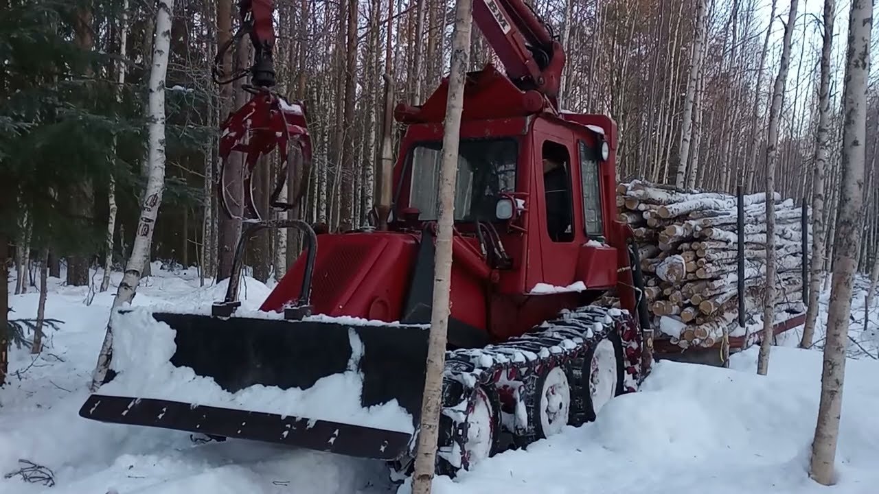

Not a solution to you issues Jan but YT put this in my TV. I knew it was Swedish because of the dots above the vowels. (yes, I know they are Umlauts. I used to badly speak German.) That was before I saw it was Volvo. Of course it reminded me of you.
A nice machine, I’ve had something similar but a Fiat, quite heavy, because of the iron straps, and it had a steering brake.
It was left out a little too long so the engine got stuck, and I didn’t dare drive it on our svamps because of the weight.
