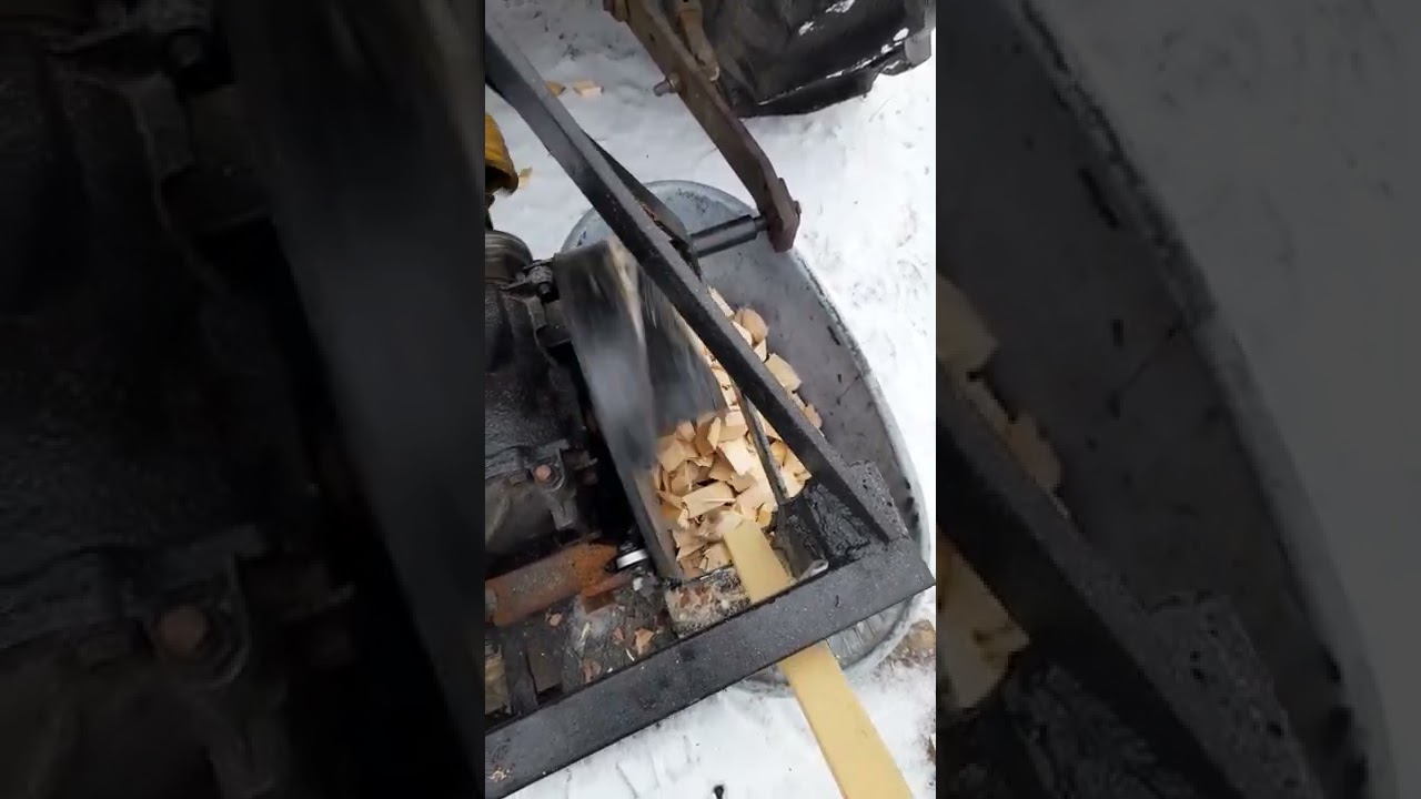

Jan,s little chunker
I have redone the chunker a bit as JO said, have put ball bearings behind the disc as support, and a support on both sides of the knife.
It cuts the wood better now, but makes very small pieces, it looks like it breaks the pieces, the wood is dry so I do not know if I can make it cut better?

When you cut dry boards, do they look like mine too, look like it is crushing the wood?
That’s how my dry wood looks most of the time, but if you rotated it 90° some of it will shear better. The grain direction seems to make a big difference on how my chunker cuts
Thanks for the answer Marcus, yes I also noticed that they cut better sometimes when I turned the piece 90 degrees

Jan, l think you will see this is the best possible wood you can have!
I chunked last night and left the wood outside to get some moisture on it. Yes chunked a lot easier, I can’t wait to get some actual green wood to try. I have found my chunker can lop a pine 2x4 that is dry, I think I’ll be able to chunk some pretty large green stuff. I think a lot of my slivers/small chunks are from being dry the wood fractures so much it can fall apart. So with damp wood yesterday I chunked everything a little bigger and got a lot less slivers. I screen it all as well and less then half a bag of the fines from 12 bags of chunks. Where before I filled a trashcan probably close to 6 bags of fines from 16 bags of chunks

Just chunk them a little longer for some bigger pieces mixed in.
Back a decade ago I was at APL in Berkeley CA to work on their Olathe disk chipper. Once I got i running, we put a 2"x10" pine plank into it. Out put was small and a lot of tooth pick like splinters. The dried lumber would break into many pieces even though I sharpened the hard knives and shimmed the anvil to be very close to the knives.
Chipping wood that had more moisture in it worked better. Green wood worked very nice. The green wood cut so much nicer that it was what was desired to be used.

I think the most important thing is not to have too much material in the knife, I have 4mm (5.32"), but I usually don’t take more than 2".
I made mine from a sheet metal, couldn’t bend anything thicker.
