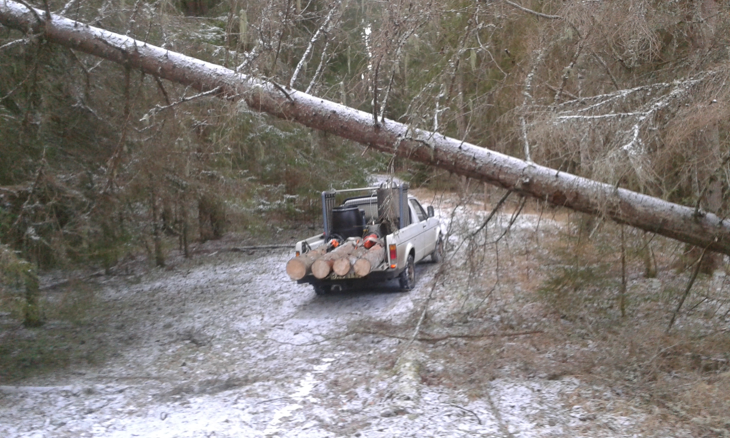

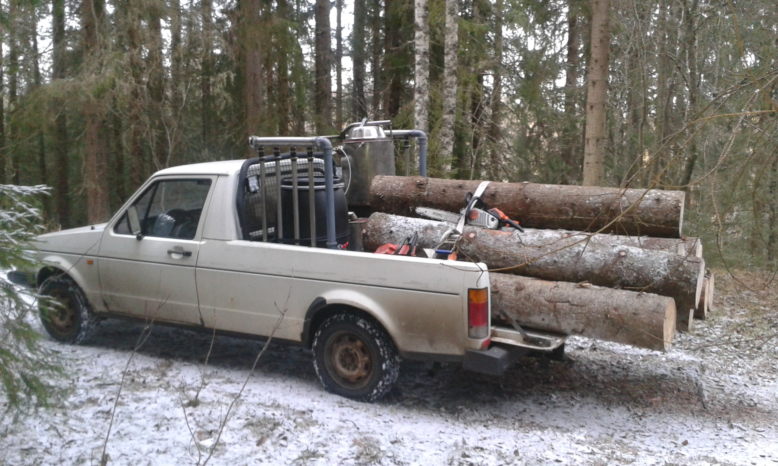

I already collected more wood than I can handle, but recent storms seem to belive I need even more.

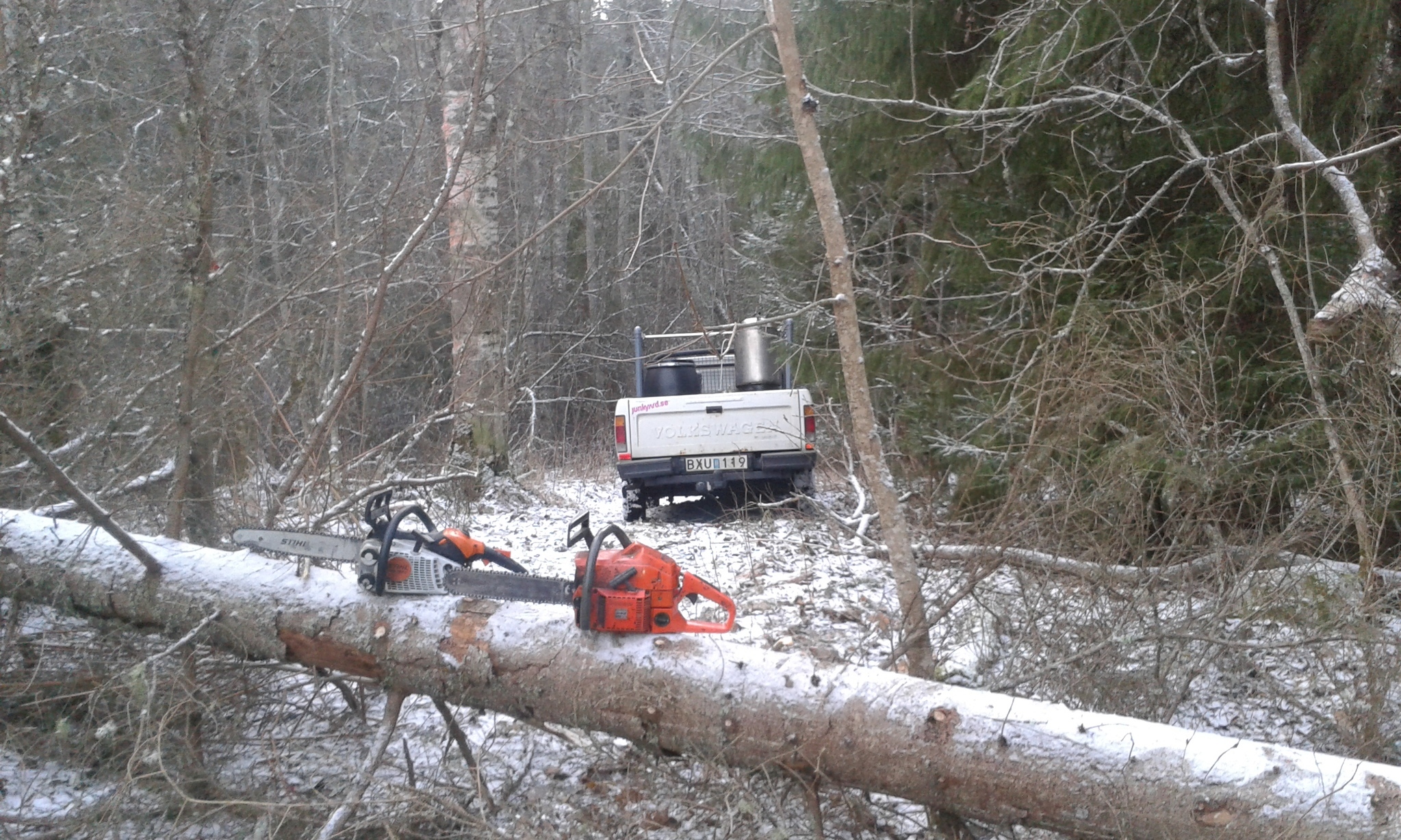

Girls riding their horses and walking their dogs reported a couple of dead spruces blocking the trail on our property.
WPRF (Wood Powered Rabbit Forwarder) came to their aid.
Poor rabbit :smile: his back feet seem to be a bit flat :wink:
Will this be for firewood or planks?
Do l see a Hosquarna 061 in the picture? Good saw. We have two, just replaced thepiston and clutch a few days back.
Those are dry, dead spruce logs. Goes on the firewood pile. Both swingmill and gasifier like a better diet. Boiler doesn’t care.
Husqvarna 242. I bought 2 of them used 25 years ago for 25 €/$ each. I have changed only ropes, chains and swords. Never even pulled the plugs. They run like clockwork. Fantastic saws.
The little Stihl was a present from my father in law. Very light veight, good for delimbing.
