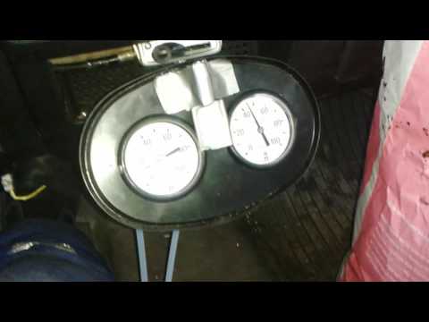

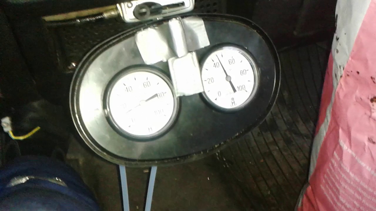

I made a video for you today. I get the feeling you think I’m exaggerating the idle ability.
I don’t want to sound tiring but I really believe the reasons are lots of preheat and accumulated metal heat.
Good morning Mr. JO
Thanks for the video .
I am a believer :blush:
I have videos of my V-10 and 92 dakota when they were new and tight idling for 20 + min and then accelerate.
Preheat and metal .:grinning:
Thanks, Wayne. I never doubted your belief :smile:
