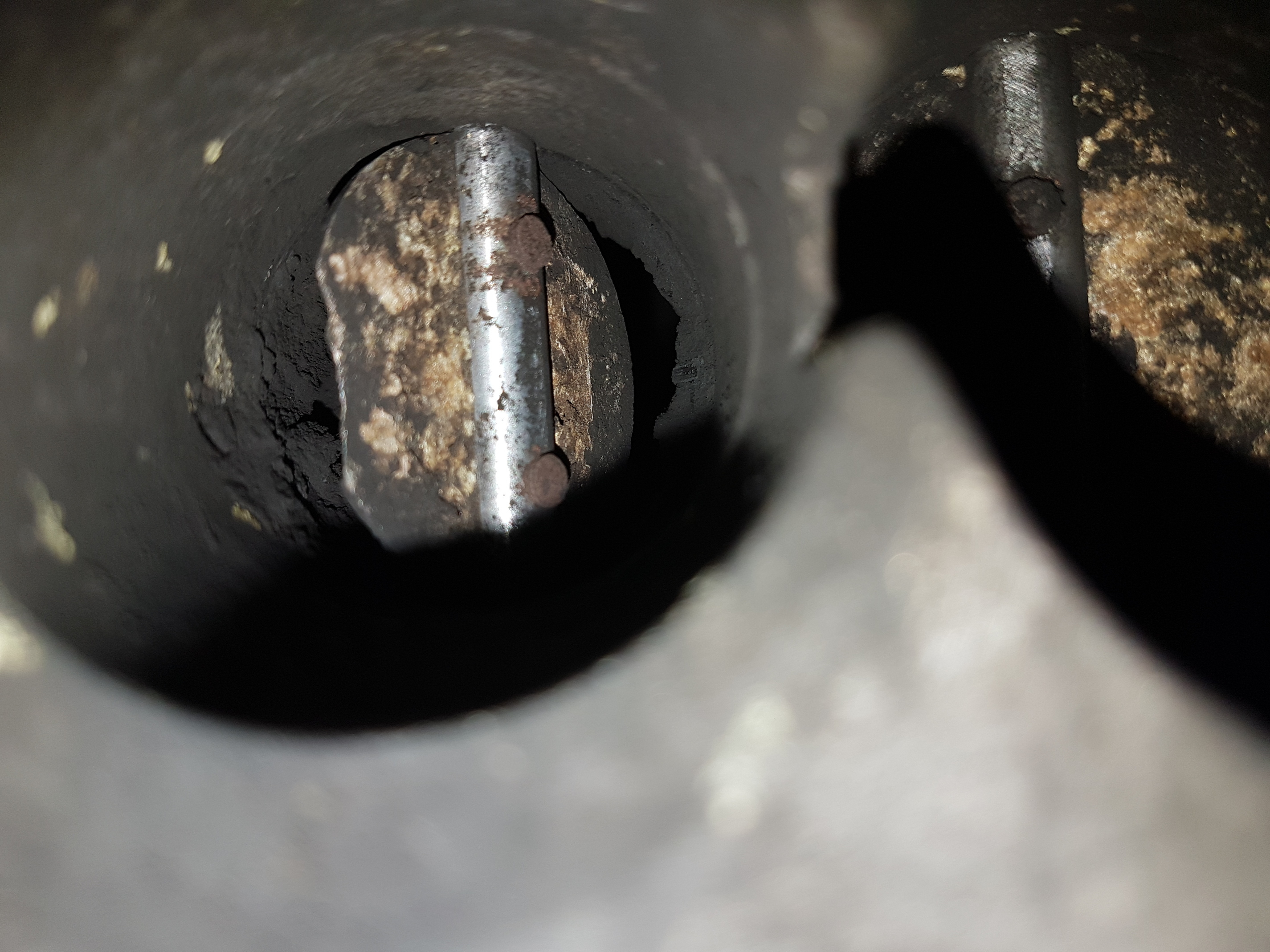

If that does turn out to be the case, I would try building new edges on the TB butterflies with epoxy, then reassemble, let the butterflies close , should form a perfect seal once the epoxy hardens. If too messy or difficult epoxy could be applied to the butterfly edges with a toothpick or other tool. Likely a release agent like oil or silicone spray will be required on the throttle body.
Once hardened, disassemble, and smooth flat surfaces.
I would try something like Permatex steel weld, resists up to 150C.

I thought you had plastic butterflies. They should not corrode. Only the metal stem would corrode then. Maybe that is what happened.
edit: I just noticed you slipped tb in there. so disregard my answer.
I have had a few butterfly shafts seize up in the body , only way I could get them unstuck was to strip the butterfly off the stem and drill under the stem a small enough hole to tap it out , my gas is nearly always clean ,so can only thinks its corrosion between the 2 different metals causing my problem .

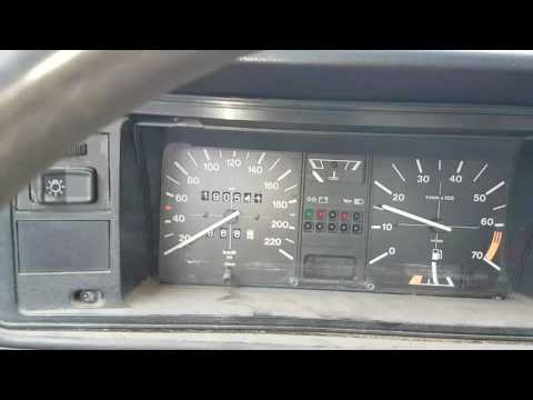

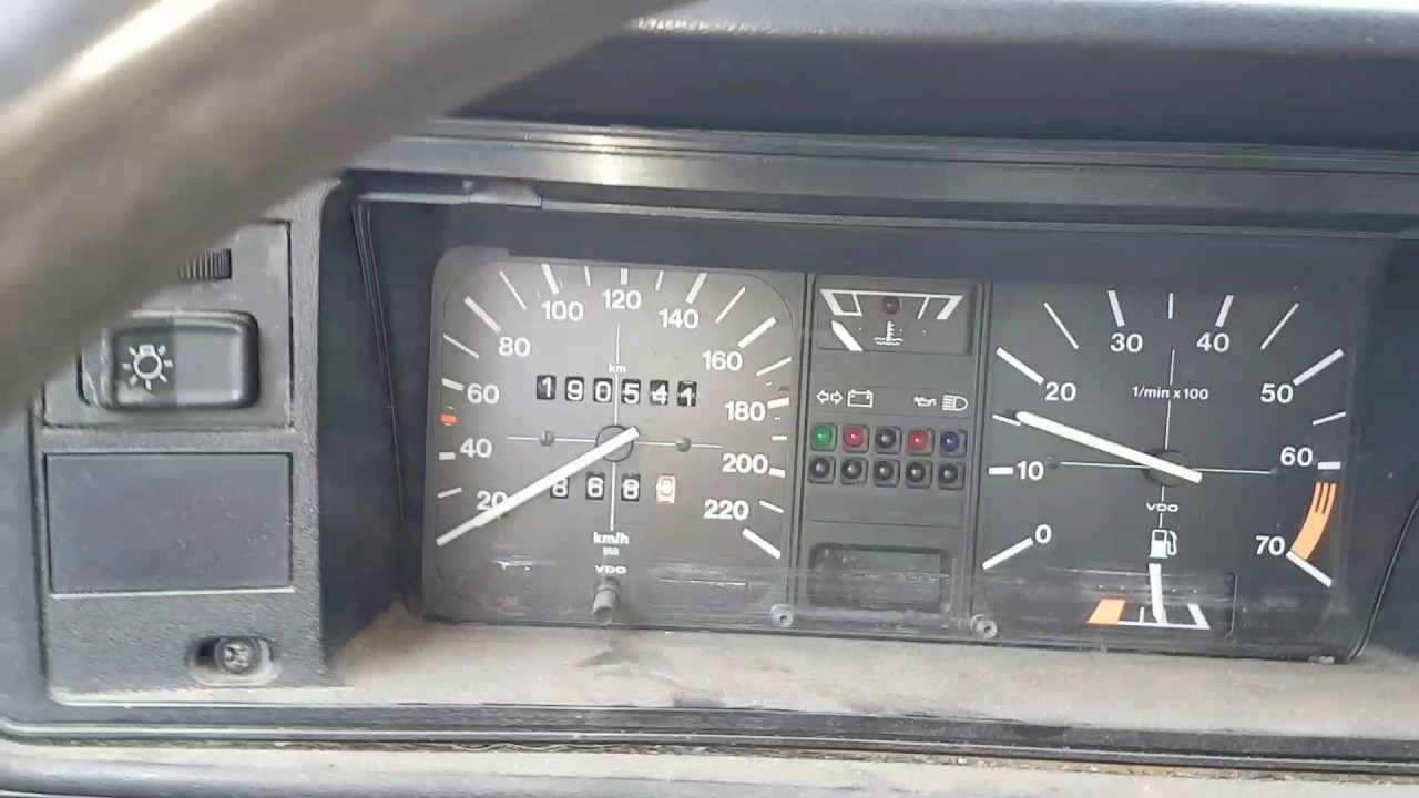

I can keep the woodgas idle down around 800 rpm again. On gasoline I have to turn up the idle higher not to stall. I’ve always had ruff gasoline idle.
However the smallest brass butterfly does seem to be affected by corrosion on the leading edge.
Is the cavity on the left butterfly flap stock or is it corroded so much?
Hmm brass and iron/alumunium dont get along well in a wet enviroment. Galvanic couple…
That’s what bothering me. I can’t remember seeing it before. The only photo of the tb is back in post 316 almost a year ago (right butterfly on that one, since the new new photo is upside down again ???) but it doesn’t show much. You might be right on the galvanic process. It’s a very uneven edge. Seals a bit better when things carbon up :smile:
I was jumping up and down on the last year/yesterday pics and l have to say l vote for the thing to be new.
Now, my thods are since a small peace broke, is it possible for a biger peace to broke and damage the engine?
Hope not, we like to see that rabbit running :wink:
Hm, maybe you are right. Maybe it is broken.
Well, let’s DOW, SWEM and hope for the best :smile:

Ever did a 0-80kmh acceleration test?
Timed myne today at about 50s.
Haha, I have. Just never timed them. I’ll get back to you :grin:
Kristijan! Here we go.
It seems the -91 VW Rabbit has about the same acceleration on wood as a WW2 28hp VW Beetle on gasoline :smile:
0-80 km/h in about 35s (12-47s in the video) as far as I can tell.
