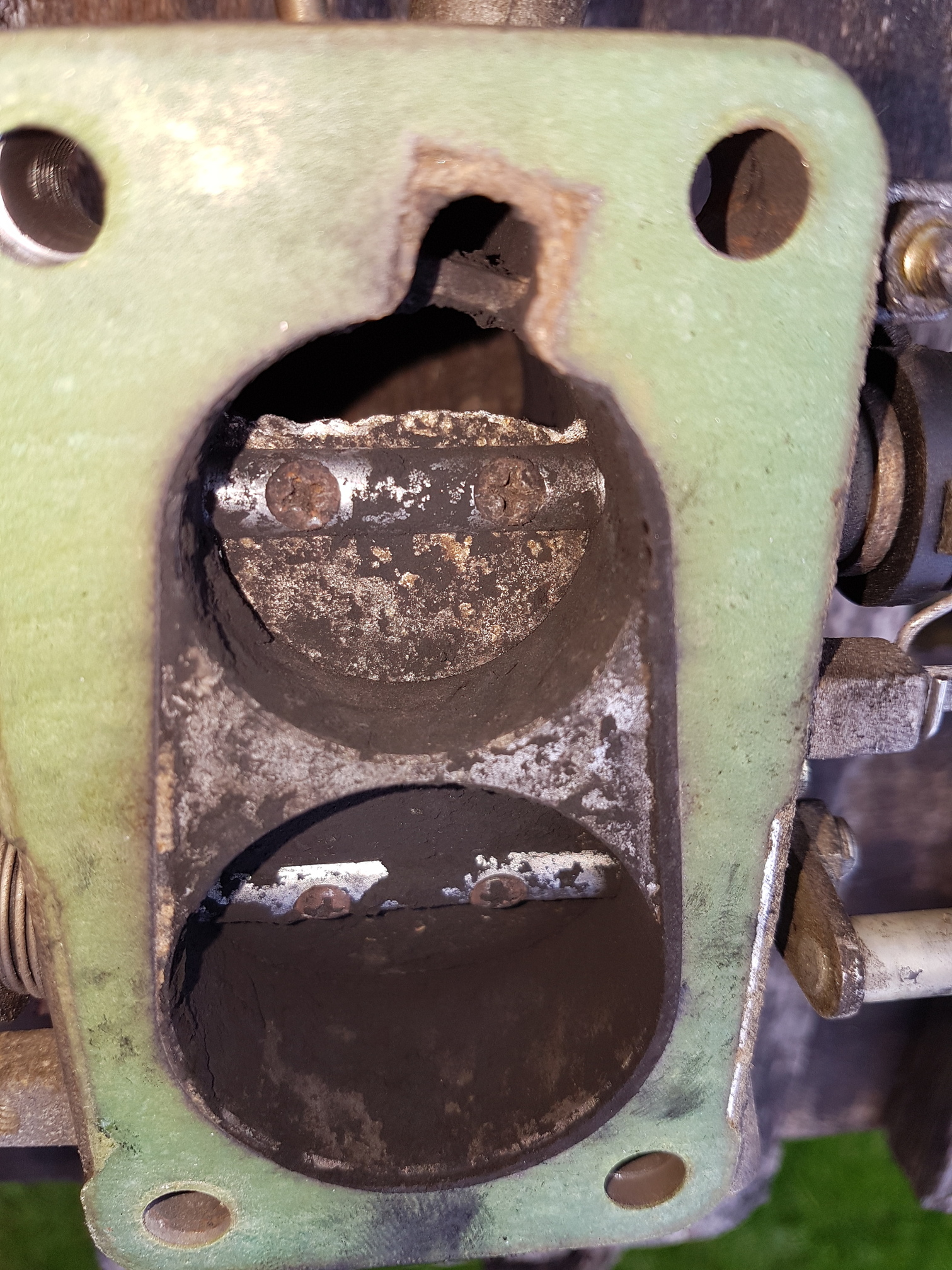

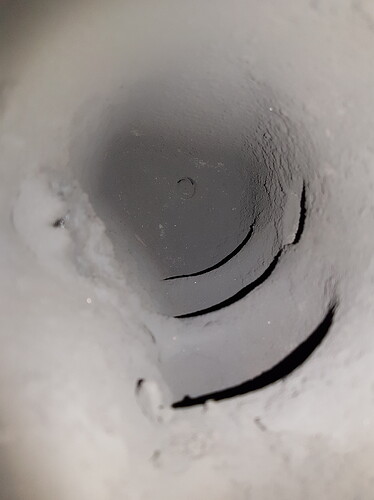

After cranking up to go home everything was normal, but when shifting to second gear the engine started to make a ratteling noice and revved 5000 rpm before I managed to turn off the ignition. I saw a cloud of smoke in the mirror and my first thougt was a normal intake event.
I switched to gasoline and cranked up again. The ratteling was gone but still extreemly high rpm. I opened the hood to see if one of the throttle plates were stuck open. No, both arms where in closed position??? Opening the tb rubber connection revealed the truth. One third of one of the plates were gone. It probably stuck an intake valve open, started the intake event and then blew out the exhaust valve.

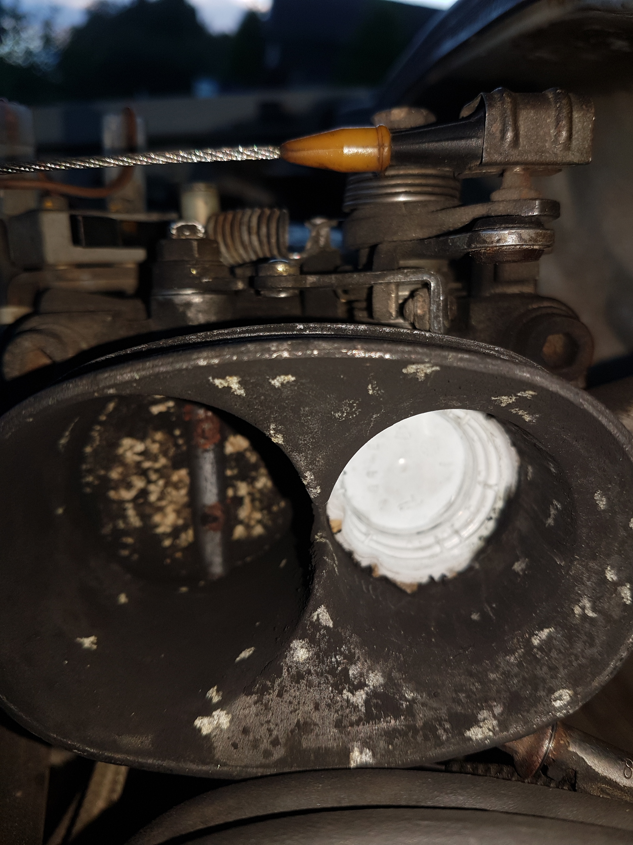

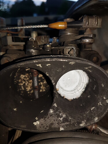

I found an empty cardboard juice can with a plastic lid in a bin at the parking lot. I cut the lid out and it fitted right in the throttle channel, tightened the cable to get an idle opening at the second plate and drove 10 miles home with no further issues.

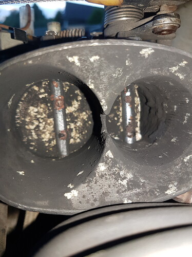

Woodgas obviously corrodes my tb plates.
I’m thinking of fabricating new plastic ones. I just hope that piece of metal didn’t damage valves or seats.

I think my plates are made of brass. I just read brass are quite resistant to corrosion except in ammonia enviroments, where it develops cracks. Spot on my suspicion.
Brass being copper and zink I hope that piece was still soft enough.

I wasn´t thinking straight writing that plastic suggestion. I have to be able to use the torch on the plates
I will have to try to fabricate ss plates.

Harsh to say, but this is mainly a result of wet gas, and is avoidable with proper
end-treatment of the gas!
That is wet under vacuum, if not earlier…
The end-treatment has been repeatedly described, but usually neglected as “unnecessary”… doing it “the American way”… until!

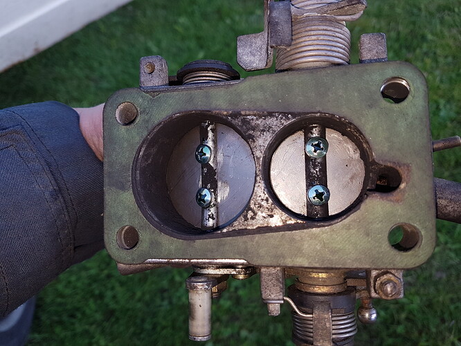

I haven’t done any investigation yet but even if new plates are avaliable I think I’ll first try to find a complete tb at a junk yard. That will buy me some time and the oppertunity to take a proper look at my old one.
Thanks for the paint tip. Torching linseed oil crossed my mind. Paint might be easier.

Yes, by all means get a spare throttle body. Maybe with a lot of cutting and filing you could make a replacement plate (plates) out of thin stainless. Looks like you would have to take a mini-grinder (Dremel tool) to the rivets holding the plates. Rainy weekend project!

I´ve been DOWing every day with one broken throttle plate plugged with a plastic bottle lid for the last week. Only using the bigger butterfly is ok but a bit sensetive.
Today i visited two different junk yards, but no luck on a similar tb. Downside to owning a rear beast. Made a couple of other finds so the trip vas not totally in vain.

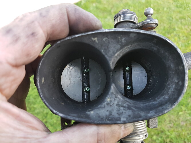

Back home I decided to grab the bull by the horns. Night shift today, so all day off. Stripped the tb and fabricated two new ss plates. I didn´t get them 100% true. About 1500 rpm idle right now, but those small gaps will carbon up in no time.
