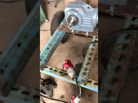

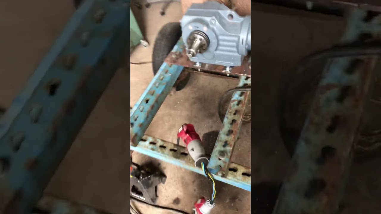

Testrun today. I was a bit eager to try so the knives are a little too long so they are now slightly overlapping.
In the end I was saying that the chunks come out 2 - 2 1/2” and the thinner ones up to 3”.
A bit hard to put the plug in while filming :smiley:
