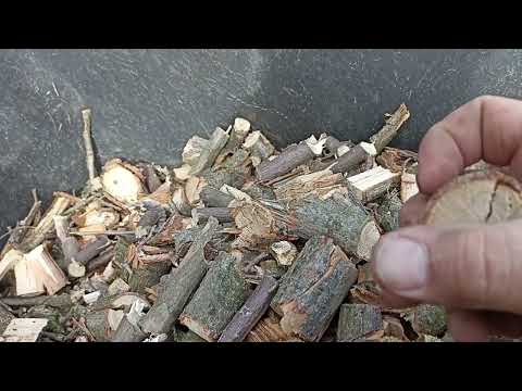

Something like this but there is no subtitles unfortunately
Hi Johan, i belive this guy on youtube " Made in Poland" has built one of the single rotors rebak, as i remember he has subtitles?

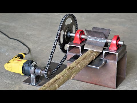

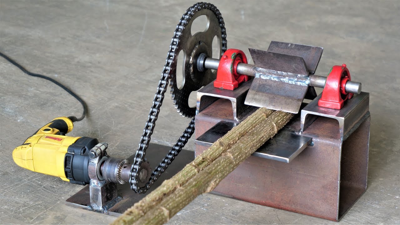

Here is the low budget version. :rofl:
The wood in the still photo at the beginning looks a lot like sunflower stalk. The chopped pieces at the end look pretty pithy too. It’s clever, but I’m thinking oak’s not going to happen, and maybe not pine or cottonwood either.
I agree. It would need, at the very least, a stronger motor and safety shields. I thought it was some species of bamboo.
