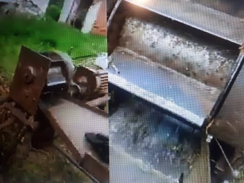

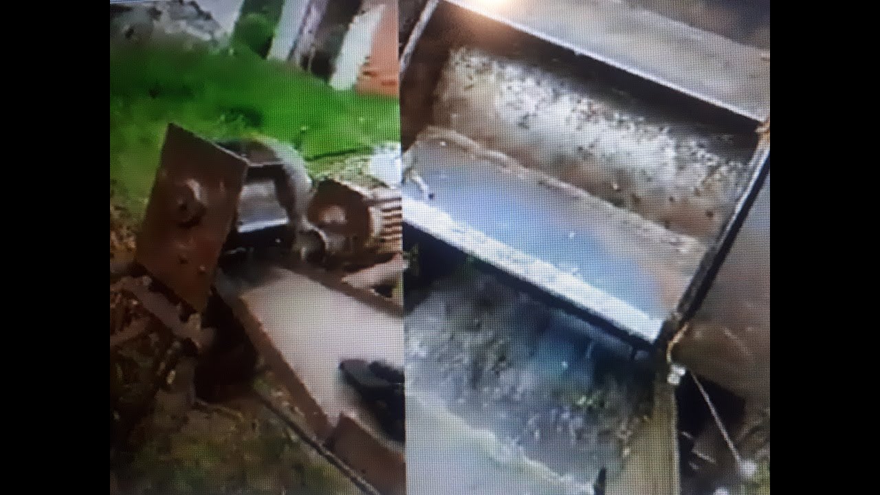

Is it something like this that you intend to do now?
It seems to work well.
The rebak itself will still be the same now, the change will be the safety shear bolt (in case someone throws in a metal rod or something
It will be something like the flange coupling in that video but only a 6mm bolt holding it together so it breaks and saves other things from breaking.
Edit. A 6mm bolt to start with, if that breaks easily I can put in two or go for a 8mm bolt but I think that would be a lot.
