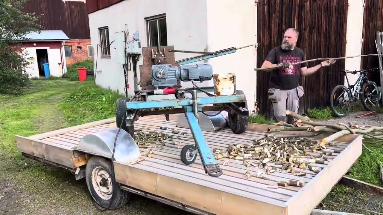

There is a few things still to do but in essence it is done, here’s the first chunks coming :blush:
I put it on top of the chunkdrying trailer since the shoot out of the rebak had to be re-done, I removed it but chunking has priority. Right Göran? :wink:
My wife had to act camera(wo)man :smiley:
Hahaha, Ihad almost forgotten that one :smile:
That is a very civilized machine Johan. Not scary like a lot of the chunkers. Very nice.
Thank you Tom.
There is a little adjusting needed on the knives still (plus protections), it sometimes does have some fibres still stuck together so they are linked together, not sure why it is only sometimes. Perhaps a certain wood species with longer fibres.
This was aspen, rowan, alder and birch chunked.
