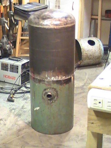

this 39" tall bad boy don’t look like much but it has all the high tech, low tech goodness I can throw at it…
Just need to make a bottom flange, install the grate, finish the lid, do the final outside welding and i can put some fire in it… hopefully this weekend…

LOL… camera is always charged… if I get it buttoned up I’ll make a vid of it flaring… Hey T, I found another thing that ejector is good for… cap the outlet and I can pressurize my air pre heat dodad… My welding must be getting better, only two small pin holes… could barely notice them with 20 psi goin on… My threaded joints on my ejector leaked more.
Looking great Arvid! what is the diamter of the piping you’ll be using? 2-inch?
Thanks Troy, the tube you can see in the pic is the air inlet… it’s 1 1/2", and yes i’ll be using 2" for the gas outlet through out the rest of the system to the gas/air mixer…

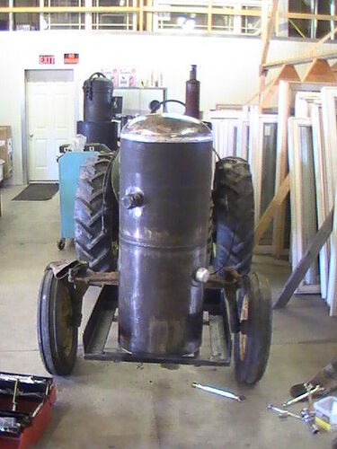

Slowly coming together… all the main welding is done… grate and bottom plate are made… just a cyclone and final filter and then i can plumb it… soon… I hope… soon…
That’s very professional looking, Arvid. Great to have all that room.

Can’t wait till it’s done
Go’in to be very exciting to see this tractor chug to life. Somehow, it always seem quicker and lighter when we are building it in our minds. Looks clean, your not going to want to give it back when finished.:-\ Dan

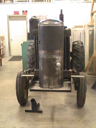

What are the “wings” for by the front wheels, Arvid? Maybe to create some lift to take some weight off the front wheels?
LOL… thanks guys. The steel is just a piece of flat stock to help position the rad for pics… haven’t gotten the mounts built yet… they won’t be there when it’s done…

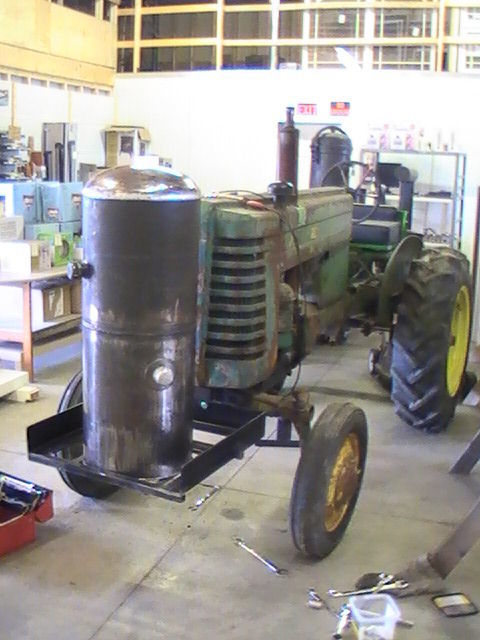

It’s great to see other practical applications to wood gas. Thanks for sharing these experiences with us. I think the wide front end is more conducive for the distribution of weight than the narrow front ends when one gets into deep mud and snow. It will definitely keep the front down.
Looks good Arvid, you kept it tucked in nice so to not loss to much visability.
Gasser sitting where it’s supposed… Cyclone should be done by tomorrow and then i can start laying out the plumbing.
