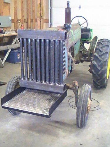

I’m hoping to have all the major pieces done by the end of the month… that will give me 3 weeks or so to get it all plumbed and tested… here’s hoping…

On my cooling rack similar to that I eventually welded nuts in line with each pipe and made a needle nose fitting for my pressure washer to wash the soot out of the cooling tube.

Gas will enter on the right side bottom and exit left side top… Baffles? kinda… tubes on the right side extend into the bottom manifold some what more than on the left side… lol… cut a bunch of tubes and then realized they didn’t need to be that long… but so far the gas flows from bottom to top.

This tractor has a fan in front right? So that way it should also pull air through your cooling tubes as well, right? Is that why you put the cooling tubes on that side?
Yup, that’s idea Bill. Also i seen a picture of an old tractor that i’m kinda copying the layout.

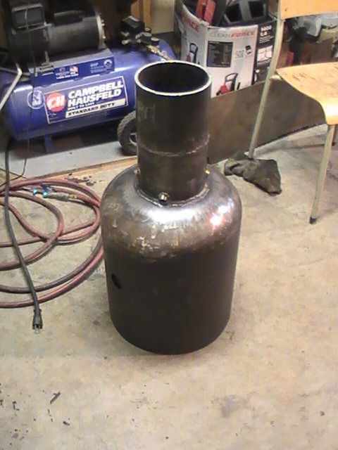

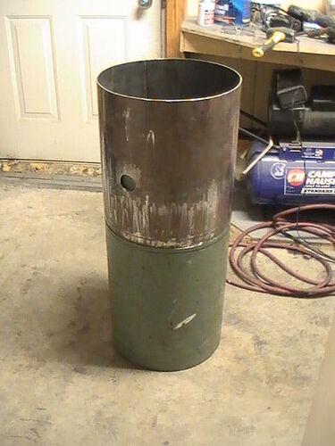

I know it don’t look like much but finally the gasifier body is starting to come together… condensate gutter is welded in. This will be more compact than our preproduction unit… It will have the same size hopper capacity, more advanced air preheat and our fully adjustable no shake grate… can’t wait to get it finished and mounted on that tractor

Up to this point It is still pretty much a Victoria (Stephen Abaddess original design), and this is where his and mine diverge. Sadly, I can’t show everything that we do differently.
