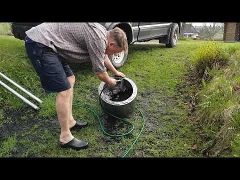

Maintenace is so much easier this time a year. Doing my annual hay change down by the river in only my underpants :smile: Washing the barrel was colder than I like to my legs since the river is still high from mountain melting water. No swimming today :smile:
The Mazda inherited barrel and hay from the Rabbit but there’s still nothing wrong with the hay after a full year in use.
