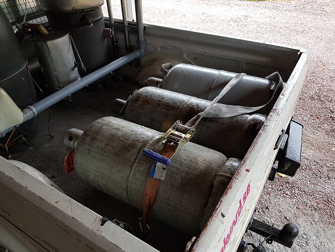

Coming home from a nightshift this morning I shut the Rabbit woodburner down. When I woke up the rain was pouring down. With a cup of coffee by the computer I found an add on the net. Went out and lit up again and look what followed me home this time :smile:
That was the “up” for today.
The “down” was finding the new Mazda MAF in the mailbox and discovering that it´s the wrong kind. This one looks completly different. The plug doesn´t even fit. It has five pins intead of six :frowning_face:
JO, might be a design change in the middle of the production year. Take the VIN number and use it when ordering parts, this helps , sometimes… Is it the original engine? That can mess things up when ordering new parts if they did a engine swap. Great find on the tanks.
