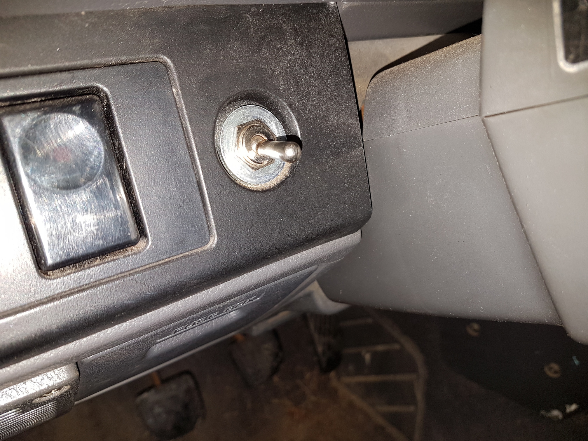

I decided I had to start somewhere, so I managed to install a fuelpump switch.

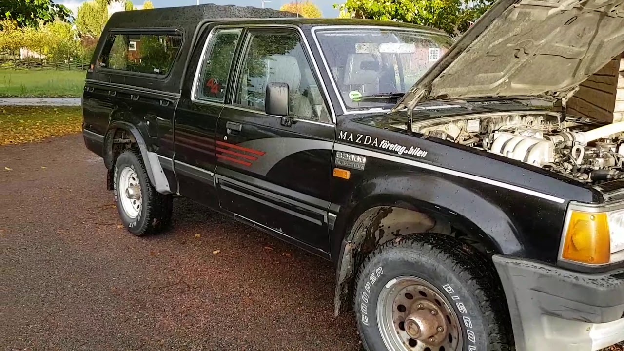

While at it I thought I heard the Mazda whisper she wanted woodgas. The sun showed for a few minutes, so I said: “Ok, I’ll give you a sip!”
JO, are you sure you were not huffing a little woodgas yourself? It seems a little dangerous when you hear truck voices whispering suggestions to you and then you comply.
Ha ha ha, that’s a good one Don.
Haha, yes it´s a serious symptom of the famous addiction
Haha! I can feel woodgas feaver 2000km from you
amazeing sound. Such a nice idle and throtle responce.

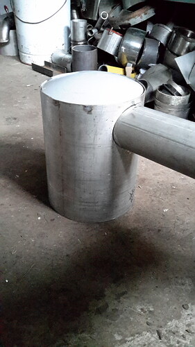

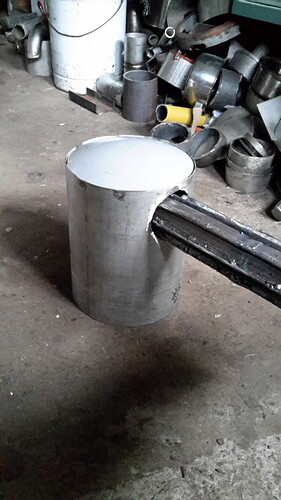

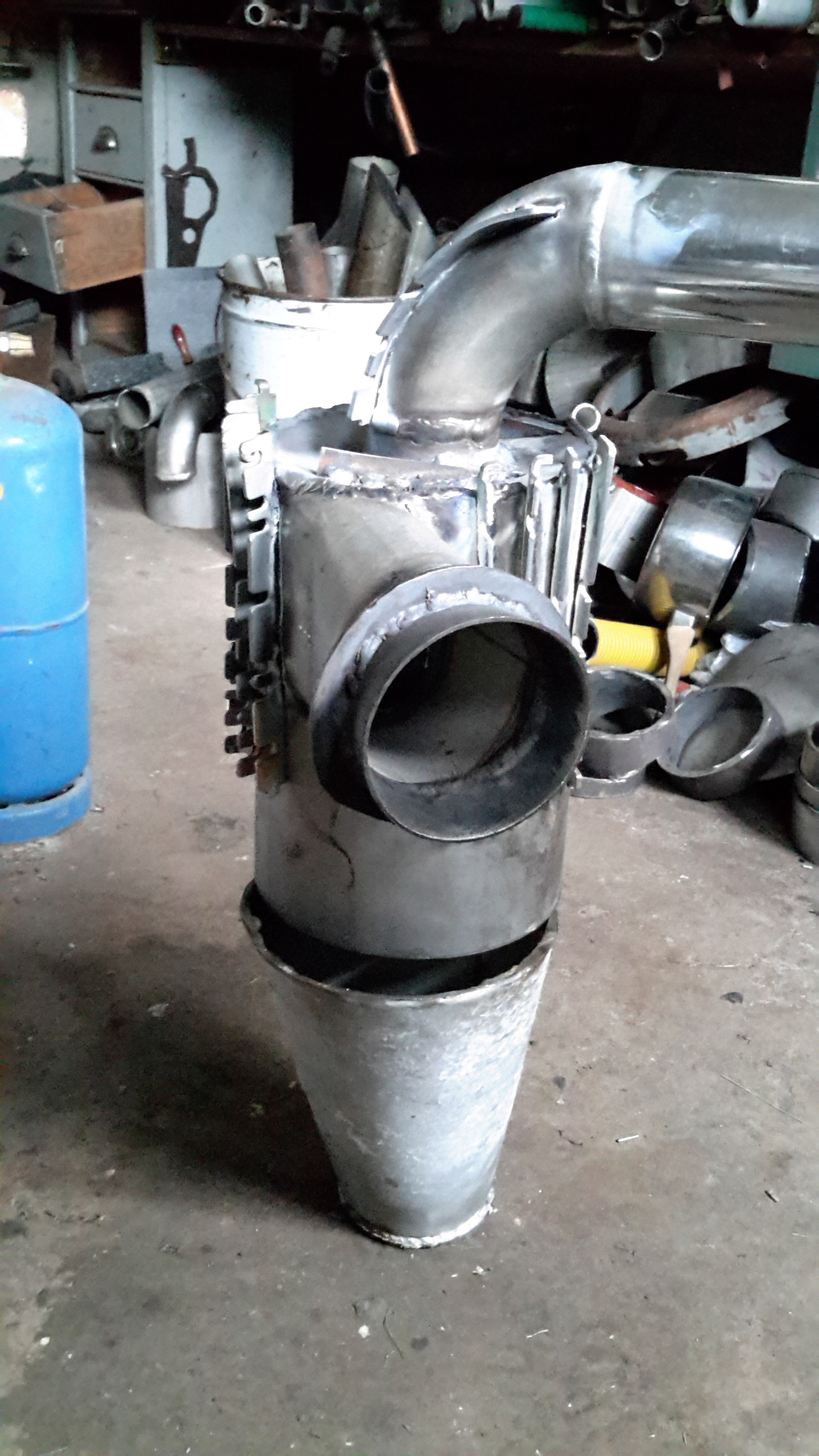

I wasn’t planing to post until the cyclone/heatex was complete but I’ve been awake for half an hour and I know Kristijan expects me to be finished by now ![]()
My Rabbit reduction is ash insulated. Mazda’s reduction will be somewhat more exposed to the gasifier housing and the air preheat mantel. This is why I decided to put some extra effort into the cyclone/heatex pre-preheat.
Pic1: Finned cyclone. A few more cutoffs will be welded on for heat transfer. 3" flatened inlet with compression fitting cone. 2.5" outlet.
Pic2: Preheat air inlet/wg outlet. Finned pipe-in-pipe.
Pic3: Surrounding air mantel which will eventually be insulated.

Very nice work JO, all stainless steel?
You did, l thod you got a new one.
Haha, l know what l mean. I drove with a faulty maf pressure sensoron the chevy for a year, never neaded a new one untill it was back to dyno
Thank you. Well, most is stainless, but some parts will be ordinary mild steel. The gasifier housing for example, will be outof an ordinary propane tank.
