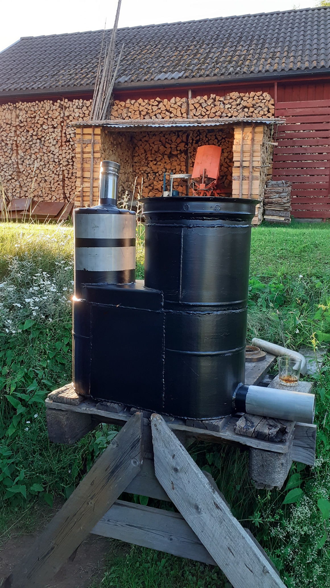

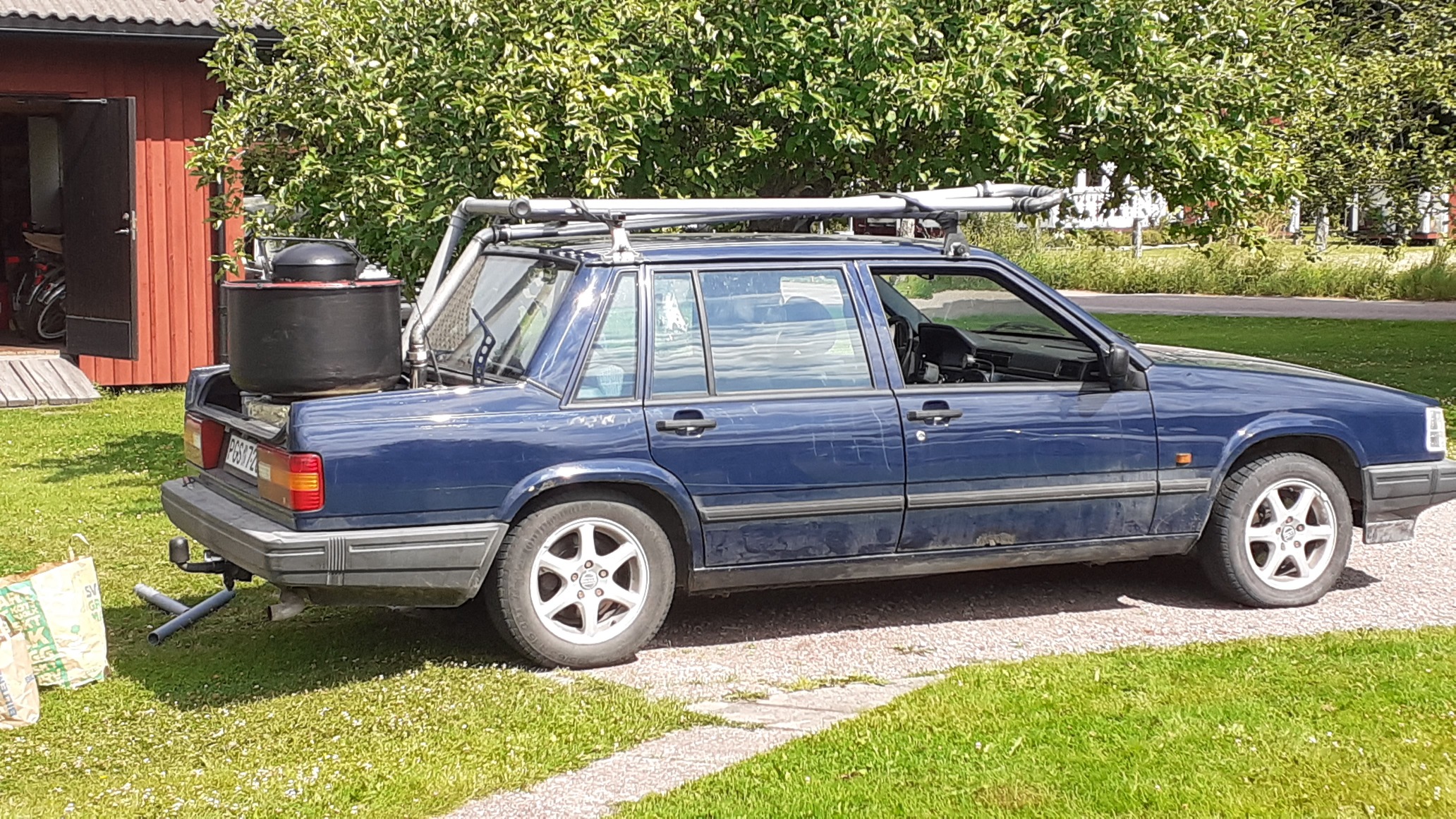

I’ve been keeping this project a secret - only Kristijan knows what’s been going on. I can’t compete with his 24 hour builds, but back in April SteveU started talking about gasifying a car and I thought - maybe, just maybe, I can beat him to it :smile:
This is a 1992 Volvo 740 sedan. 2.3 L, 115 hp, 5-speed, 1430 kg (3,100 pounds).

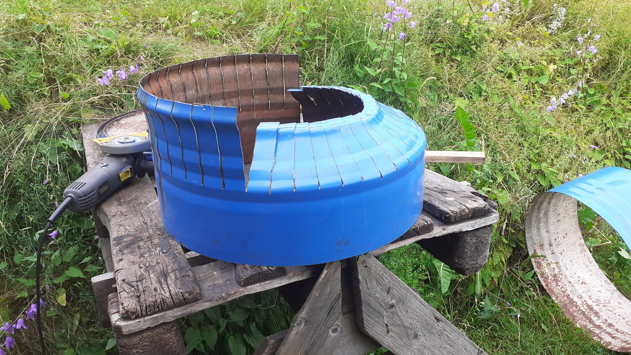

First test ride, day before yesterday, was definately not a succes, but that’s another story. I’ll start with uploading some building pics, starting from early May.

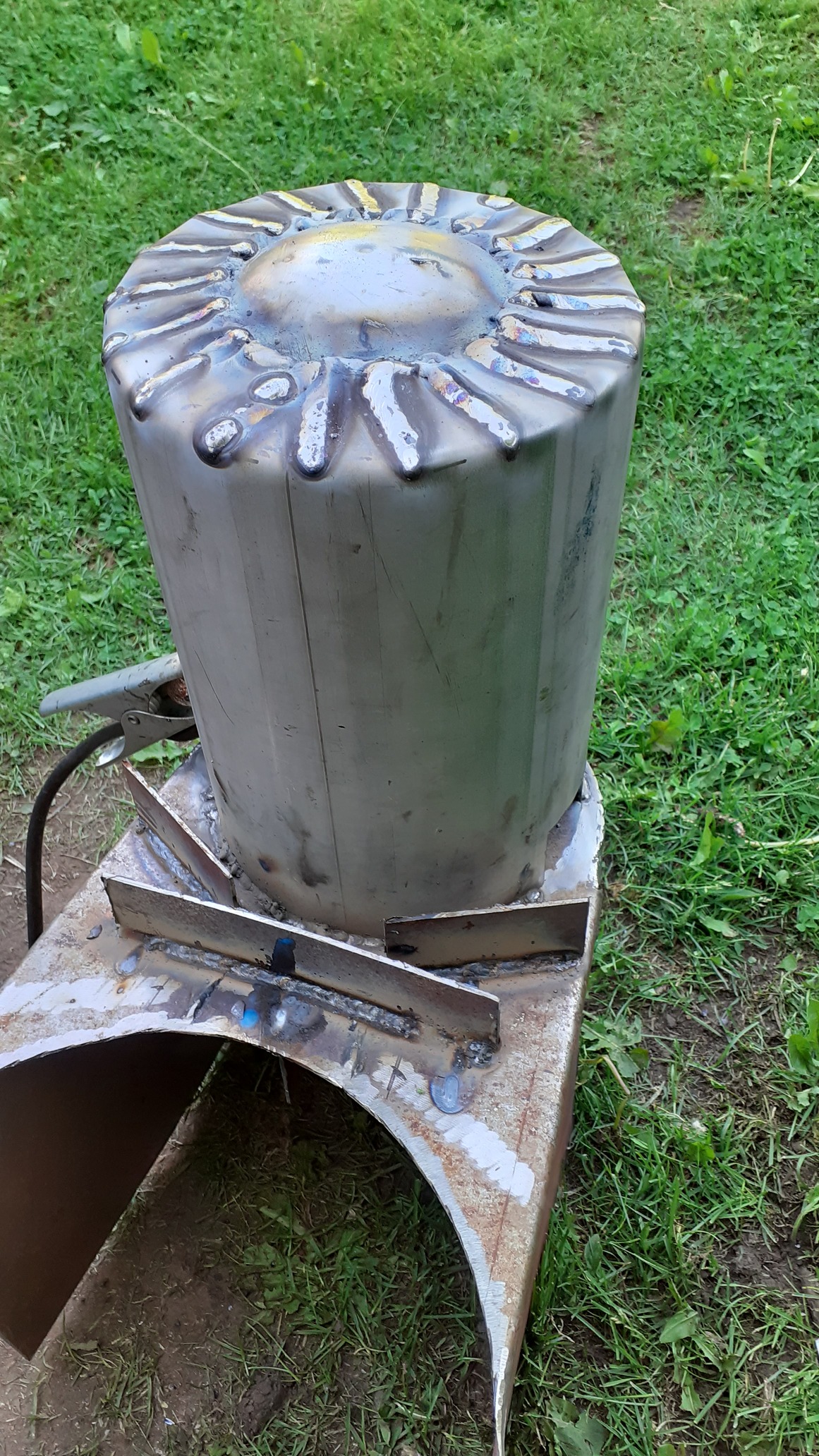

Holy cow that looks great! Car looks really good too.
Oh yes finaly we see the machine!
I havent seen the last picture yet. Yep, this thing looks great with a gasifier! Looking forward to a drive video!

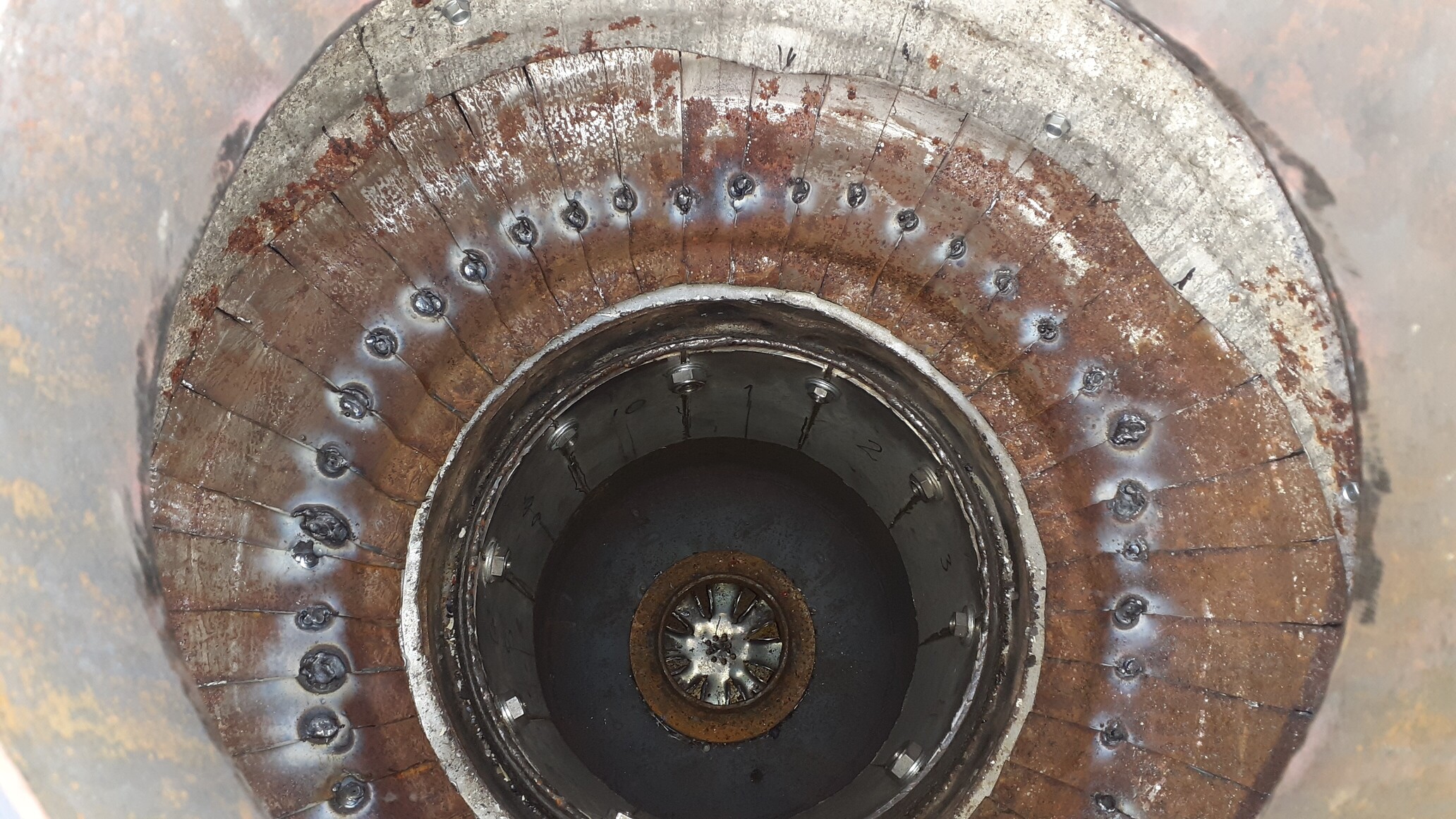

You said in my thread you were happy when your welds don’t fall off but it sure looks to me like you know what your doin! Awesome work!
Also keep in mind JO only uses a old rod welder! Indeed great looking welds
Wow. Even tacking that cut in barrel is a challenge when you use a rod. Great work! Looking good!
Thanks guys.

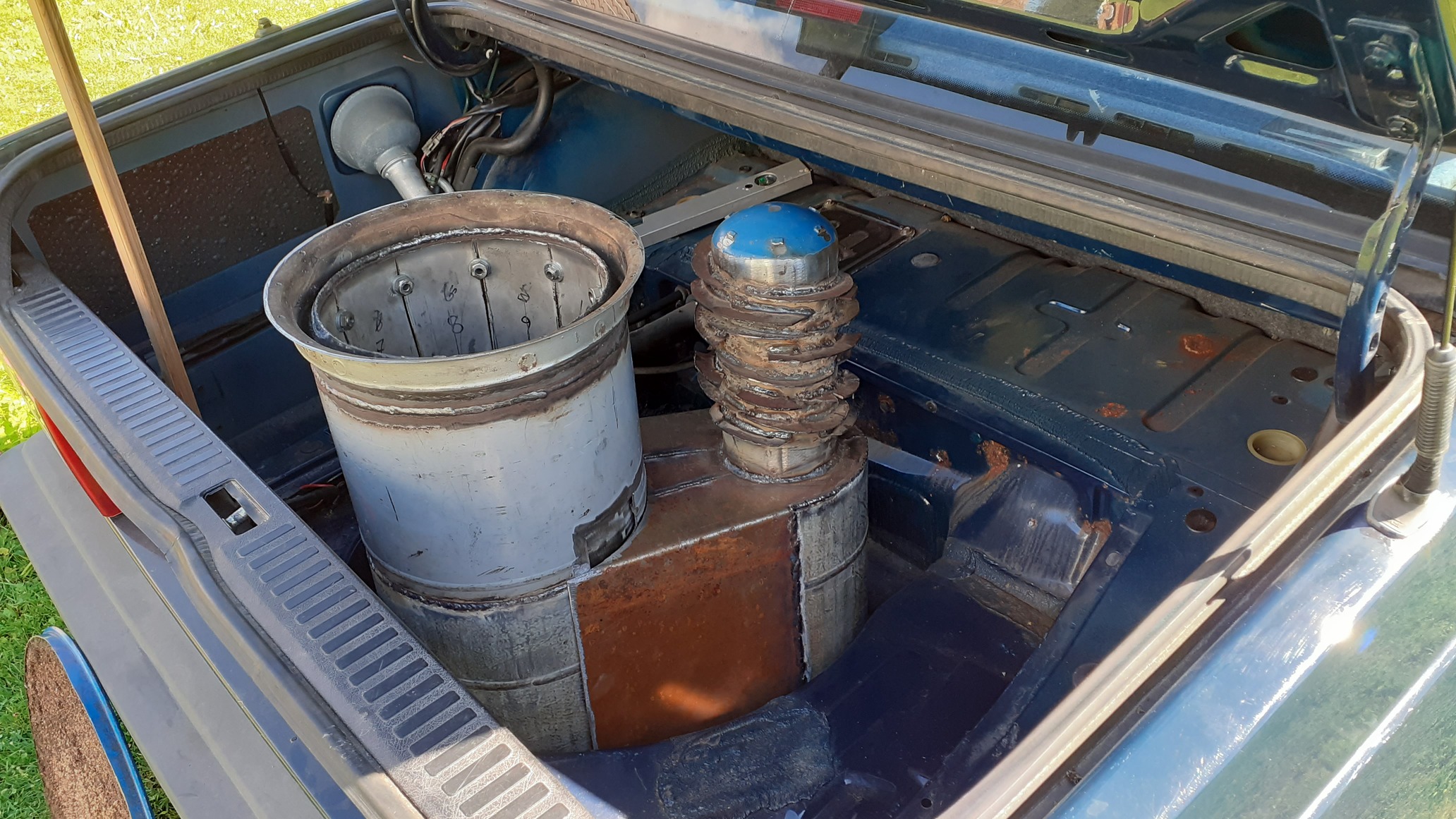

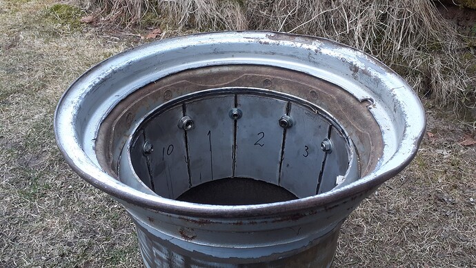

Quite a few WK type construction details in your hearth interior.
And you gone very practical close-coupled gas-out systems. You are going to get lots of questioning on that!
All stick welded? Really?
Now it is you: inspiring me.
Best Regards
Nice build J_O! What welding sticks do you use? (size and type)

Steve and Don - about welding sticks.
I’ve done very little investigation. I use what I have. F-in-law left a dussin packs when he past away. Since he never got good results he kept buying a new type :smile:
For anything ss I use the 2mm 63.30. Very smooth welding even at low temp. The slag popps of nicely when cooling down.
For mild steel I used 48.00. Hard to light up, but once it does it penetrates very well without burning through. OK for the propane tanks.
For very thin mild steel I’ve used the 1.6mm 60.13
Clean and tight surfaces are more important than type of rod.
