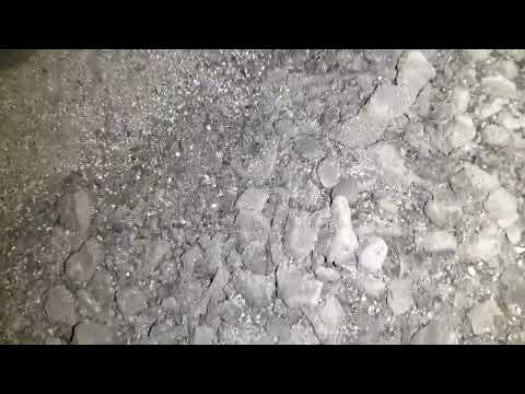

Did some maintence today and put the phone into the cleanout door. Looking for leaks. It’s been running a little hotter lately.
Hard to tell. The light on the phone makes everything look bright white. Around where the grateshaker rod enters through the floor may have a slightly different color - maybe.
Opened up the filter bucket. Black wet soot on the woollen pillow case stuffed with hay, but not much. Poured a can of water over it and let it drain. Looks like most soot drains between rides.
It definitely looks off color at the grate shaker, but not a crazy amount? Looks very good otherwise, neat to see the inside finally
JO, we were celebreting Lans first birthsday yesterday, l am not going to lie. Looking at that video of yours did not make me any favours today. Talking about the round and round cammera angle
I agree I lost in there. I had to go back to your build pictures. At one point I think I was looking at where the gases leave the gasifer and go to the cooling rails? Or do you use a slyclone filter also?
Not sure.
Ha, Bob I had the phone taped to a round stick and had no idea what I was aiming at
No, no cyclone. The huge space around the grate is the dropbox. At 1:10 you’re looking up into the heatexchanger.

JO; Thanks. That was an interesting view of your gasifier. Watched it sevveral times, and plan on a few more. Like I say “interesting”. I don’t know how much ash you took out before you filmed it, but I was thinking that from the picture you are getting some rather large chunks through your great. You drained a liquid out on the ground-- was that from the bottom of your filter or from the trap where the gas comes out of the cooling rails.? TomC
TomC, I’m glad you found it “interesting”
I think the camera lies some. For reference the entire area under the grate is only 12" wide and the grate 6" wide. Very few char bits are larger than marbles. I raked out only a few handfulls close to the door, just to be able to get the phone inside. I like to leave some char/ash for insulation purposeses.
The Volvo system only has one place for black condensate and that’s the tank under the filter bucket. Both rails and hayfilter drain into it.
