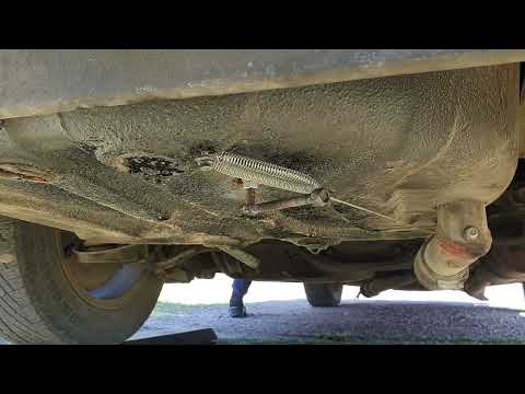

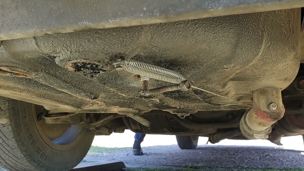

I modified the grate shaker today - from WK-style to JO-style.
Good Job on video work, may be you should do all of JO’s video’s for now on. I like the manual spring loaded shaker JO.
Now that’s a KISS grate shaker! Remote activated full manual control, no motor to fail and parts to break great design! Now how did you seal it up?
Seconded. I’ve thought about using two oil seals to stabilize and add redundancy.
I used a tiny plumbing part, siliconed it and tourqed it in place with a nut on the inside. Prior to that I drilled the inside of the plumbing part to exactly fit the non-threaded part of an 8mm bolt. Also, I stuffed the inside of the plumbing full of copper grease, where the bolt goes through, before I closed it up and tightened it.
I hope this makes sense
The problem with my WK-style straight rod was my gasifier floor didn’t flex enough to allow for the rod to rattle.
Thanks for posting JO .
I like it !!
This is a good design because of the high clearance it has from the ground. I like the movement of the grate. My motor shaker does more vibration then actual movement.
